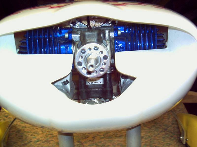

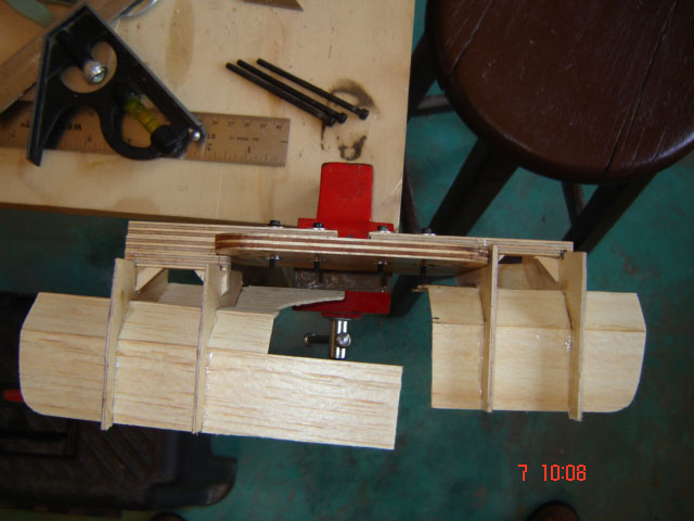

rmh's Avatar
rmh
Posts: 12,630
From: , UT
Default RE: Baffling the BME 110
You have to contain the inlet air - the flow intensity will depend on outlet low pressure setup.
the setup I used here - is held to motor box with four #2 skt head screws -comes off in a minute -but has never unintentionally loosened
If you want to glue stuff into cowl - use clear silicone rubber on cleaned glass surface - make little angles in any plates at their bases to provide good support. epoxy or goo can cause dimpling which will show on outside of cowl.

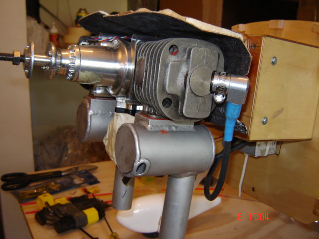

Hi Dick,
That is very much how I did my OS 160FX with an additional horizontal shelf glued to the cowl to direct the air to the center of the cylinder and the port side was blocked and partitioned off. After reading a few articles I found that it is better to have a larger Plenum above the cylinders. I suppose it really doesn't matter that much in our engines and your baffles are better than most people would ever make.

The one piece cowl meant a plate and seals would be required to get the full scale setup - heavier and a Bit-h to do - so I opted for a discrete setup -stopping air flow at upper inlet of cowl --this setup is very light and close enough for folk music.

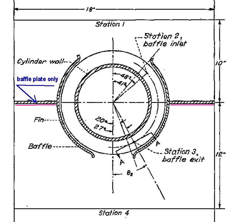

another example, mich like Dick's alu boxing.
from NACA publications:
Station 1 is the high pressure plenum chamber, station 3 is the low pressure exit. A single baffle plate (red line) works surprisingly well, because there is a lot of turbulence in the high pressure area, and the baffle plate creates new turbulence that "scrubs" the cooling fins in the low pressure region.

the system used on the early VW automobile engines is also adaptable
The system Pe shows is a good one -

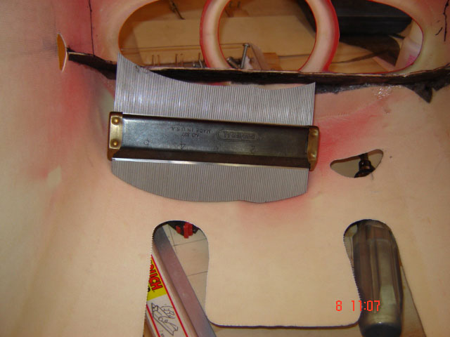

That's the reproduction of some of the ideas exposed above, couple of things:
1) 2 removable halves, joined by "upper bridge".
2) Use balsa sheet reinforced with CF clothing, will use some foam and/rubber to seal any gaps against the cowl.
... needless to say that is a painful and slow process. I am posting the picture of a carpenter's tool that I used during this process. This tool can help those that would like to replicate the inner contour lines of your cowl, very useful.
