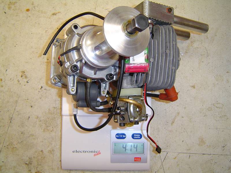

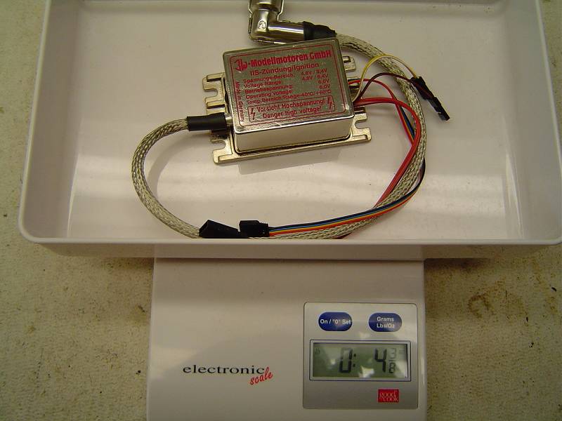

I was wondering what Ralph's engine weight is with the total of engine and ignition and side dump muffler or broken down weights. I know mufflers vary in weight but I'm looking at a ball park figure. I don't want to hang a whole lot of weight on the nose also. I'm also wondering what props they are running and what king of RPM.....
I've had both the D50 and the G62, and the 62 will out pull the DA everytime.......You can hover 20 lb. with the 62 but that's it, very little left for pull out on a 95 degree day.......

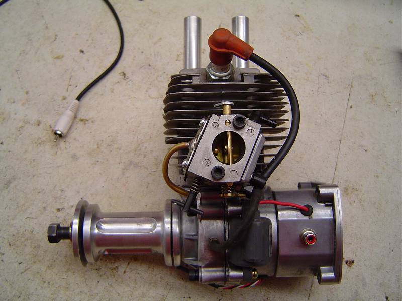

rcbill,
If you didn't see this thread: http://www.rcuniverse.com/forum/m_48...tm.htm#4880892 it's comparing the DA50 with the G62. It's a long read, but some good info in there. Also a couple video's of me hovering a 20 lb. Giant Stinger with G62, and WH Extra at like 18 1/2 lb. with the G62.

ORIGINAL: rcbill
Thanks Frank. I'll watch the video on Tuesday because it takes so long for my computer too download. Could you also tell me what brand prop and size you are running on that G62??
Stock G62 with 3 gallons of gas through it. B&B muffler, Stihl oil @50:1. Broke in with 2 gallons of 32:1. 50 Degrees. Engine not peaked for each prop, just swapped props and took rpm reading........
