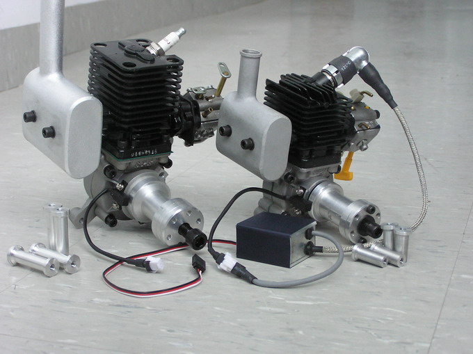

Old 11-20-2006 | 02:26 PM
Joined: Jan 2006
Posts: 319
From: San Antonio, TX
Default RE: SPE 40CC Engine Problem
This is a pick of the engine. The ignition shown is the exact one I received with the motor. Thanks

Old 11-20-2006 | 02:41 PM
jstanton's Avatar
My Feedback: (14)
Joined: Aug 2002
Posts: 3,257
Received 26 Likes on 26 Posts
From: Millington, TN
Gapple,
That is the ignition the Brillelli replaces. You can go to www.brillelli.com and talk to Scott about it or you can also Talk to Adam at www.bcmaengines.com. He also knows of the problem and sales the CH ignition for it.
