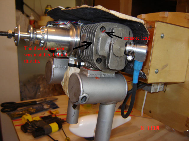

Placing the sensor on the front of the engine gives low temperatures. The prop turbulence forces the cool air deep into the finning. They should be placed at the rear, where the sensor is not cooled by the airflow. That is the main reason for the massive temperature rise after stopping the engine.

After using the Hand held IR thermometer and the thermocouple sensors, another conclusion is that is very hard to say what is exactly the engine temperatures. I think depends, where you are measuring the temperatures, what are you using and when you are measuring them.

That would indeed be the best, and standard solution. With the tie-on thermocouples like the Venom etc, that is not an option.

Regarding the thermocouple position. A pretty accurate reading will be obtained if you move the thermocouple to the back of the cylinder, second fin down from the top. You can use the cylinder screw access holes to clamp the wire in place by running a short hex head screw and bolt into the hole, and using a couple of flat washers as clamps on both side of a fin. This has been done on about a thousand engines that I'm aware of and it works just great.
If you have the ability, attaching at the base of the spark plug is the best, but as noted before, not always possible.
