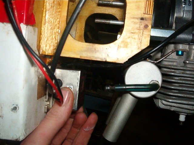

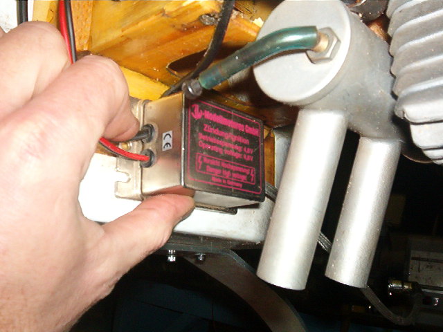

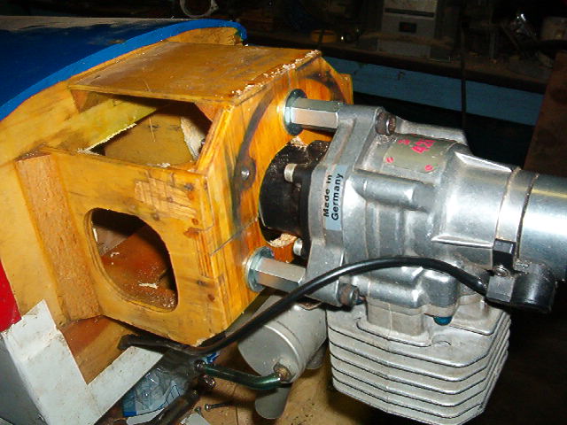

Ok now this mite sound stuped but I got to give it a shot.. I need to add some lb to the nose of the plane.. I got a piece of 3/4 ply and I was thinking of makeing a fire wall out of that.. Then I can take block and put between the 3/4 and the fire wall. the block will only have to be 1/2"
That looks as if that mite just be the lbs I need and It would be ez to put the engine on it.. Now does that sound stuped or what?
Old 02-19-2007 | 11:44 PM
KI8FR's Avatar
Joined: Feb 2004
Posts: 976
From: Ovid, MI
Default RE: hooking up a engine with CDI Ignition
Well I tryed all the ideas that you all gave my + the stuped one that I cam up with.. It is just not working out.. I keep running in to probs.. So what I had to do was cut a part of the fire wall off so that the mufler will fit.. I just used 1" dowl rod for stand offs... That has got to work the best.. Im trying to up load a pic but it is telling me that the pic is to big.. I will try to get it in so you all can tell me if it it is going to work on not..
Paul
Old 02-25-2007 | 08:00 PM
KI8FR's Avatar
Joined: Feb 2004
Posts: 976
From: Ovid, MI
The dowls broke when I did a good snug. so I thought I would try doing it this way. look at the pic and tell me what you think about it...
I trying to find a good place to put my ingiation. I was going to put it under the engine box but it looks like it will to close to the mufler.. what do you all think..
or I can put it on the side of the box but with the carb being in the box will that be a prob..
Thanks for all your info..
Paul

Old 02-25-2007 | 08:38 PM
Posts: 12,957
From: Hesperia Michigan, MI
I vote for photo 5....modual on side of engine box! Capt,n
Old 02-26-2007 | 07:08 AM
Don M.'s Avatar
Joined: Mar 2004
Posts: 1,848
From: Halifax, NS, CANADA
If it was mine I would NOT put it behind the muffler. Your install reminds me why I avoid rear carb engines.
