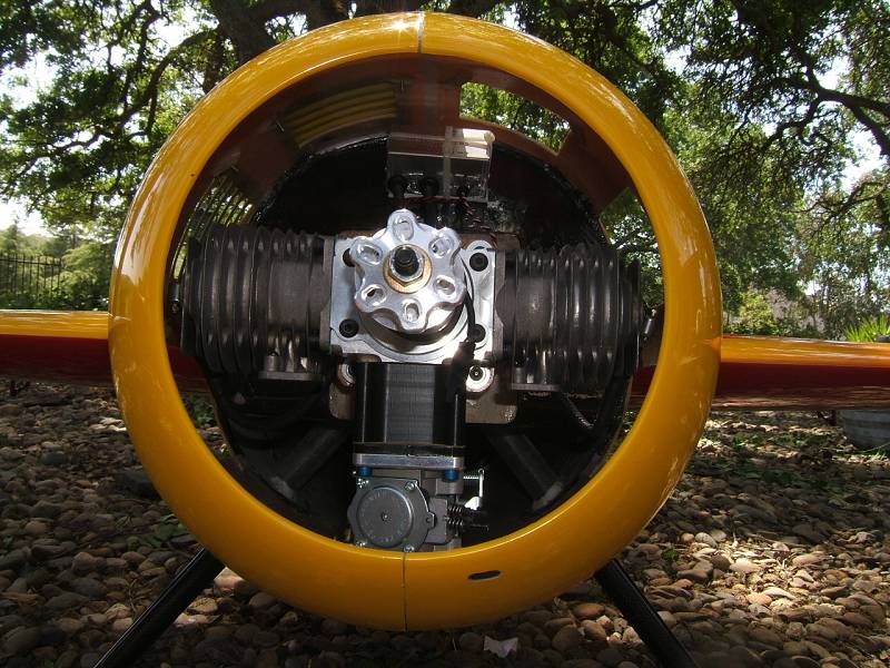

I'd like to get some outside input regarding the cooling vents on my Yak.
The ignition is mounted on the engine box above the engine, placing it in a warmer enviornment than I would normally like. I'm thinking of turning the top two vents around to face into the relative wind and prop blast in order to direct some cooler air over the ignition. I'm thinking it may also assist the hot air to better exhaust out the sides as well.
Anyone agree or have reason to disagree with that concept?

SS, you might end up pushing air out of the inverted vents. This may all depend on the type of baffling you are going to use also. With no baffling it seems that the pressure inside the cowl maybe greater than the ram-air effect from the two inverted vents, especially when the prop unloads in the air. I may be totally wrong here, but it is something to think about.

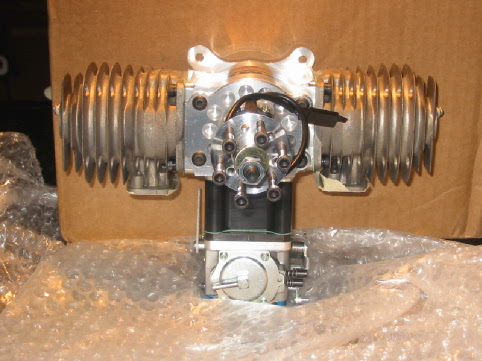

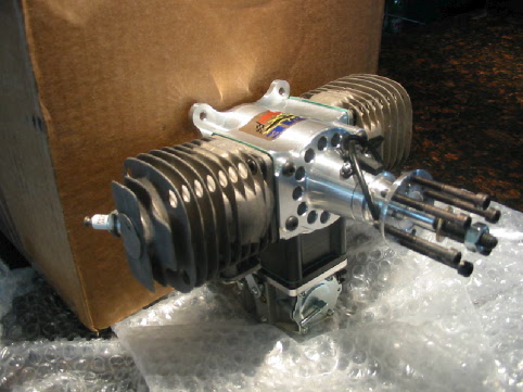

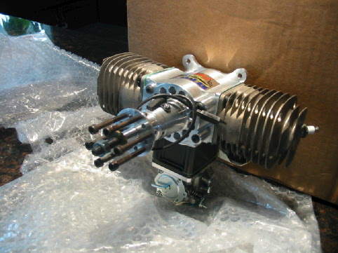

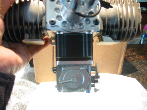

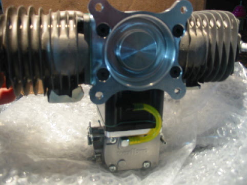

Well, I finally recieved it...Here are some pics, notice the updated carb, with the shorter velocity stack. I also went with the tapped carb plate.

Looks nice, what are you putting it in??

Thanks for the pics Pontiac. The engine looks much better. Keep us informed on the performance please.

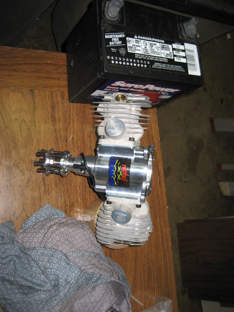

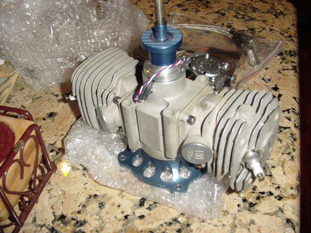

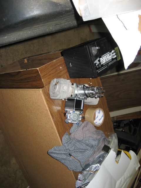

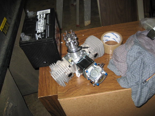

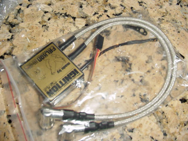

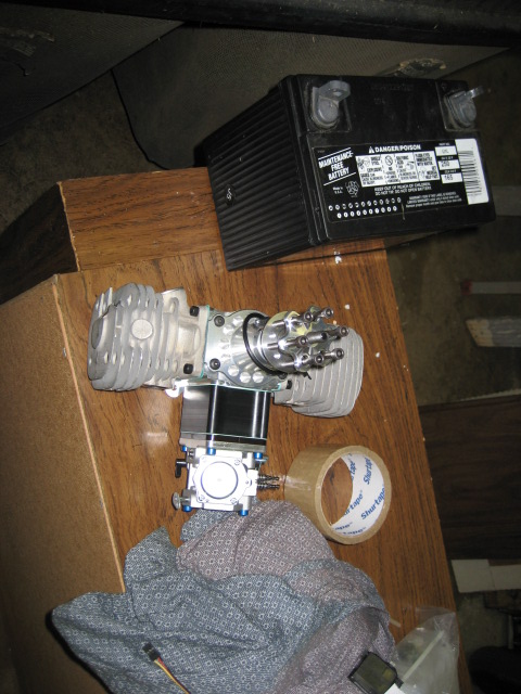

Here is mine that arrive yesterday its a BME-111 its my old 100 that has been converted to this deal. New rings on old piston and old jugs the rest is all new BME-115 parts, last year i had it converted over to falcon ignition. I am in the gargae working on mounting it back in the BG Ultimate. I hope to be ready to do a test in the back yard before the little bit of sun that is out stays with us. Having to move the throttle servo to smoother location over the old deal along with adding about 5/8 to 3/4 more for the motor not having that spacer on it (shorter deal now).

Cool, let us know how it runs.
One of the things that I like about Keith is that he is willing (time permitting) to do custom work for people. No other manufacturer will do that, I have asked all of them.

bummer i am only getting spark from one side of the ignition is this letting me know i have a bad ignition?

More than likely

Silversurfer, it looks to me like that monster cowl and the ram-air effect from the prop and the plane's forward motion will far overcome any air you might get in through those louvers. I would leave them like they are, and they will serve as air exits. After all, it's hard to get too much exit area. That big blast of cool air from the front of the cowl should get back to your ingnition to provide plenty of cooling, and having those exits right above it might even help.
My $.02.

RTK, Steve,
The Motor is going in the Comp arf 2.6 Yak. I will post performance numbers as soon as I can, hopefully they are as good as promised...can't wait.
