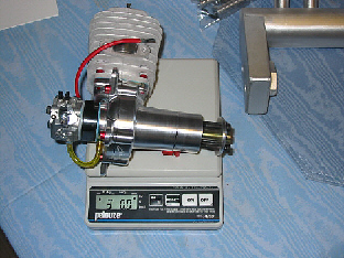

The brown airplane truck stopped by and dropped off my new engine this afternoon. The engine looks great and bare weight is 3lbs 0.0 ozs. Total weight including standoffs, BCM pitts,and ignition less batt pack is 4lbs 1.2 ozs. I will try to run this and can post #'s by Friday.

Wow... The Desert Aircraft 50 DOES exist! Could you weigh all the parts like you did the engine with the corrulating weights and post the pictures for each? That's a pretty cool way to show us all how much each of the parts and pieces really do weigh with the scale actually showing the weight. I wish the distributors would show the weights of the products they sale like you did. You can never believe them until the parts arrive and weigh them yourself.

Hey Dave,
Really love the DA 50R....should be a great power source for numerous planes...
Now about the scale in the picture....
What make/model is it and where might one obtain one?
Bill
Bill

Hey Bill another good scale that is a little larger is an a/c recharging scale from Snap-On Tools, no. ACT120. I have seen this same scale sold by others for less but can't remember where.
Kent

The scale is a Pelouze model PE10. It would be better if it were larger.
