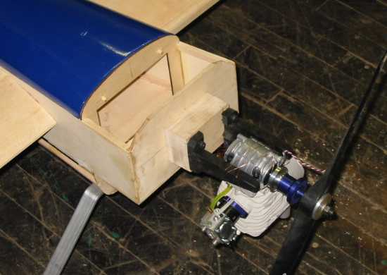

Sure they are! They just started selling them last year.
www.bmeengine.com Never updated....
Heres mine...

Chris,
That looks like an Aeroworks 29% Edge. What was the finished weight with the BME?

Yes, it is an AW 29% Edge. It's not finished yet so I can't tell you a weight. Sorry.

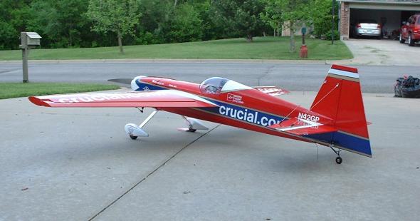

Yup,
Only mine has a Brisson 3.2. About 14lbs dry weight.

14 pounds.....with a brison? Wow thats really good, my friend has the same setup and his came in at 16.5...including the weight needing to balance. He wasn't too happy but it flies great, I flew it yesterday. My 29% will have the BME 50, like Chris'. Will start covering at the end of the week....hopefully flying in a coupla more weeks. Keep us posted Chris.

16 &1/2 lbs!!
I have not heard of one coming out this heavy. Most guys are around 15 to 15 1/4 with the 3.2 built stock. Is he using double receivers and batteries? Why did he add weight? Did he use a lot of epoxy sheeting the wings? There really is only few oz between the BME with mount, muffler, plug ect. & the Brison with muffler/plug ect.
Here are the only things I did to loose weight.
Spinner back plate lightened (see previous pic)
Carbon fiber push rods
Carbon fiber axels
Removed some aluminum from LG
Lightened some of the Ply pieces
Got rid of the wing bolts
Used polyurethane for sheeting (biggest weight savings)
Mini high torque servos for throttle & choke.
1-1000ma batt for ign
1-1700ma batt for rec

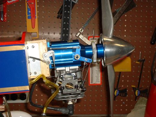

Does anyone have any pictures of the BME 50 with the throttle linkage? I am wondering about the turned carb. Thanks

This is a pic of a 44 linkage. Its a straight shot. No bellcranks....

Looks great. I am putting one on a H9 Edge. Should be awesome.

Hey Chris 540, Thats my Edge that you used for the throttle linkage pic.(the orange one) Its a bme 44, not a 50 but the throttle is the same anyway. Its an airwild Edge 540t that I flew last year. It was 15 lbs with the bme and flew great. I put over 200 flights on it before I sold it. I now use a bme 50 in a pica spitfire. They are great little engines and very powerfull for their size and weight.
