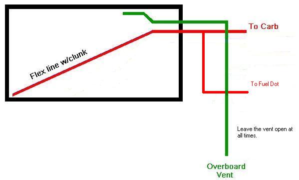

Gasoline Tank Vent Problem
My Feedback: (22)
Posts: 192
From: Dexter,
KS
If you would please, take a look at the attached schematic and tell me why I'm venting fuel overboard during flight. For calibration purposes, here are the essentials:
Plane - 80" WM Extra
Engine - FPE 3.2 gas
Tank - 800cc (27 oz) rectangular, mounted on the CG
Vent exit - through the belly of the fuse, just aft of the main gear

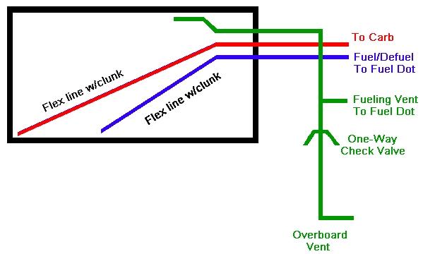

The check valve, tee, and fuel dot in the vent line were not there originally. I noticed the venting problem and added those pieces, assuming it was a "siphoning" problem. This after trying several configurations of vent line, to include turning it 90 degrees, with the tube facing forward as shown in the schematic. The check valve has slowed the rate at which fuel is venting, but it has not stopped it.
This is my first gasser, and at first, I thought it might be "normal". But after talking to some very experienced modelers who have built literally dozens of gas powered planes, I don't think so... they're saying I shouldn't even need the check valve. I can live with this problem, but just don't understand why it happens. There are absolutely no tuning or "flyability" problems with the engine... it starts and runs flawlessly. I am considering the installation of a smaller tank, but I can't imagine that it would have any effect on this problem. (I used the stock WM tank that came with the kit, converted to gas with appropriate tubing and stopper. It was intended to feed a large glow engine and is really about twice as big as I need.)
Your comments and suggestions are very welcome!

Is the vent line routed higher than the tank before it goes down? If not, give that a try. Once the fuel starts leaking out when the fueld is sloshing around in flight, it will continue to siphon out.

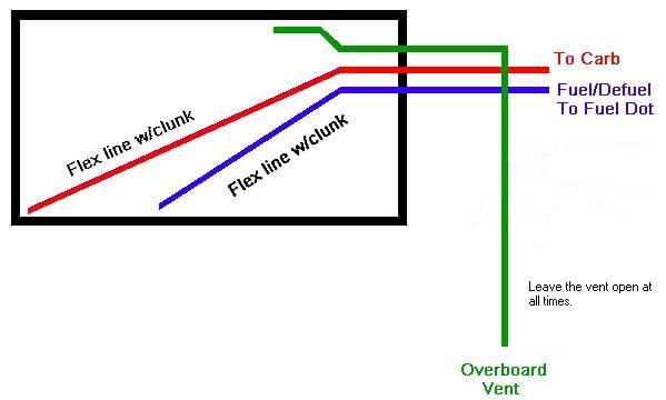

RC-Av8tor, I would use the line set-up that is posted by mecam. Do not use the check valve in the vent line on gas engines. The vent inside the tank should be as close to the top and as far forward as possible. It also helps if the front of the tank is just a little higher than the back in level flight. The Walbro carb on you FPE will not allow gas to pass when the engine is not running so there is no need to pinch the line during fueling. Gas has a much higher evaporative pressure than glow fuel, its the wooosh you here when you open the tank in your car, some liquid venting is normal but it shouldn't be more than about a teaspoon a flight.

The two configurations (posts #2 and #4) have already been tried. The original configuration was the two line setup shown in post #4. I went to the three line when I realized that I was opening the supply line to the engine every time I refueled... I didn't like that idea, because my filter was on the supply clunk. In any case, this decision had nothing to do with the fuel venting problem, but for the record, the two line setup lost fuel out of the vent just like the three line setup shown in post #2.
The check valve was added later, and has helped the overboard venting problem, so I would like to keep it in the system. I can't see that it could hurt, as it allows air into the tank to replace the fuel pumped out by the engine, but at least slows down the venting losses.
I am going to try Flyfalcon's idea (an overhead loop on the vent line), as mine leaves the tank and immediately dives straight down to the overboard vent tube. I am also going to move the vent line check valve closer to the tank, as it is currently just ahead of the overboard vent. This move would (in my mind, at least
) allow a smaller amount of fuel to be "trapped" in the vent line by the check valve. I suspect the valve lets at least a portion of the trapped fuel out, when it eventually opens to let air in the tank. With or without a check valve, I'm envisioning the vent line being filled with fuel for instance, on a long "braking" downline. Then, when the plane goes upright again, the fuel simply falls out of the line. I'm sure there are other "sloshing" manuever combinations that would allow the same thing to happen. BTW this plane is straight and level exactly twice on every flight; for about 5 seconds after takeoff and for about 15 seconds before landing only .
Now... having said all this, if normal loss is a teaspoon per flight, then I didn't really have a problem to start with. (Of course, that's not what "The Big Boys" told me.
) But if that is the case, I'll simply run a longer vent line, maybe along the curvature of the main gear, to simply keep the gasoline from accumulating on the bottom of the fuse.
Anyway, your time and thoughts are certainly appreciated.

Av8tor: Read what the gas Heli boys do. Use the check valve(could add a springloaded one) and wrap the vent line to make a complete circle around tank. Also one guy put a stopper in vent line with just a pinhole for vent. Worth a try. Thanks Captinjohn

captinjohn - I found the heli thread you refer to. Hmmm... very interesting. As you say, might be worth a try, since the only cost would be that of several inches of gas line.

I don't think a check valve is a gas system is a good idea. You would be amazed at the amount of pressure that can build on a 80 degree day when using gasoline, especially if the gas was relatively cool when it was pumped in. I think it not only may change fuel metering at the carb, but should it blow a line or split the tank it could be a disaster.

Outcast - The pressure build up is something I thought about when I installed the check valve, but so far no problems. Of course, I also haven't seen anything above about 60 degrees ambient, either.
On the other hand, based on a conversation in the thread alluded to by captinjohn, use of a check valve on the gas helicopters is apparently not uncommon.
