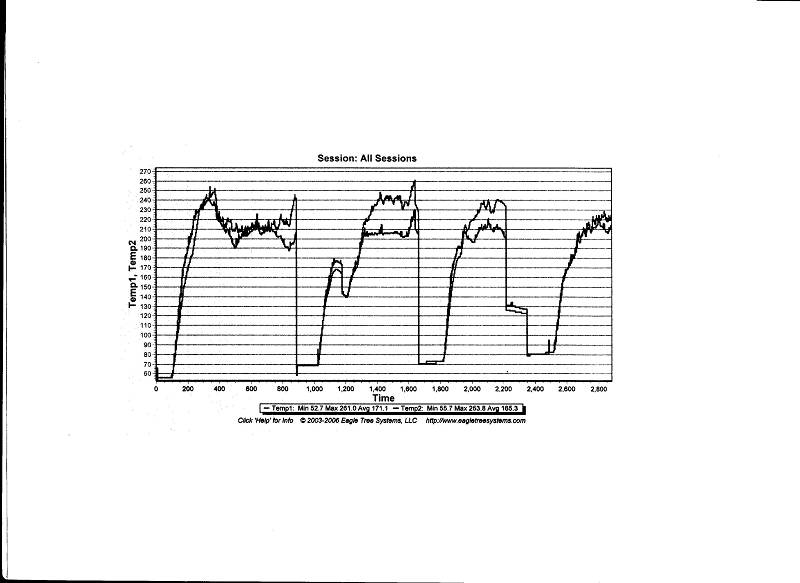

Alright guys..... I have a g23, and would like to know what temperature to shoot for when cowled..... last night I ran it and my thermometer read 270 F @ the spark plug..... am I too lean???around 230-240F right after turning it off and the crank was cold enough to hold my hand on it, the the heat irradiated and the crank got to 130F..... I was running a 16x6-10 and an Abell lite exh diverter....

Your making it too hard.
Mix up your oil and fuel. Don't use some rediculously lean ratio like 100:1. Mix it up at 40:1 or 50:1.
Tune it and Fly it.
Checking your head temps while it's sitting on the ground running under a heavy static load is NOT going to give an accurate reading. Thats completely different than the temps when it's moving through the air.
If it ain't broke--don't fix it. Put oil in the fuel and fly it. There's been a zillion G23 engines run long before you and I were flying model airplanes. Not too many of those guys had infrared temp guns. They just went flying.

Here is an inflight plot of my BME 100 (four flights). 230 degrees is about what it shows most of the time on both cylinders.Not that whwn it was on the ground prior to the first flight was the highest recorded temp
Recorded and plotted with the Eagletree system.

Now that's the CORRECT way of measuring engine temps. In flight and logged.

triangle- Don't worry about that temp, it is not excessive. Put it in the air and fly it as Rcpilot has mentioned.
