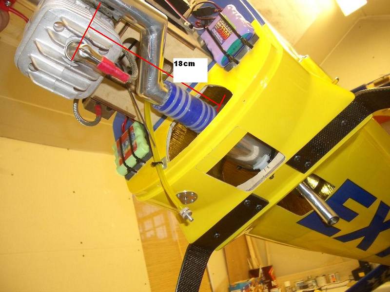

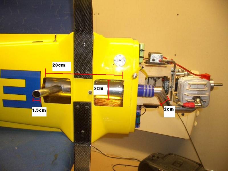

Hi all,

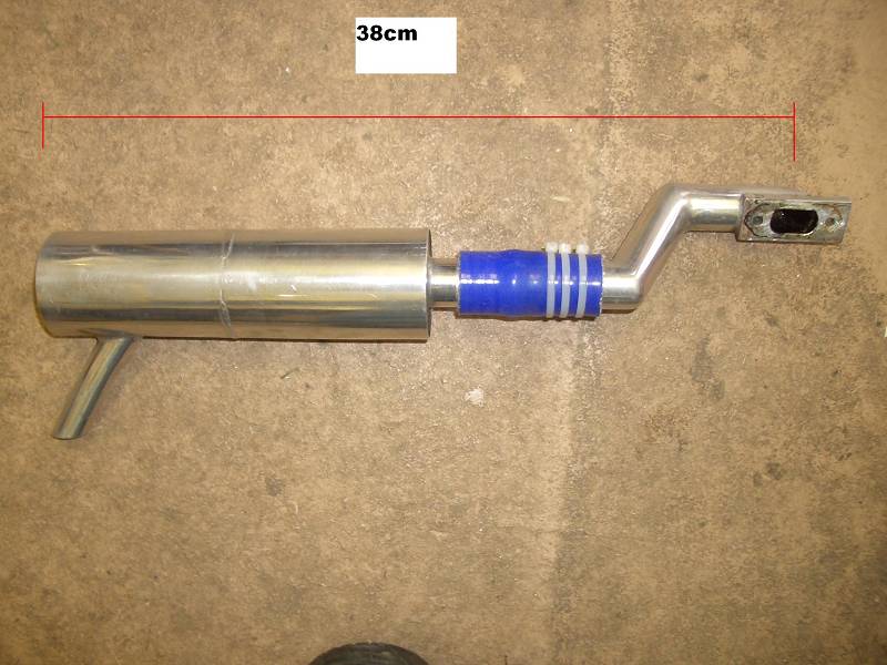

I have a DA 50 in a 80" span CM PRO Extra 330. I had a canister type silencer made for it as our field is a bit noise sensitive.
Is the silencer restricting the power?
It has a Just Engines wooden prop 20x10 and run at @6200rpm, still being run in though, 32:1 on HR1 Bel ray oil. I think it may well be a little rich to protect it. There is very little amount of oil residue down the bottom of the fuz, an indication to me with my limited experience that it's running not too rich. Enough to wipe off with a hand wipe.
As far as elevation goes, it's 400ft absl and usually about 20'C.
Have a look at my exhaust and see if you think it's restricting the power at all. I think it might because it's very quiet, quieter that than some small .60 sized engines. These inlet and exhaust pipe measurements are ID, not OD.
The exhaust has one baffle mid way, it's a disk with holes drilled in it, don't know what size the holes are though.
ID:	668090   Click image for larger version
Yes the silencer creates this problem, it has nothing to do with the amount of oil.

from the picture your muffler setup is quite restrictive -- here is one I did for a ZDZ50 which is more in line with size required
the can is an all steel, one pint (16 ounce volume) container. It may not be pretty but should be much better at breathing than the device you are using.

Without changing the whole system what would you say would help? Is it the volume and the exhaust exit size?

Considering that you're using a prop that's 2" too small for the engine your rpm level is pitiful. I would be expecting something in the 7,600 area. A 22-8 should be turning up around 7,100-7,200. Get rid of the exhaust system, change the oil mixture to 50-1, and set the needles correctly. You're killing that engine very early in it's life.

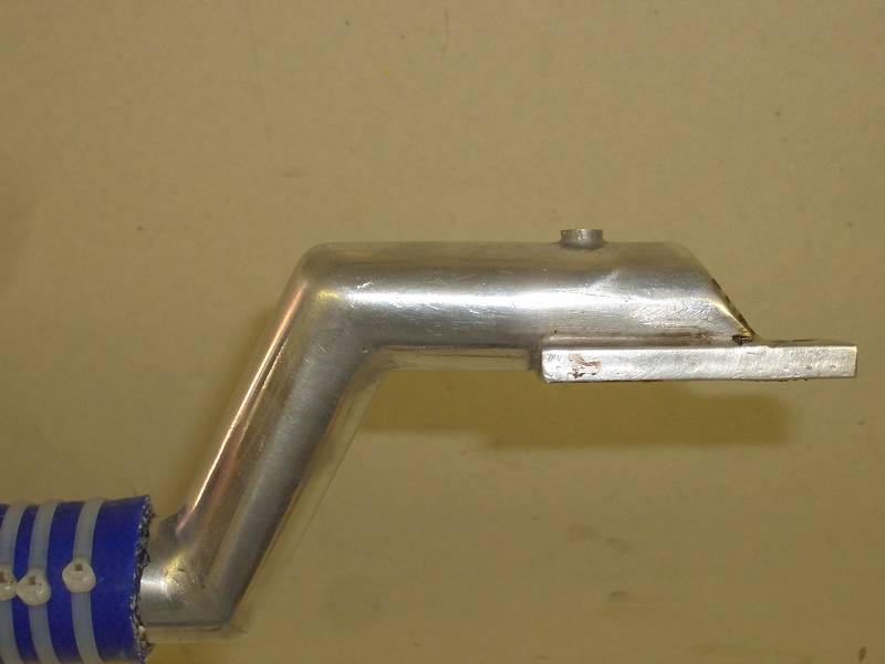

One difference between Dicks and yours is the way the bends are formed...his are nice and smooth, gas likes to flow.
you could mabe get a larger pipe to replace the small one on yours or try cutting it down a little...its all things combined that will get you.

actually- the volume of my setup is considerably more.
The initial expansion makes a huge difference in power
as for oil to fuel - my 32-1 setups make most power -for me
My 50's (ZDZ) like large systems and tuned systems .
good systems run 7500-7700 rpm on 22x8 Mejzlic
the DA will do about the same.
Most in cowl mufflers KILL power
The header in the pic of the DA is way to close on initial bend at exhaust flange but the other sharp bends really don't do much harm For decent flow the first bend should not be nearly so sharp see pic attached

Where did you get that manifold/header from? It looks nice. I've had a look at BMB, MTW, Krumscheid systems, there doesn't ssem to be a nice curved pipe like Dick's. Is the length of the header critical like small 2 stroke engines with tuned pipes? The total length is a problem, the wing tube is in the way. The total distance from the engine exhaust port to the tube is 400mm.

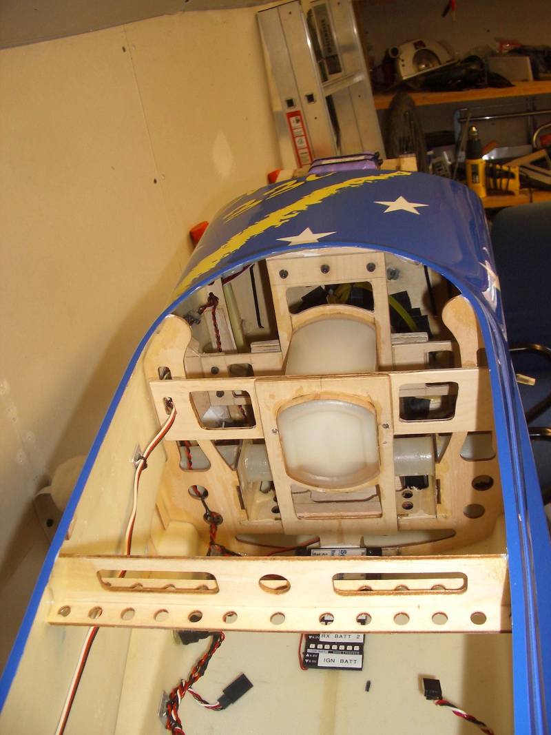

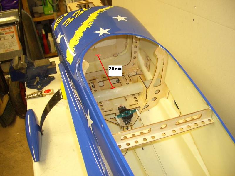

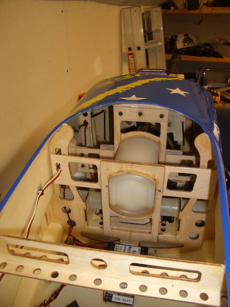

Here's a photo before I cut anything, Ive moved the rudder servo closer to the tail. There's a shroud around the exhaust and the fuel tank is above it.

Yep, that exhaust is killing your power. My Da, on a stock in-cowl muff, turned a PT 22X8 at 7200 within the first 2 minutes of running...

Just to let you know that I've changed my exhaust system, I've kept the silencer, gutted it, ie, took the baffle out and the other crap, got a KS manifold like the ones in the photo's I received, well had to silver solder it up but the bends are so nice and smooth.....
Well.... huge difference!!! The silencer was a 600rpm increase and the manifold was a 700rpm increase!!! Now I'm seeing 7600/7700... Wow!!! Huge difference.... I have six pounds more thrust!! Only thing now is that it's noisy... well noisy tips, I'm running a wooden 22x8... crap I know... Not sure now if I should get carbon 20x10 or a 23x8 prop???
