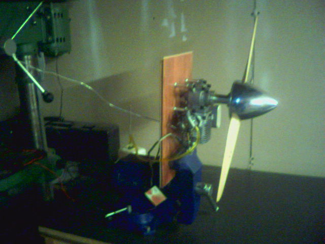

I just got a new spe 40 and I want to put it in a 1/4 scale extra 300. If anyone has used this engine could tell me if it would be a good choice for this plane that would be great. This is my first gas engine for a rc plane and I cant wait. I also want to get bigger servo arms for 3010 futaba servos but am not sure what would work best?

Put it in a test stand first. Check for engine vibrations. Take the prop hub apart and spin the parts and see if it's strait. It wont be. See if any of the prop bolt holes match up to each other. They wont. There are people who re-work this engine with a better prop hub and rebalance them if you stay with it.

Thanks for the reply I fired it up tonight and ran it for a bit. This engine ran at an idle and I havent even tuned the carb I ran the rpm up and down a few times and it is running great. I know I will need to lean the top end a bit cause full throttle it loads up a bit. I have a 20x8 and nexed time I run it I will take a rpm test. About vibration it shakes a bit a little above idle and a little on idle, but im not sure if I should stress that? I put a picture of it on here so you can see what we have running. So you think this motor will pull my 1/4 scale?

Yep I agree that flying a new motor is the best way to break it in. I always just fire them up on a stand just to make sure everything is right befor I put it in the plane. So when you fire the engine up do you use a starter or do you just flip the prop? Right now I am running a mix if 32-1 in my fule tank with super-M low smoke oil. I have ran this oil for years in my bikes and never had a problem with it.

Upon starting up the engine and a few full throttles, before the maiden, one of the two 4mm dia. bolt holding the propeller snapped, and the propeller came loosen. The Master Airscrew 18" x 10" could be too heavy for this set up, so I changed to its stock prop which was a wooden 18" x 6". This wooden prop seemed to be a bit under pitch, as the plane could not fly fast even with full throttle.

I took off my prop hub cause my prop came loose and figured out that the bolt holes are out of spec. Where could I get a prop hub cause this you cant fix?

p.s. That wannbe test stand scares the heck out of me... that's just looking for trouble in my book.

(Im not scared) Any way cant you just buy a prop hub that will bolt on the crank? I wonder if Scott will have one since he works on them.
