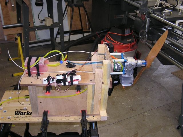

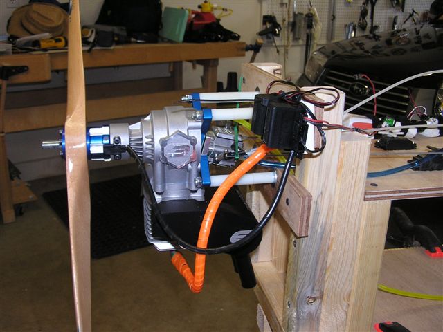

Mounted a new Evolution 58 in toy airplane, and it would not start. Removed engine from the toy and mounted it in a test stand so that I could observe operations (or lack thereof). With choke on, gas moves to the carb until it overflows (no bubbles in fuel line) and splatters onto the test stand and drips onto the floor (fuel appears to be coming out of the choke opening). Gas never gets to the engine. Reset needle valves to suggested initial position and got same result. Plug is completely dry, and I observe no fuel moving through the short line between carb and engine.

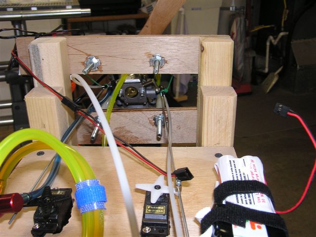

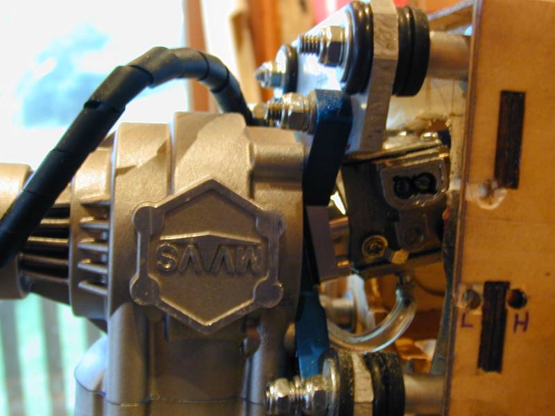

Based upon the pictures, can you tell me if I have the fuel lines installed corectly? I have tank line connected to the black plastic nipple. I have short line connected from the "cast" carb plate and the engine. I have a long line connected to the remaining nipple and "open space".

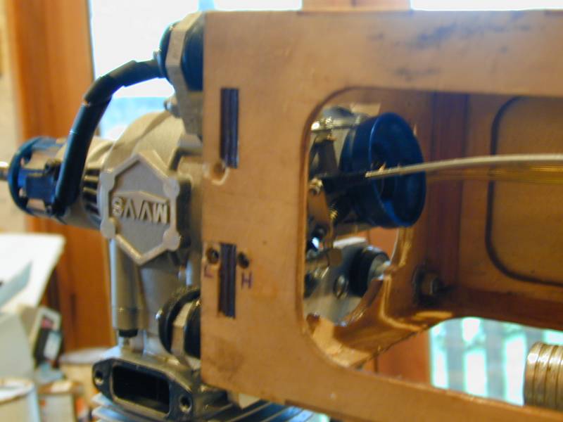

During my search on this subject, I read a thread in the MVVS forum about a MVVS 58 with inverted carb. Is my carb inverted? Since flights routinely includes inverted flight, can a carb ever be inverted?
Thanks for your assistance, Glover
PS I am completely new to engine powered toys. I fly sailplanes and electric toys, and I really want to fly this Evolution 58 powered toy. Maybe this experience is why I enter this hobby by flying slope toys.
please check:
line from tank goes to side of the carb
line from engine crankcase goes to cast cover
No line needed on sheet metal cover
Is there a spark? Spark gap must be 0.5 - 0.7mm ( ~0.025" )
Type -S ignition needs more than 6.4V to operate (2S LiPo or 6 cells NiMH)
Type -P ignition needs 3S LiPo
As a quick check, first mount your engine upright. When you get it running ok, it also should run well inverted.
Starting is quicker with carb manifold sloping down because gas gets to the engine easier. In flight it does not matter any more.

Taking off the rear engine cover and revolving it by 180deg solved my flooding problem, you will see from the pics my carb slopes upwards from the engine, the rear engine cover is O ring sealed to the crankcase, therefore only pull the cover off do not force or turn it or you may tear the O rings. Other than that Pé will be able to advise you better than me.

Pe: Except for the "sheet metal cover" line, my plumbing is as you describe. (I'll certainly remove that line as it's other end is not connected to anything.) When the ignition is switched on, I hear the "initial spark" from the ignition. The problem remains that the first whiff of gas has not gotten to the spark plug to react to an ignition spark. (Ignition voltage is the correct 2S LiPo, and the battery is fully charged.)
So, I'll call Horizon Hobby support in the morning and then decide if I should send the engine back to them for repair, or take it to the local chain saw repair shop. Were I to take the carb apart for inspection, I have no confidence that I would recognize the problem (or solution to that problem).

first mount the engine upright, so the fuel you draw with the choke will enter the engine. Now you pull fuel, and it just drips back the downslope without entering the engine.

I rotated the engine to an attitude with the cylinder pointed up. Now, fuel does not spew from the choke opening. (There is just a light mist of fuel at the choke opening.) One small "bubble" of fuel has finally entered the small tube between the carb and the engine. Spark plug is still bone dry. My old rotator cuff surgery is screaming following countless flips of the prop.
It is amazing what $600 US dollars can buy! Now I ask myself, should I have just purchased another composite slope racer instead? It is really beautiful at Cape Blanco Oregon this time of year, and the wind is blowing a steady 30MPH from the north. Silly me! But what is a fellow to do with my winter build project of an OMP Hybrid Edge 540 with an engine that will not fire? I must see this through to the bitter end. A happy thought is that when I place my classified ad for this engine, I'll be able to state: "Engine is new and has been never run."

If the engine still is bone dry, the carb is clearly not admitting any fuel. I still am puzzled why the test stand gets wet though.
Since you are new to gas engines, this is not a remote help case.
Get someone more experienced to look at your carb (probably a sticking fuel needle). To unstick the fuel needle, reconnect the line to the sheet metal cover and blow pressure in it while you have the choke closed and flip the prop. This should unstick the needle and prepare the new carb for operation.
Look in this forum and search for "carb not pumping fuel" and like posts. It is a common problem with Walbro carbs, to the extent that the carb needs replacing.
