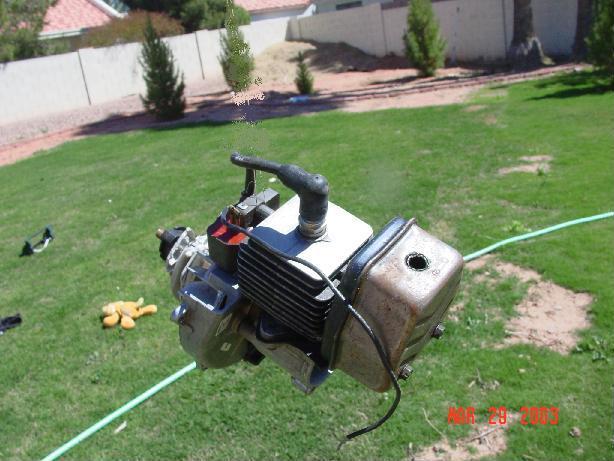

Old 03-29-2003 | 07:22 PM
Joined: Feb 2003
Posts: 191
From: Gilbert, AZ
Default What would it take to hover a Ryobi?
Here is a hovering ryobi for ya. <G> I am wondering how others went about removing that darn clutch. Hope you liked the picture -Dan

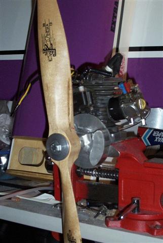

Old 03-29-2003 | 11:30 PM
Joined: Dec 2002
Posts: 126
From: Seffner, FL
Default Need more than that
Youll need more than 1:1 to hover.... One to One will only hold the plane in one spot meaning you cant pull out.
I was thing about a small 21cc or 23cc in my Goldberg Ultimate???? What do ya think? Sounds like a bit of fun to me! I had a Saito 150 in it.
:devious:
Old 03-30-2003 | 12:04 AM
My Feedback: (12)
Posts: 1,188
From: St. Martinville, LA
I had a Ryan's Rebel with a Ryobi on it once. It had unlimited vertical and would hover at about 95% throttle. It would hover but not in the manner that you are asking. With a little work I think you could get a Rya'ns Rebel at 10 lbs w/ a Ryobi.
Ryan
