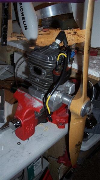

I have gotten sucked into playing around with these little engines. A whole lot cheaper than muscle cars or race bikes.
I got a few more pics I can post. I polished the head and everything I could get to with the dremel and some good old Mothers Aluminum Polish. I still have to cut the rear shaft and make my test stand out of a cutting board. I should be able to test run her tommorow or the next day. Im hoping one of the guys at the field has their tach with them.

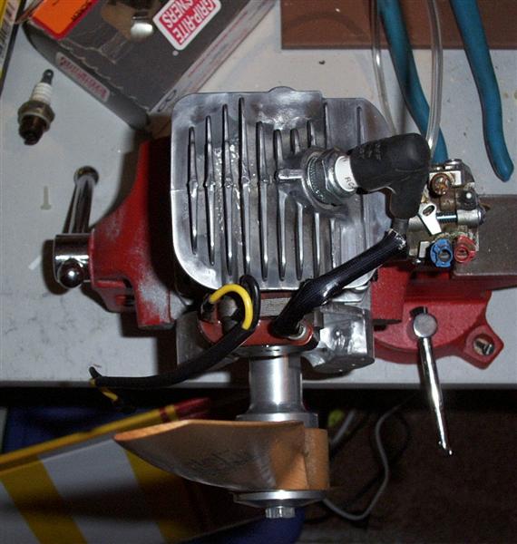

anotherpic

I am contemplating trimming some fins on the jug too but I know once I get started I wont be finished with it for days. I usually start with a high speed cutter and then move to the course drum and then the fine sanding drum. I use the abrasive buff(the one that looks like a hair donut) then use the felt with some mothers and it will come out like chrome. Can you believe I did a whole volkwagon engine like that!!!!:spinnyeye

I have seen a few motorcycle engines with the head fins drilled with many small holes. If done in a pattern it really looks neat. Also a shot blasted finish painted flat black with the ends of the fins polished to a silver look or painted red looks neat. Custom RC engines....a new..... enterprize??? Captin- over & out!! P.S. Helicool, your engine really looks good.

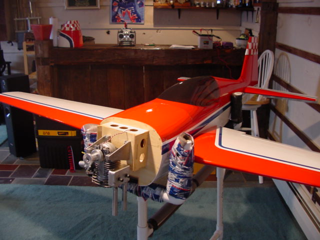

my 46cc poulan, CH electronic ignition with timing advance on a 78" extra 300
