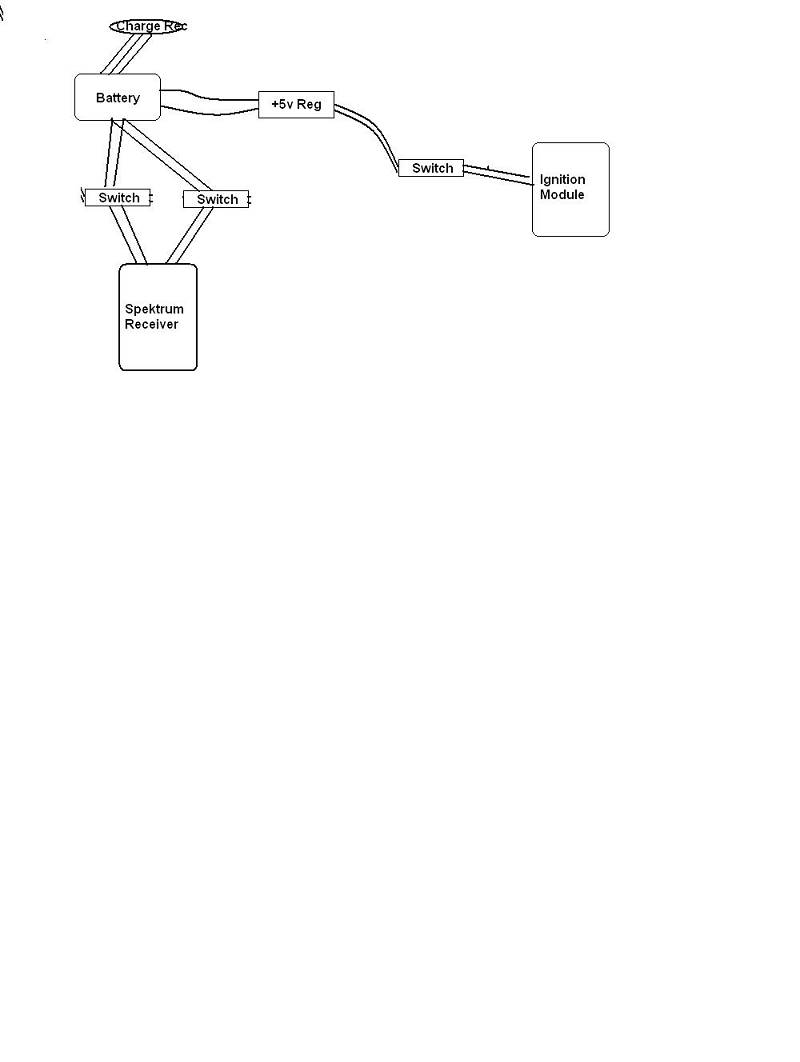

I've ordered a 5v regulator to install with my A123 2S on-board battery to permit me to eliminate the ignition 4 cell pack. I know I need to carefully check range, etc.
I'm also using Spektrum 2.4, so anticipating no radio issues and plan to use existing ignition switch, cutoff, etc. just as is, just replacing the battery with the output lead of the regulator.
Anyone done this? Comments? Things to check?
(Ignitions that will be tested are the DL 50, and the CH on Brillelli engines)

Default RE: Ignitions on A123 Cells??
May be fine
The reason I won't use a reg is that as well as limiting voltage - the instant current draw is limited
The closer the batt voltage is to the reg setting (output voltage) the less this will hapen
personally ---on a single cyl engine a 4.8 v - setup - I see nothing which beats a 4.8 v 1400/1500ma Intellect pack - which is tiny and weighs about 3+ounces.

Question.
Are you using just one A123 pack for both the receiver and the ignition?

That's the intent.
One 2S, 2300mah, A123 pack.
Pic attached is concept drawing.
IF--- there is no problem with "crap" coming from the ignition to/thru the batt -to the rx - it should be fine .
Howsomenever - I am a bit spooked of any setup to the ignition which does not allow it to suck a quick deep shot of power.
It won't show on a meter - but a good scope setup will show it
The problem is in a ignition transistor not fully saturating - which means heat which means a shorter life for the transistor.
Both 3W and Jeri Vlach have issued warnings or recommendations on NOT using regs to ignitions and/or not using cells with high impedance -
I asked a knowledgeble model engine ignition designer and he 'splained it to me.
, step by step
maybe I am just an old worry wart
I would not use a regulator anywhere. The receiver front end has its own regulator built in. You might want to put a good rf filter between the ignition box and the battery or receiver.
Let me know how you make out.
The intent of the regulator is to get the voltage down within spec (voltage and current) for the ignition module. The receivers are working just dandy on the straight A123 juice.
Flew 7 flights today.... these were gentle "pattern-like" flights for the most part, and only used 395ma. Not bad. Not bad at all.
So would the regulator filter out any potential "crap" coming from the Ign? I don't know if I would be confident enough to use it on a PCM setup.
I've been running that Smart-fly "Ignition Regulator" on my DA and so far I haven't noticed any problems.
I see from your drawing my understanding of Dick's recommendation was correct.
Finished phase one ground tests (limited range use, but engine running, all settings) with the A123 feeding a MPI 5.4v, 10A regulator.
All worked fine.
As expected, total milliamp draw from the A123 was as much as anticipated, indicating the reported current draw of the RC-EXL ignition is about as stated.
There were no issues, nothing to report, really. Solid, reliable performance and nothing visible in radio-land because of it.
Way too hot/windy for me to do more, so I just continued breaking the engine in.
Phase two will be at the field, ground tests, bind button depressed to find engine on/off limits to range, all attitudes of airplane. If all's well there, then there is only the airborne test remaining.
