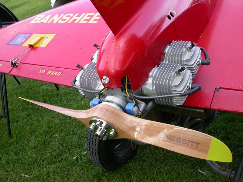

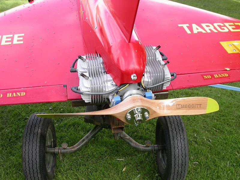

There are very high pitch propellers used in the old military target RC planes. Check on Google with
maker/brand name MMeggitt, it is used on Banshee for very big engine. By the way, how can I upload
picture here - advice please, I am not getting it posted by some reason I do not know.[img][/img]
Old 08-18-2007 | 02:18 AM
Posts: 768
From: Tampere, FINLAND
Default RE: Speed Prop for 50cc
Well, the image came here finally. you can see the pithc is even 40(!) written on the top of the propeller head.

Couple more images:
ID:	744306   Click image for larger version
