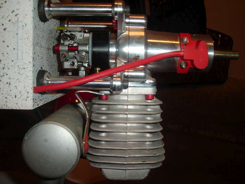

Hello all-
Please pardon the very newbie question. I am coming over from Nitro engines into my first gas engine, a DA-50-R.
It's used, but I've flown the plane with this engine and it pops in about 8 spins choked and then turns over in 3-4 after that and always turns over on the first good flip after that for the day. I believe the engine is in good shape overall.
Now that I have the plane home (Airwild Extra 260) I am setting it up with my radio and I just don't understand how to know when the carb is open and when it is closed. The DA-50 manual I downloaded doesn't have any information about the carb.
Before I try and set this up on my radio properly, I really wanted to get the throttle basically working so closed was closed or mostly closed and open was open so I don't flood the engine trying to start it for the first time (etc., all).
The engine is mounted inverted.
On a nitro, I obviously can see the air intake opening and of course get a really good starting point for open vs closed by looking at that. But, on this DA-50, how do I tell? Which way should the throttle move? Towards the front of the engine for open?
Thanks for your patience and support of new modelers coming into gas engines.

You really answered your own question. Just look in the carb and like your glo engines, you will see the throttle butterfly operate when you move the arm. Easy enough to tell which way is open. On some gassers including the DA, sometimes there is an idle stop screw ... if that is present, when the throttle arm is against that stop, you know it is at idle. But, most gassers have these screws removed so you can't count on these. My DA pulls the throttle arm to the rear of the airplane for full throttle but I would not guarantee that all DAs are the same.

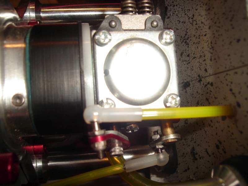

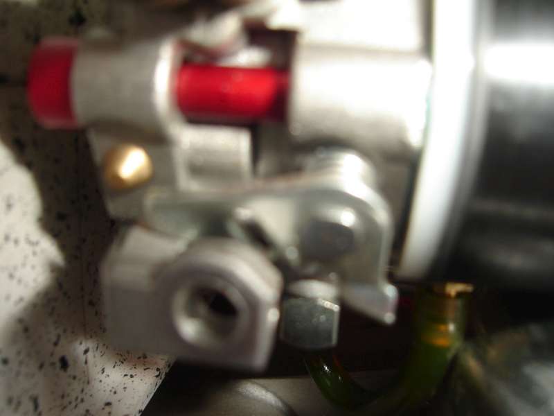

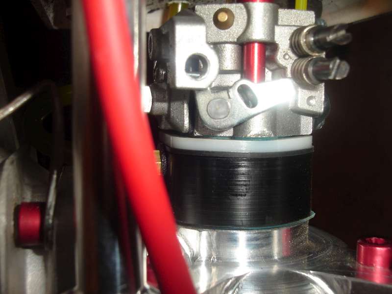

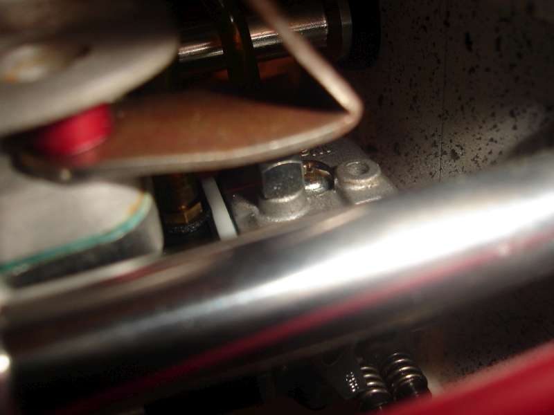

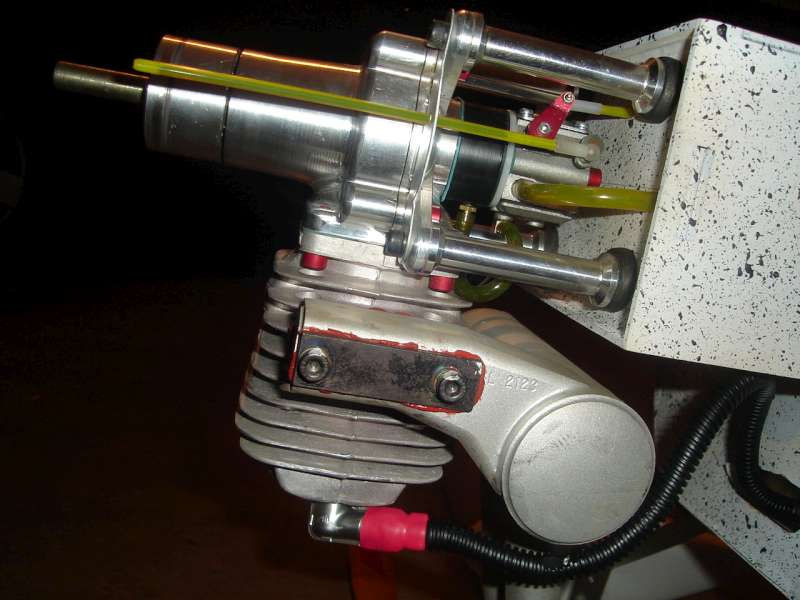

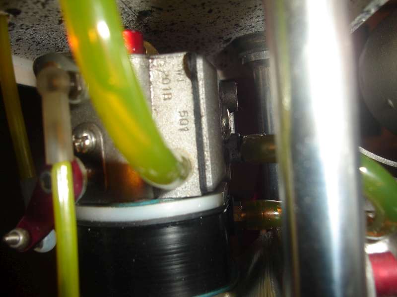

Thank you for your reply. I know it must sound like I am insane, but the unit seems completely sealed to me. I don't see an air-intake. Here are some pictures. It must be right in front of me. I took the 4 screws off the plate in the fourth picture, but it had a rubberish membrane underneath it so I didn't want to mess with it since I (clearly!) don't know what I am doing.

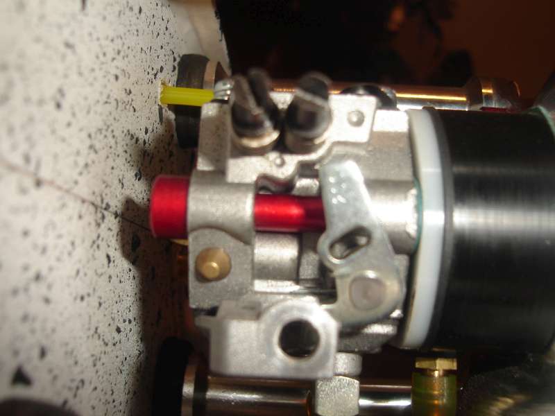

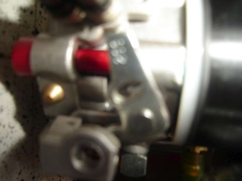

I can't see inside the carb because of the firewall. These pics are opposite the arm. Do you think I am fully open or fully closed in the second picture?

Hey bud,
I think DA would recommend a hole drilled in the middle to let the carb breathe a bit more, but don't quote me on it. Give them a call or shoot them an email to see what to think. To answer your question, the throttle arm is springloaded to move to idle. Pulling the arm back will open the throttle, and moving it forward will close the throttle. Does that help?

BTW, the arm I am referring to is the pretty red one.
In the second picture you are fully closed. The whole that is threaded and empty would be where the idle stop screw would go. DA doesn't include these with their carbs.

I agree with zope pope, you need a hole in your firewall for air passage. The carb air intake is flush with the firewall and that just won't work. You're going to have to remove the engine to cut the hole so you can look into the carb intake at that time to see the throttle butterfly. You can get familiar with your carb at that time and make some notes which way your throttle arm should move. How big should the hole be? I'd make it at least 1 1/2" and larger will not hurt anything. You can cut it with a small hole saw. I don't know what airplane you have and whether there is free air available in the box behind the firewall. A large hole will allow free airflow around the carb. If in doubt, make the hole as large as possible without sacrificing firewall strength for the standoff engine mounts.

While the engine will probably run with it that close to the firewall and no hole, it certainly won't run well. There is actually a formula for figuring the necessary minimum clearance from the carb inlet to the firewall, but it basically boils down to you need at least the diameter of the carb intake i.e. a carb with a 5/8" intake would need at least a 5/8" clearance to the firewall and that's the minimum.

http://www.desertaircraft.com/manuals/50Manual.pdf
Glad to be able to help. Check out the DA manual. it mentions atleast 1" of clearance from the firewall. If that isn't possible, drill a hole larger than the carb inlet. Its on page 3. Cheers!

I believe I have this set up correctly now in the basic sense. I confirmed what everyone has been saying about the direction the arm should be swinging. I still can't see inside very well (not as much as I can see on any given glow engine) even with a small mirror, but I believe I am fully open and closed (throttle arm as far as it can go before it starts bunching up, the middle being the estimated middle, etc all).
