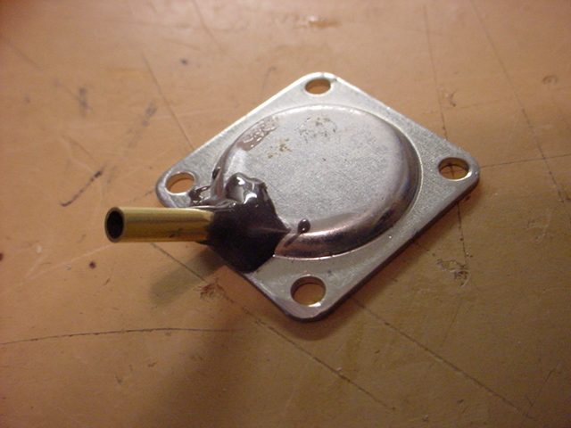

I have owned a few DA's before 50,15o and 100's but my latest one in my 2.6 extra 260 is displaying a trait that I used to get back in the day when I ran weed whackers. Basically the mixture is fluctuating during aerobatics. It will be fine going along a straight run up or vertical but as soon as it gets to knife edge or inverted it goes rich as hell. Also while in the prop hang it just wont settle to a sweet spot. It either surges or dies thus causing the plane to rise or fall. As I mentioned I used to get this on my Zenhoas but never a DA.
I have built a baffle around the card to try and balance the air around it but with little to no change.
Anyone else suffered this problem? IF so what do I need to do to sure it?

If the engine gets richer, the pressure on the regulating membrane increases. Make a pressure reference line on the carb plate, and run it to a small (matchbox sized) closed balsa box inside the fuselage.

Hi Pe,
Thanks for the feed back.
So I guess its the same as I used to do with the Zenhoas??
A few questions please.
Do I have to solder a tube onto the carb plate over the small hole through the plate on the front? ( Dumb question I know I just want to be sure ) Also when I used to do this the hole used to be in the middle of the plate. On this Walbro carb which made it easy... On this walbro the hole is right between the raised area and the flat outer.. On a radius [:@]
Last thing.. Does it have to go to a matchbox size hole? I used to just attach a tube through the firewall so it could breath from inside the fuselage. If it has to be a box then how much of an inlet do I make for this box? Or none at all???
Sorry for the daft questions.. I have got lazy with the fit and forget DA's that I have had up till now.

The box needs to be a "dead air" box, so the inlet should be the same size as the tube that passes through it with a simple pinhole in the box somewhere to stabilize air pressure. A tube still has to be added to the diaphragm cover if it does not already have one. The hole location is irrelevant on the carb plate as long as it's not internally blocked by some part of a gasket or diaphragm flange.
Another method is to attach a brass tube to the front of the carb that has it's opening in line with the carb venturi. Run a line from the diaphragm cover to the tube on the face of the carb. There's some pictures of this arrangement on the Wild Hare site somewhere. It's similar to the manner that 3w uses for their engines.
The tube into the fuselage method provides inconsistent results.

I have just made a Ply box internal measurement is 3"x 2.5" I ran a tygon tube from the 2mm ( I/D) Brass tube that I soldered to the front plate of the carb. I made sure this was all clear. I have then ran Tygon tube from this brass tube through a tight hole in the firewall. This pokes into the middle of the ply box which is glued to the inside of the firewall. In this box I have drilled a 4mm hole in the face opposite that of the tygon tube. I am just about to put a small 2mm hole in another face of this box, then glue it onto the firewall over the tygon tube.
Sound about right ????
Also will I have to alter my mixture at all??

All gas engines with diaphragm carb's can do this, not just DA. The pressure in the cowling affects the vent side of the diaphragm, changing the mixture. Getting that vent to be at a constant pressure is the goal. I don't know personally which one of these methods works best. The fuse can change pressures just like the colwing so that's not a guranteed solution. I like the balsa box but if that's in the cowling or fuse couldn't it still change pressures albeit a little more dampened? The fix that 3W uses makes the most sense to me. Since the carb's vacuum that pulls on the other side of that diaphragm draws air from the venturi outlet, it would make sense that you want the diaphragms vent side to sense that venturi inlet air pressure. That way the carb is pulling air and fuel from the same reference pressure (venturi inlet/carb air inlet).

The first box I made I used thin balsa and made it about 1" or so square. I only made one hole in it just large enough to fit the diaphragm line into tightly, nothing else. Balsa breaths pretty well.
If you are on the rich side you also "might" be experiencing some fuel puddling in the reed area, when you role etc. it all get dumped at once.

The balsa wood breathes enough to allow pressure equalisation.
Altering the mixture will be needed if the reference pressure changes. Just tune the carb like you should, and you will be fine.
