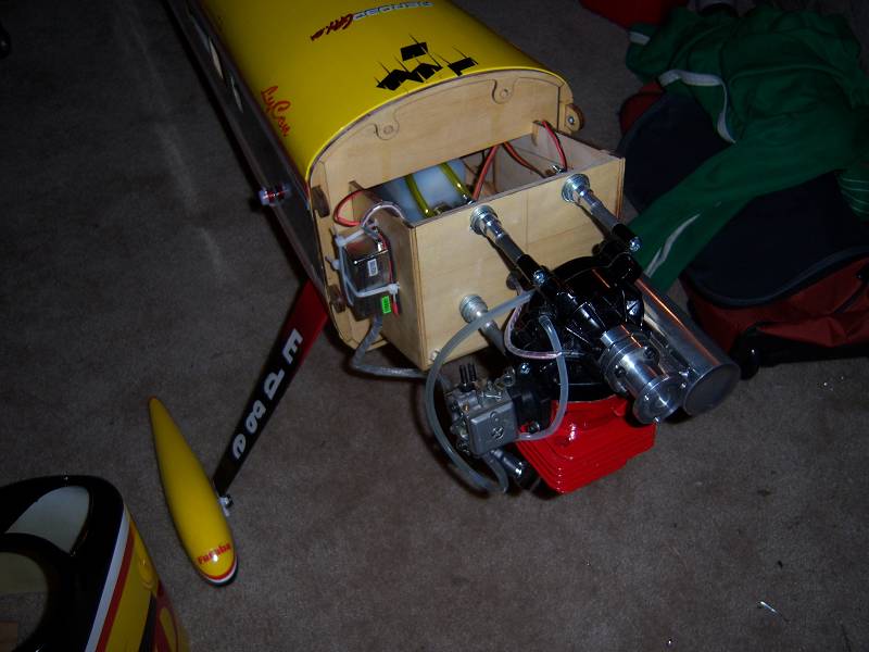

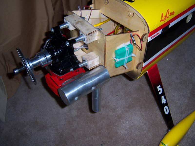

I got the new one with the new style muffler on it, and it has one outlet pipe. I got a chance to run it today and it popped on the first flip, the second one and it was up and running! Wow this thing has some power. Didin't get a chance to tach it cause I didn't go past half throttle. I broke all three torque bolts from the prop shaft becuase I didn't tighten the prop bolt enough. have some extras though... I have a 22x10 xoar prop on it and im gonna go out to the field maybe tommorow and run it some more and see if i get some radio interference.
Here are some pics, Oh, the tubing is not the gas type right now I had to order some from online, The LHS ran out of the size I needed... so i just ran it with the glow stuff for today

The standoffs are pretty "thin", comparing to those offered by other engine vendors. Are they coming with the engine?

Grade 3 allthread bolts, no pinning the firewall, disparate standoff extension materials, ignition hard mounted to the engine box. But nice graphics.

No, the standoffs that come with this engine are the silver ones in the back they are a little thicker and aluminum, I put the steel ones on there to run the engine untill my new ones come in... The firewall is pined, the lanier edge comes with it like that, you just cant see it from the angles posted. I also have triangle stock reinforcing the back side. the ignition is mounted to thin foam, Its a little stiffer than the traditional foam but its what i decided to put on there for now.. I got the bolts from The Hardware store don't know the grade, but they are thicker than the ones that came with the engine and I havent had any problems from them in the past.

Good, glad you are aware of what's been noted and have plans for cures. Hard sometimes to be diplomatic about pointing out weaknesses in installs.

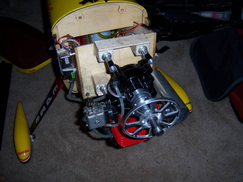

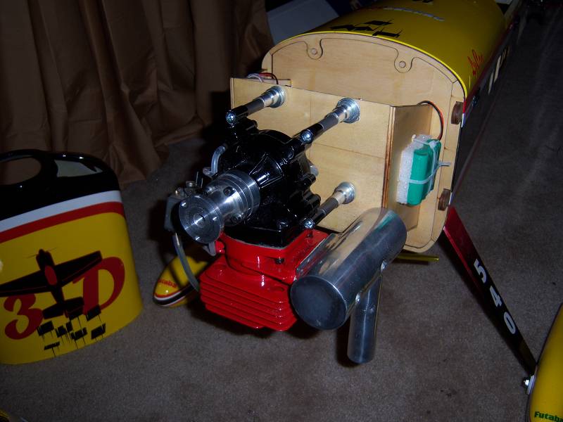

Hey guys thanx again, I would have never thought to do this... I decided to go with the setup you all sugested these are some pics of what I came up with... It's not the best looking but it holds pretty tight and I didn't have to use the 2in standoffs that cost 30bucks....

I plan to do the same with my ZDZ40. I think I can have the oak pieces touch the mounting lugs of the engine, if possible.

Good choice of mounting T3. Be sure they contact the lugs evenly or the crank case will have to warp to the shortest one. Soak the ends with CA when you are done sanding to harden them. Next flex up and down on the engine to see how much the firewall bends under load. If there is bending, close in the top of the firewall. Use lightening holes to get to hardware inside the box.
