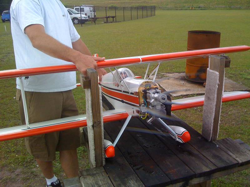

As mention in post #31, I finally was able to put together a day of testing with not
only my plane (Katana), but two others with XYZ Engines in them.
I can only comment on this forum as stated in RCU rules.
If you want to get detailed, please call me to discuss. I would be happy to answer
any questions you may have.
I'm not going anywhere soon and either are the engines.
I was able to get some numbers for the XYZ 50cc & 26cc.
On it's first run, the 50cc on a GreatPlanes Giant Aeromaster (picture attached) weighting 17lbs flew great.
Using a 20x10apc prop, we saw 6700rpm on the ground and unlimited vertical in the sky.
The 27% Katana with a 22x8 Bolly prop flew it ok with unlimted vertical and 6200rpm on the ground.
Switched to a 21x10 NX and flew great with 6200rpm on the ground.
Switched to a 20x10 Xoar and flew about the same with 6500rpm on the ground.
The 1/4 scale Edge with the 26cc in it could not fly do to a servo problem on the elevator.
We saw 6900-7000rpm with a 18x6 TF prop and 8100rpm with a 16x8 MA prop.
For the Katana/50cc, it was it's 2nd flight right out of the box. I flew it once last week.
For the Aeromaster and the Edge, 1st out of the box.
I flew the Katana myself and could hear the 50cc getting stronger as I flew it.
All engines started up and ran with very little adjustments if any.
All of the High needle settings were a bit rich for breakin.
My conclusion:
I saw more torque than high rpm. None of the engines would bog down on
vertical. They just continued to pull.
Some engines I have tested would just continue to drop on load.
It was a long "but fun" day yesterday, and to me that's what it's all about !
I hope this helps,
Ron

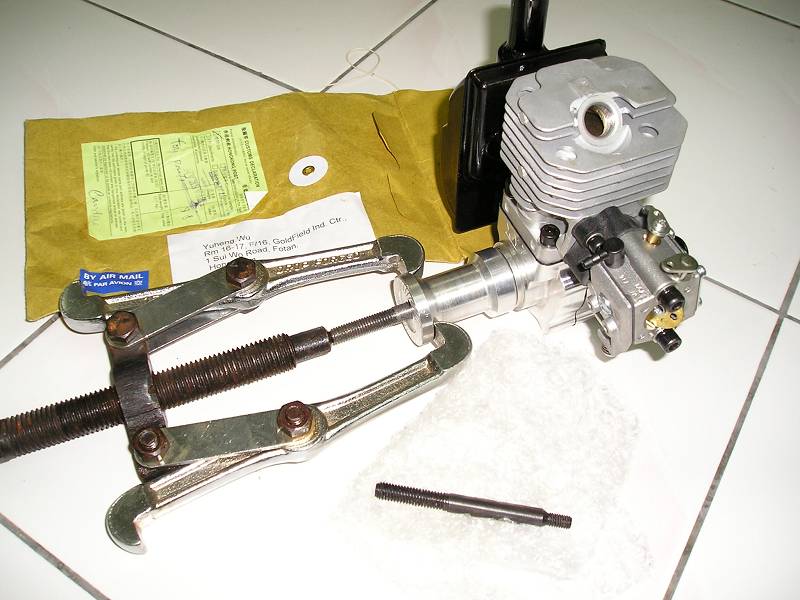

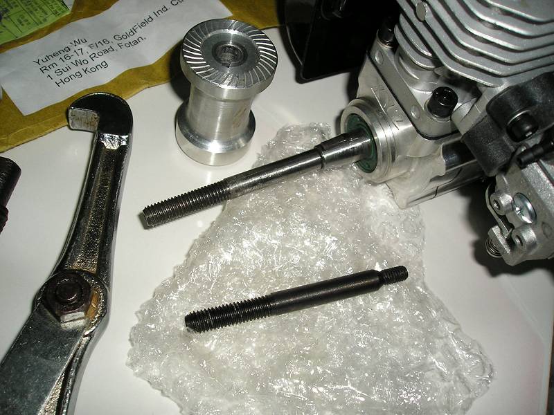

Joined: Jan 2007
Posts: 129
From: Kota KinabaluSabah, MALAYSIA
Hi Satellite,
I received a replacement propeller shaft from your HongKong web seller this afternoon.
Upon fixing it onto the XYZ 26cc engine, I spinned it and took a short video clip and uploaded it to the Youtube. Please take a closer look at the spinning propeller shaft and see what happened.
[link]http://www.youtube.com/watch?v=-TuqFBx9B1M[/link]
[sm=cry_smile.gif][sm=cry_smile.gif][sm=cry_smile.gif]
Pic showing the replacing:

ORIGINAL: nowinkk
Hi Satellite,
Hi Satellite,
I will let Satellite know that your post is here and will let him respond to this.
The only thing I can tell you is, if this came from me I would replace the entire engine.
So far so good on our end as I checked four from our last order and all were
find. I did this because of your post #17.
By the way, that engine looks right at home in that great looking Aeromaster![8D]
