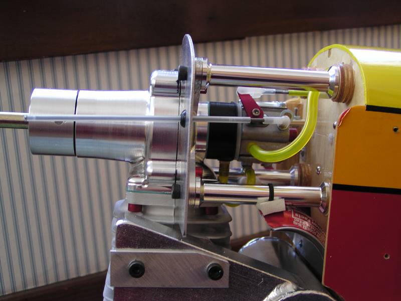

Umm this maybe a stupid question but for the life of me i cannot see a choke on my DA50. Does anyone have a pic of its location? the only arm i can see is the throttle.

Is it possible the end broke off? You should be able to see at least the shaft. It's the second butterfly located at the air intake of the carb. There's a short little steel arm on the end.

Look at the open end of the carb. The hole facing you, not the one up against the engine. There should be a brass plate attached to a rod passing through the outside opening of the carb. One end of that rod should have a little lever tab. The round brass plate, rod, and lever are all part of the choke. Frequently one needs to be creative when hooking up choke linkage. Hopefully this engine is to too technologically advanced for it's current location.

You asked for a picture, so here it is. This is a new DA50 mounted on a Sig Sundancer with a Jtec Pitts muffler. The choke is the small silver lever on the right. I attached a short pushrod that is guided through an aluminum cowl baffle plate. I can reach through the cowl opening in front to manually choke the engine. (not while running, of course)
