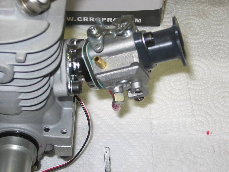

Hi Guys: I just completed assembling my GF40I kit and am busy making a test stand for it. I notice the carb on mine has a choke set up that once set, releases if you give it any throttle. So, unless the throttle is completely closed, the choke will not stay on. I've never seen one of those before and am wondering if all the GF40i's come with that same carb set up. Also, on mine, the throttle arm is very short and also has very little clearance between it and the intake manifold. A clevis is the only way I'm going to be able to hook up the throttle linkage to mine the way it is. A more secure, bolt-on connection would hit the manifold and jam. The question is: Is yours the same way or did I just get and odd one?

As for the carb, when you buy the kit, that is the way the choke comes on the carb. If the velocity stack is accessible in the installation you won't need the choke valve in the carb, I just use my thumb.

I'm embarrassed if I got that manifold on incorrectly. I thought I made it look like the photo that came with the engine instructions!
If it wouldn't be too much trouble, Jody, could you post a photo similar to mine so I can copy your installation and be sure to get it right? I'll bet I'm not the only guy who did it this way.
As for the "use your thumb" to choke it routine, I agree that works fine. I do it all the time on my Q-42 powered Extra and it works great.
