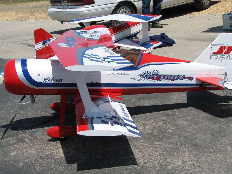

Joined: Oct 2007
Posts: 5
From: Antelope, CA
Some photos ofmy Aeroworks Pitts Python with BME 58 mounted.
I emailed Tom at BME to see if he has any ideas to help me get this motor tuned right. 6300 rpm's with a Xoar 23x8 can't be right and no way to fatten it up.
#125
Joined: Apr 2003
Posts: 4,890
From: Left Coast ,
CA
jmkibbon,- Is that with the stock BME muffler?? They are pretty open compared to other manufacturers, this might be one of your problems, but you still should be able to make it run rich.
