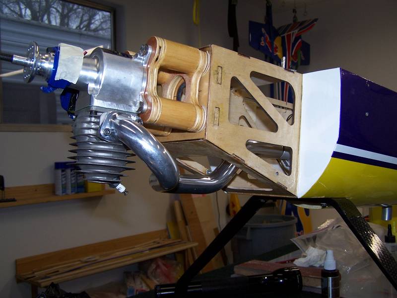

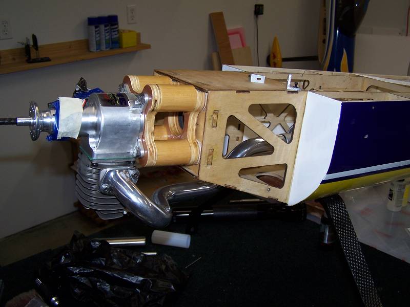

Hey RTK....
the header i had Karl up in canada make for me , was a tough one! I had to have some special bends in it to clear the firewall. I could have had it built a little shorter , but i just sent karl some phots and measurements of my set up , and this is what i got. karl is a craftsman to say the least...he built it exactly to spec.
With that being said....the pipe , from exhaust stack to the end of the pipe is about 13.5" and the canister is 8" long. The canister is about the same size of what a normal sized 50cc canister would be ( close to a MTW 75 i believe.)
here is a couple pics so you can check it out.
BTW....IF i have to , i can run another header i got from another guy on FG , that Karl built. It is about 12.5" long , but i can cut dang near 5-6" off the thing , since it only bends once , and then it's a strait shot to the canister. Only problem is , i'd have to cut into my firewall.
I wanted to run this longer pipe to at least see what it's going to act like. Any ideas on what it may do with that long of a header and canister set up?

You might be just fine the way you are, Karl sure makes nice headers.
I have never run a can on this engine, if it is a tuned type can and you are too short you will see a definite decrease in power and a rise in temps. If it is too long you just don't see the power, but she runs cool.
You should hit around the 7's for the average 23x8 prop (nx, menz) and 7300 for a vess23a. That is what I got with a stock muffler if memory serves. BUT,,,, at your weight, you will be ballistic with any set up

YES!!...that's what i wanted to hear! I guess i'll just have to get it fired up , and tuned , and see how she does. I know one thing , karls header won't be having any problem letting it breath ....the pipe is dang near glass smooth on the inside with an exact port match....hope she runs well.
