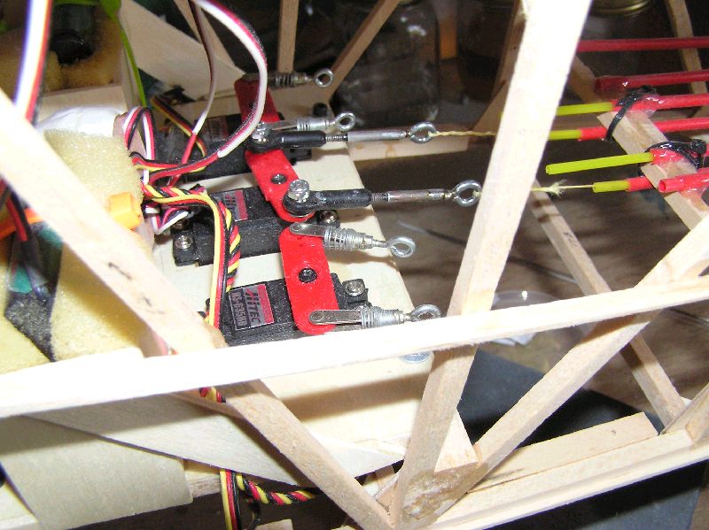

I buy a roll of Sullivan S-108 Tuf Strand U-control cable at my LHS. A 60' reel will last you a long time. See this link: http://www.sullivanproducts.com/Cont...eMainFrame.htm
The way I use the Kevlar allows it to be used without having to go in a perfectly straight line. I run the red nyrod outer jacket from front to back in the normal manner. I then put the Kevlar inside the yellow inner push rod and wick a small amount of thin CA into the push rod at one end only. The nyrod acts like a bearing. No chafing. Probably last longer than the model.

Thanks for the tip Big Bird, looks like the solution the the problem I run into with my Ultimate. I am using a tuned pipe which a built a tunnel for, and I now cant get a straight run on the pull pull cables for the rudder. I will definately give that a try. Thank you

I've used this method on 4 airplanes and it is fool proof. I'm sure it will work for you.
