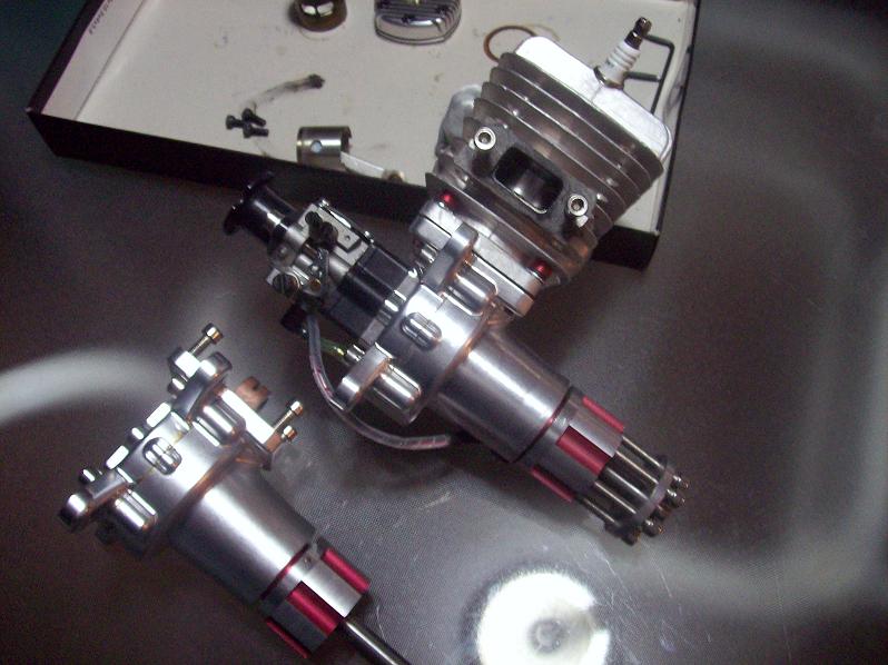

Just an update on the engine.
It is holding up well so far.
I did change the ignition to an RCEXL ignition.
The stock CRRC ignition plug cap was loose and it would intermitingly spark.
CRRC made the new engine case from harder aluminum and I replace the first softer engine case.
The rpm numbers went down about 250-300 rpm.
I have run about 1 1/2 gallons through the engine since then and the rpm are coming back alittle.
I used to get 7500 rpm with a Mejzlik 22 X 8 ( Feb. 1st 2008 ) and it was about 40 degrees with low humidity.
Yesterday, I got 7300 with the Mejzlik 22 X 8 ( Aug. 15th 2008 ) and it was 92 degrees with 73% humidity.
I am still having an issue with the plane and cowl making the low end rich in the air.
I opened the outlets of the cowl more, which helped the issue, but it is still there.
I am going to run a tube from the carb into the fuse to take the cowlpressure away from the carb.
I'll keep you guys posted.

On mine , ive put the new CRRCpro ignition. No more problems. Ive removed the spark plug cap, and mounted again with the RCEX boot (silicone) and retractable tube with adhesive as RCEXL does. Also i've put a clamp (collar ? ) on rear side of plug cap.
My engine does the same rpm numbers as with old crankcase mounted (left on the picture). The factory send me the new crankcase time ago with all parts mounted , no serial number this time and i only have to change the piston, cylinder and carb. I don't know if bearings are now glued (sealed) to the crankcase , but it seems improved and will run as expected. I think it will be ready for sales soon.....

That is the way mine came also. I just had to do the piston, cylinder and carb.
Jody's and mine both were down on rpm's after the case change, ours were down 200-300 rpm.

Yep.
1st issue with my 1st prototype was the engine case was made of too soft of aluminum and ater some run time the bearings started to get loose ( wearing the case ).
Second was two failed ignitions. ( I am running a RCexl ignition now ).
The new harder engine cases did not perform as well as the 1st prototype did. ( engine lost 200 - 300rpm ).
Now it seems to be running fine, I just need to put more time, time, time on it.
But since deer season is in, all my planes will not be used till around February. ( maybe one or two times on a nice weekend ).
Jody may have some more issues with his.
Maybe he will chime in.
