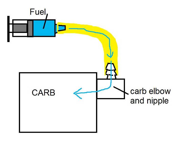

Thanks for all the help, but a few things...one, the nipple in question...has to be hooked up, or the engine will not draw fuel...I tried and tried to get her to pull fuel...wouldn't do it untill I hooked up the other nipple and then used a syringe to shoot a tiny bit into the carb. Also, I don't see how the 35cc isn't enough. She was about to break the horz stablizer feltlike it was going to rip off when I was throttling her up. The engine seems to be running a little hot, should I increase the oil mixture? Also, I want to hook up an engine kill switch...I have a jig with a stnrd servo and I was going to link it to a switch and use a channel such as "gear" to actuate the kill switch, any ideas or comments or experience on this idea?....it seems to have waaaaay more then enough power to fly non-3D or IMAC, people gave me a feeling it would struggle in the air with the quadra...there is a connection in the magnito,is this the location where I need to run a lead from this to a switch and a lead from the wire that is attached to the crank from the other side of the switch?

Old 06-28-2009 | 12:29 AM
My Feedback: (10)
Joined: Jun 2008
Posts: 343
From: Mansfield, OH
Default RE: Quadra 35cc Question
Here are two pics, not the best quality but the camera is somewhere and all I have on hand this late is my Blackberry. The Blue arrow is pointing to the mystery nipple, the red arrow and circle is obviously the fuel inlet for the carb, which has a line on it.... The engine will not pull fuel without it attached to the vent line [&:]..... I actually had to squirt some fuel into the carb and use a syringe to get some fuel into the line so that it would start up and start pulling. The little elbow where the carb line nipple is was really blocked [:'(], I had to attach a small piece of fuel line and use a syringe to push fuel through the elbow(see diagram)to clear the blockage... I really had to push hard to clear the blockage, I may need to clean it out more, any tips???[&:] maybe take it off and clean it, it works fine now and the engine isnt starving for fuel, and there is a really good new filter on the fuel line.... works good now

Old 06-28-2009 | 06:34 AM
w8ye's Avatar
My Feedback: (16)
Posts: 37,576
Received 11 Likes on 10 Posts
From: Shelby, OH
You are going to need to plug the "Blue" circled nipple or the engine will not run well. Use a piece of Tygon and a plug in the Tygon. You can get Tygon fuel line at Glenn's in Shelby,
You need to have someone show you about about how all this works? This is from your description of the carburetor drawing fuel? About the pump side of the carb. The regulator side of the carb. Why you couldn't push fuel throught the carb. About the filter inside the carb.
You need to take the engine to someone who knows gas engines, chain saws, weed whackers, to have them explain how the Walbro type carburetor works and how important the engines crankcase being air tight is.
I live just north of your town if you want to come by my house I can show you how everything works and what is important and what is not? SENDMEAPM
Old 06-28-2009 | 10:18 AM
My Feedback: (10)
Joined: Jun 2008
Posts: 343
From: Mansfield, OH
Thanks for all the help, I didn't literallt mean that the carb was drawing fuel....more acurately I guess I should have said the fuel wasn't being drawn into the engine/ carb....I know it uses a diaphram....all the real specifics I don't know...I did know that yo needed to have that plugged I have extra tygon...heck I would like to get together just to REALLY know how these work in detail..I do know the basics and could survive on that but you seem to have a broad sapn of knowledge on these...I will send you a PM later on with my contact info!
