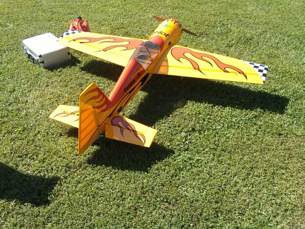

Thanks I will try that. I also flipped my carb and left the gasket and black insulator in it's original place. I check the needle valves as well.
If all goes well today I should have it out flying tomorrow on my new SU26!

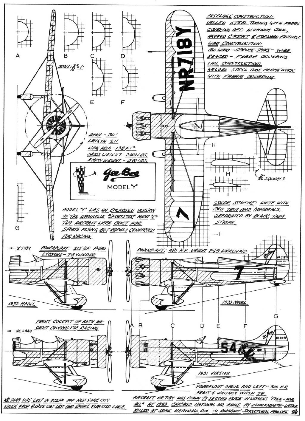

The DLE 30 may fit in the G BEE, but it would snap in a heartbeat if you hit the throttle any to much at all...like at slower sdeeds. Why take a chance....put the engine in something else for several months. Then if you still want to take a chance...try it. Capt,n
#267
ORIGINAL: captinjohn
John
#269
ORIGINAL: Wingspam
captinjohn can you expand on your statement above! I am not sure I understand where your coming from
