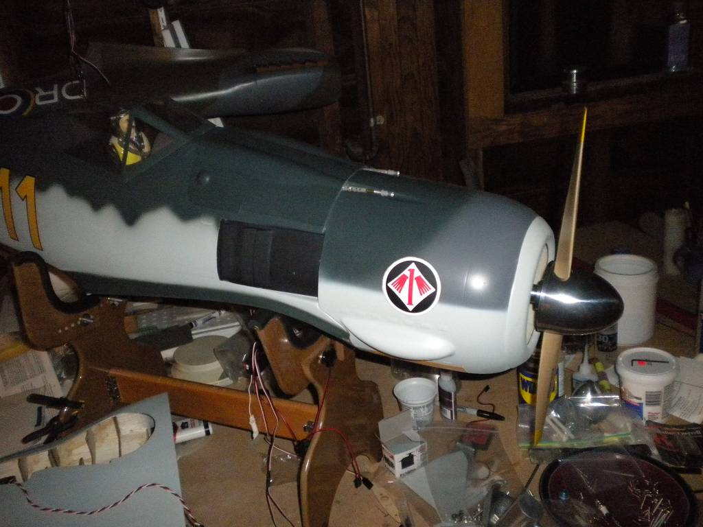

so I have the 30 all mounted up and am cutting the cowl in my question is I have these pipes hanging down quite a bit from my pits muffler is there a reasonable minimum lenghth I can cut the tubes down, so there not quite as long , ideally I want them as flush as I can get them to the cowl, my concern is affecting performance or back pressure.
any insight into this, I wanted to ask before I cut them too short and need to buy another muffler.

Some pitts mufflers have a crimped area right at the outlet of the pipes.
If yours are just straight pipes with no crimp on the end, there is no reason you cannot cut them off
