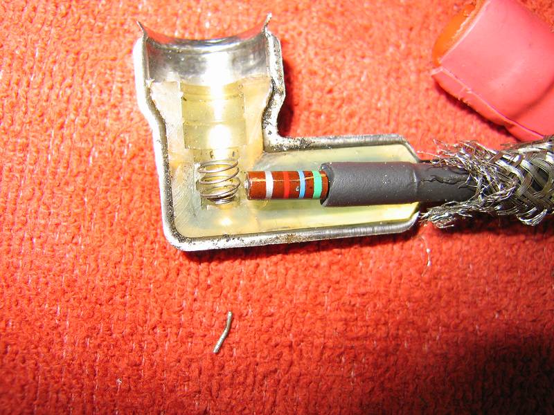

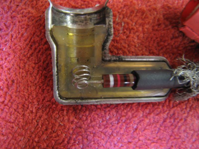

Hereis the top secret inner workings of the DL/RcExl plug cap revealed. In the first picture you can see the broken off post of the resistor right below the cap, this is all that was wrong with this dead ignition, the second picture shows a new resistor and how it contacts the small spring that hits the spark plug if it's pushed on all the way. The resistor is there because the CM-6 type spark plug is to small to fit one in the spark plug to suppress RFI.

The big spring in picture 2 doesn't actually sit there does it?
My cap has a hole that is about 1/8" diameter in the silicone/rubber boot above the resistor and a small coiled spring about 1/8" diameter maximum. Does the tip of the plug protrude through the hole when the spark plug cap is on all the way?
Greg

The spring in the pictures is the small spring you describe and yes, the plug does go through the small hole just above it to make contact with the spring, one of the reasons the are so hard to push on and pull off, also the main reason they never fall off in flight if on all the way. Here's a picture with the rest of the components for clarification, please pardon the fat thumb.
