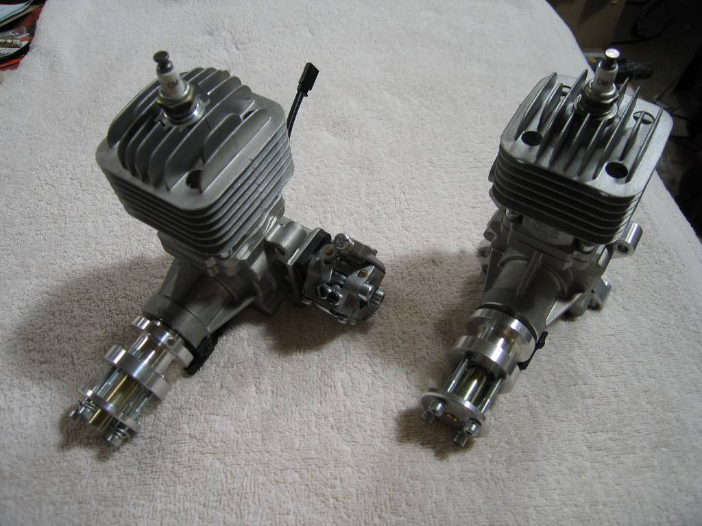

Kindly clarify if the Carb on Original can also be fit and work with your altered setup ?...

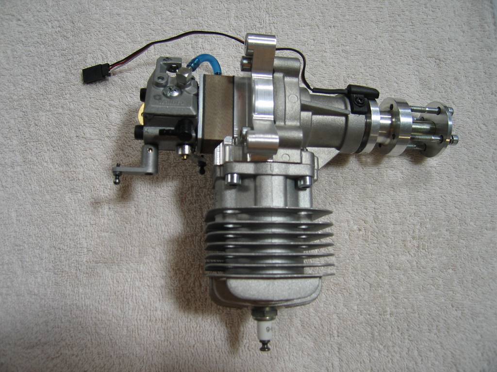

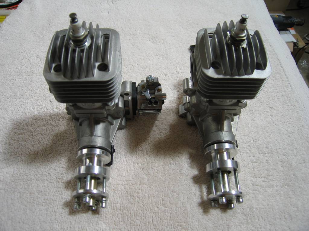

ORIGINAL: dynasel
Yes you can use the same carb, just moves from one place to the other with a rear induction reed set up.
also the newer backplate will have the carb bolted on straight like the 50&55 are. Also It will utilize the internal pulse port not the external as shown in the pics. It will still allow for the carb to be turned 180 if needed.
In the DLE-30 thread Jody gave the RPM numbers with the rear carb set up. steady idle down to 1450, and a top RPM of 7200 on a new cylinder,piston and ring using a 19x8 laminated prop. That alone is great but with some run time it should even improve.
The original cases are done on a CNC and the deck height is the same on all of these engines so a complete case is not needed for the change over.
As far as presserizing the fuse, Who knows, alot depends on the type of aircraft, round cowls planes seems to be the worst.
I make it a standard practice to use a line from the pump plate to a pill bottle on all of my gassers just in case.
Hope that helps.

The area behind the engine is one of severe turbulance as far as ariflow is concerned. What little additional air entering the fuselage would not have any impact on pressurization in that area. The turbulance is one of the reasons so many people have issues with hot engines. They recognize the need for inlet cooling air but fail to understand the need to direct the incoming to an out going. They end up with a mini tornado roiling around behind the engine, retaining most of the heat they were trying to expel. You can have all the exit area you want, but unless you have provided a means for that expanded air to "know" where it has to go you wasted most of your efforts.
As for any additional air that manages to enter the fuselage, as long as wings and canopy hatches do not pressure seal, and there are pushrod exits, there's not way to pressurize the fuselage.

The carburetor on the engine in the pictures is the original Tillotson that came with the DLE30, it just has a Walbro pump cover on it with the external pulse fitting.
Anytime I mount an engine with the carb through the firewall I always make provisions for ventilation at the rear of the fuselage. Where you get pressurization problems is when manufacturers cut lightening holes in the front fuselage bulkhead around the engine box, people that don't tape over those holes or don't provide an exit for air at the rear of the fuselage are rolling the dice every time they fly, IMO.
