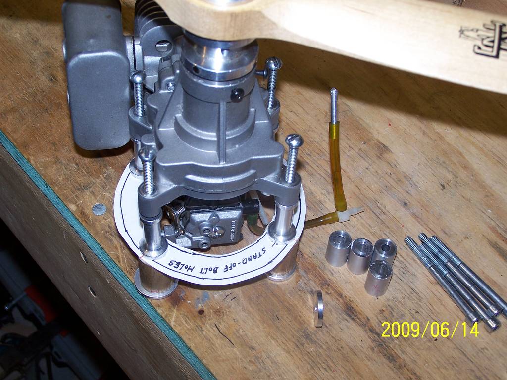

<hr />Now while we are talking about the rear induction DLE30cc engine, I think I am going to make a ring out of 1/8 .125 thick aluminum plate and make a brace like the one below...that is now a thin white piece ofcardboard. You could also drill &amp; tap this round plate to hold other things...like a choke rod support! What do you think? Capt,n

I think I am going to flip the carb so the needles are on right side. That way I can adjust them from behind the prop with my right arm. I will solder a cut-off hex head from a bolt &amp; use my long "T" handle to reach them through a small hole. May try a piece of fuel tubing slipped over each screw and use a long screw driver first. Capt,n
