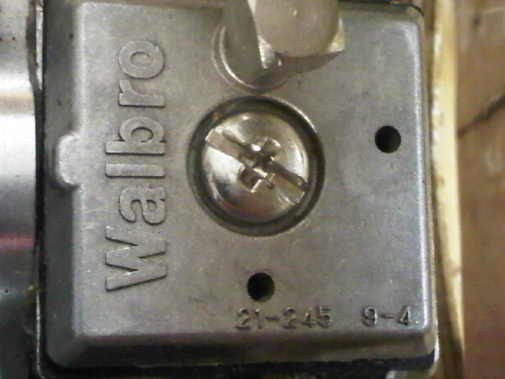

Along with my list of to do's a couple of people mentioned that I should just rebuild the carb as it doesn't take very long and if the carb has been sitting for a couple of years chances are either the diaphragm has gotten a little stiff or one of the gaskets may have gone bad. Unfortunately I'm not having a whole lot of luck in tracking down a rebuild kit for the Walbro carb. I've take a couple of pics maybe you can help track this down for me.
First picture looks like 21-249 9-4 no hits on this at all. Second picture looks like HDA 18?? maybe 98 it's not very legible, then under it says 411. There are several HDA carbs. But the manual I tracked down didn't look anything like this one.
Anyone that knows this engine and has rebuilt this carb could chime in I would greatly appreciate the help.

My Feedback: (16)
You can see the number plane as day
HDA189 B
16.66 mm
Gasket/Diaphragm kit D20-HDA $6.83
http://wem.walbro.com/walbro/product...amp;Series=HDA
HDA189 B
16.66 mm

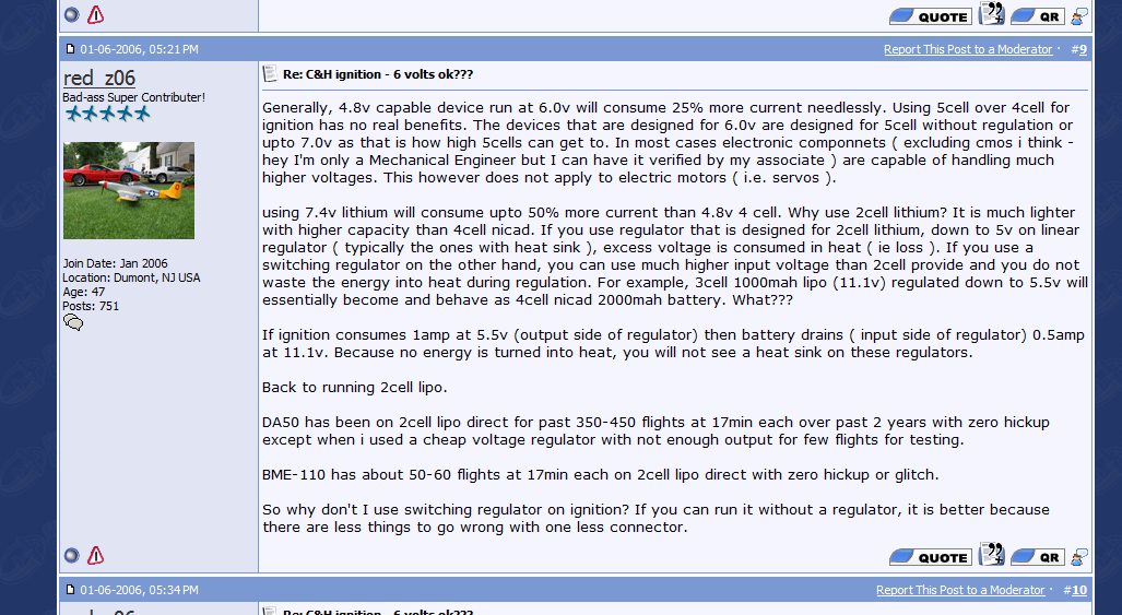

Back to the Original Posters question. First of all if the battery requirement is 4.8 to 6 volts, His battery is fine.

I think this explains alot if I can get it posted, if your ignition was designed for 6volts and not 4.8v, 25% would not be wasted going through the heat sink of the regulator on the ignition. I will send you what I found to your e-mail address because I can't get it to upload and post since it is from flying giants not rcu. this proves my point in a round about way. I enjoy all your feedback it is a learning experiance.

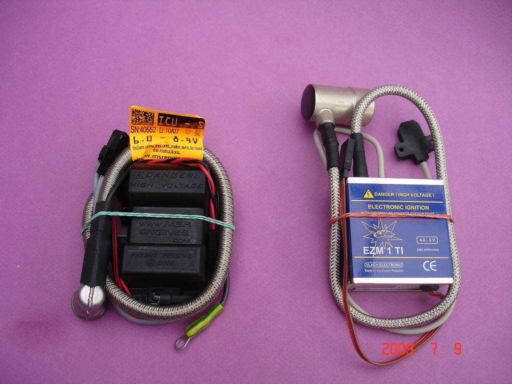

#49
Hi!
If Horizon only could use the same name for their engines the rest of the world use, MVVS!
I assume you have the older ignition that looks like this, new to the left.
The older Vlach ignition system runs on 4,8V-6V.
The new one 6-8,4V.
Of course you must use a clunk in the tank! How could the engine/carb otherwise get fuel???
The new one 6-8,4V.

ORIGINAL: jaka
Hi!
The new one 6-8,4V.
The new one 6-8,4V.
