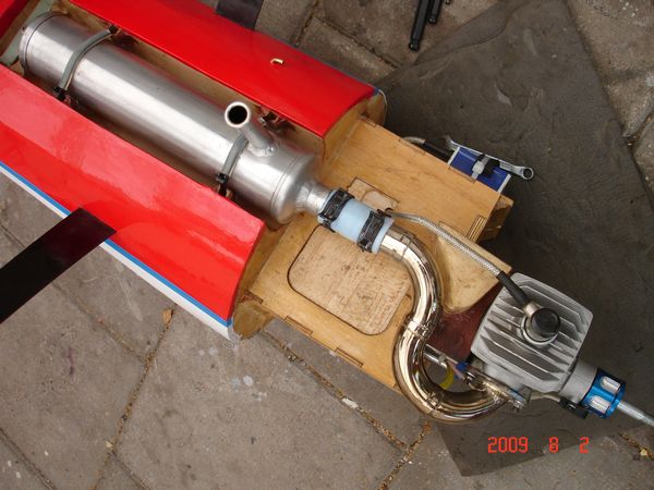

Hi!
All MVVS rpm readings are either with a cannister or tuned pipe. My MVVS 45cc engine with the small MVVS cannister silencer turns a 24x8 Mentz (Wooden prop) at 6600 rpm. It also turns a Top-Flite 24x8 at 7200 rpm.
I assume that your readings is without a cannister silencer..?!
I recommend using one! You get more rpm (power) and your engine will not sound like a moped..

It is a 7.4v MSR ICU-L I got from Pe Reviers in the Netherlands. Saved about $100. Horizon replaced the defective ignition for free, so now I have a spare for my Evolution and MVVS engines, it works on all single piston engines. My son and I fly at Stone Mountain(SMRCF). A bunch of our members moved to GMA. I would like to drive up there one weekend, the photos look nice. I have a 45cc evolution that is almost four years old and seems to run better everytime it is flown.

Hi,
you are right. I used to have 58 ccm and I used Mejzlik 26/10. I had 6000 RPMs with canister.
Now I have 80 ccm and with same prop 26/10 turns 6660 RPMs.
