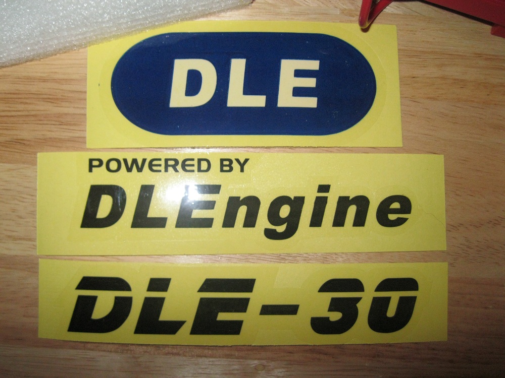

Update to the Decal post I made. I opened the manual today and some stickers fell out. They are different though. I like the old one better. There is one ugly blue oval sticker that just says DLE. The other two are kinda cool. One says "powered by DLE" and the ther says "DLE-30".  We'll see what they are currently doing with the DLE20 as far as stickers. Ill probably be ordering one next week.

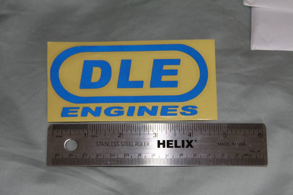

Here is what I got with my DLE20..........
Old 07-29-2012 | 05:49 PM
  #5631
mach2's Avatar
Joined: Nov 2011
Posts: 1,108
From: bakersfield, CA
Default RE: NEW DLE 20cc Gasser! (Data & Links 1st Post)
Cool. That's the one that came with my last DLE20. I like that sticker the best. Unfortunately is was not salvagable. More importantly the motor was!
The stickers that came with the 30 were cool. But the blue oval one is pretty generic.
I still cannot understand why they will not sell decals. Why wouldnt they want advertisement. That the best adverstisement you could ask for. And people would be paying them to do their advertising!
Jeremy
