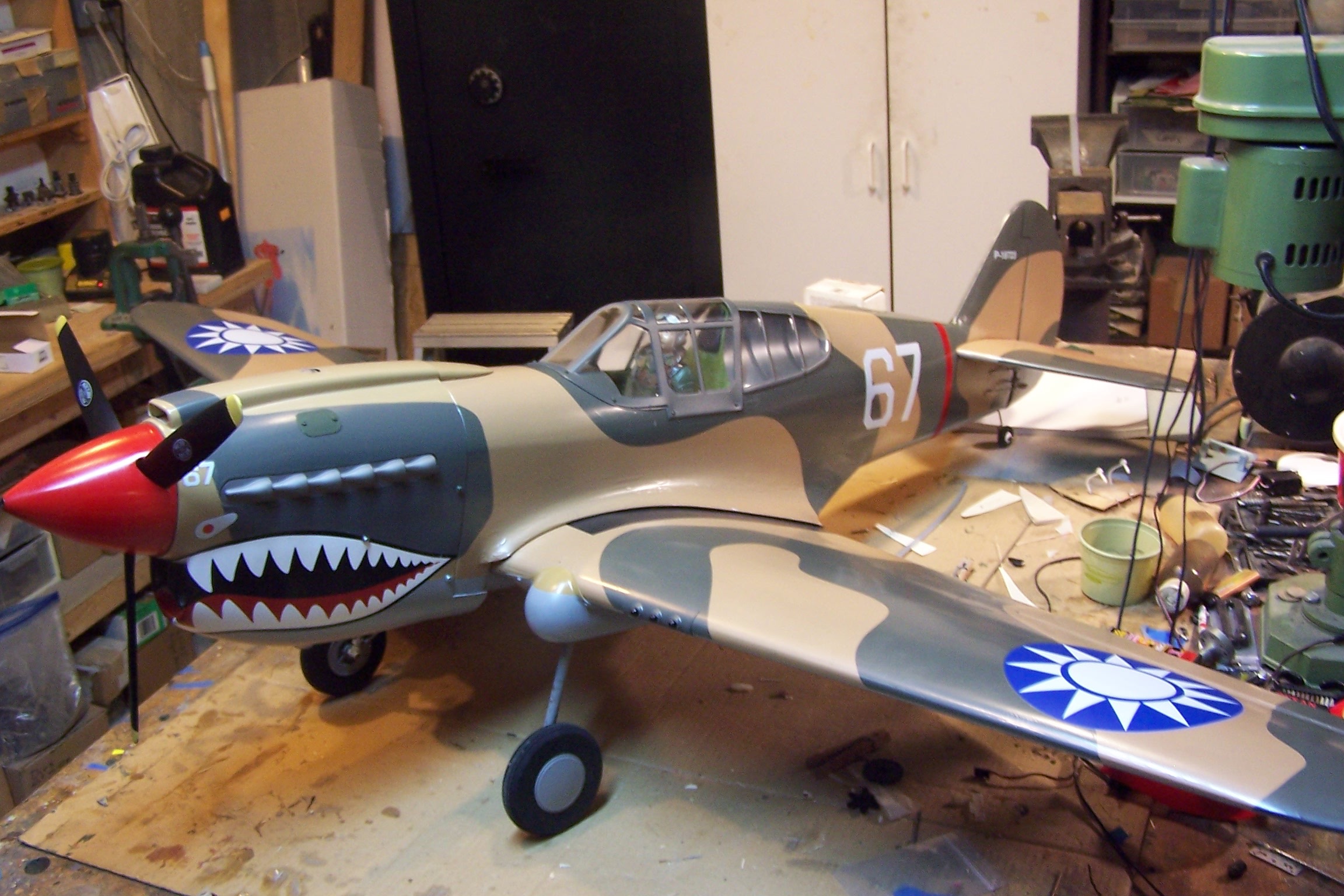

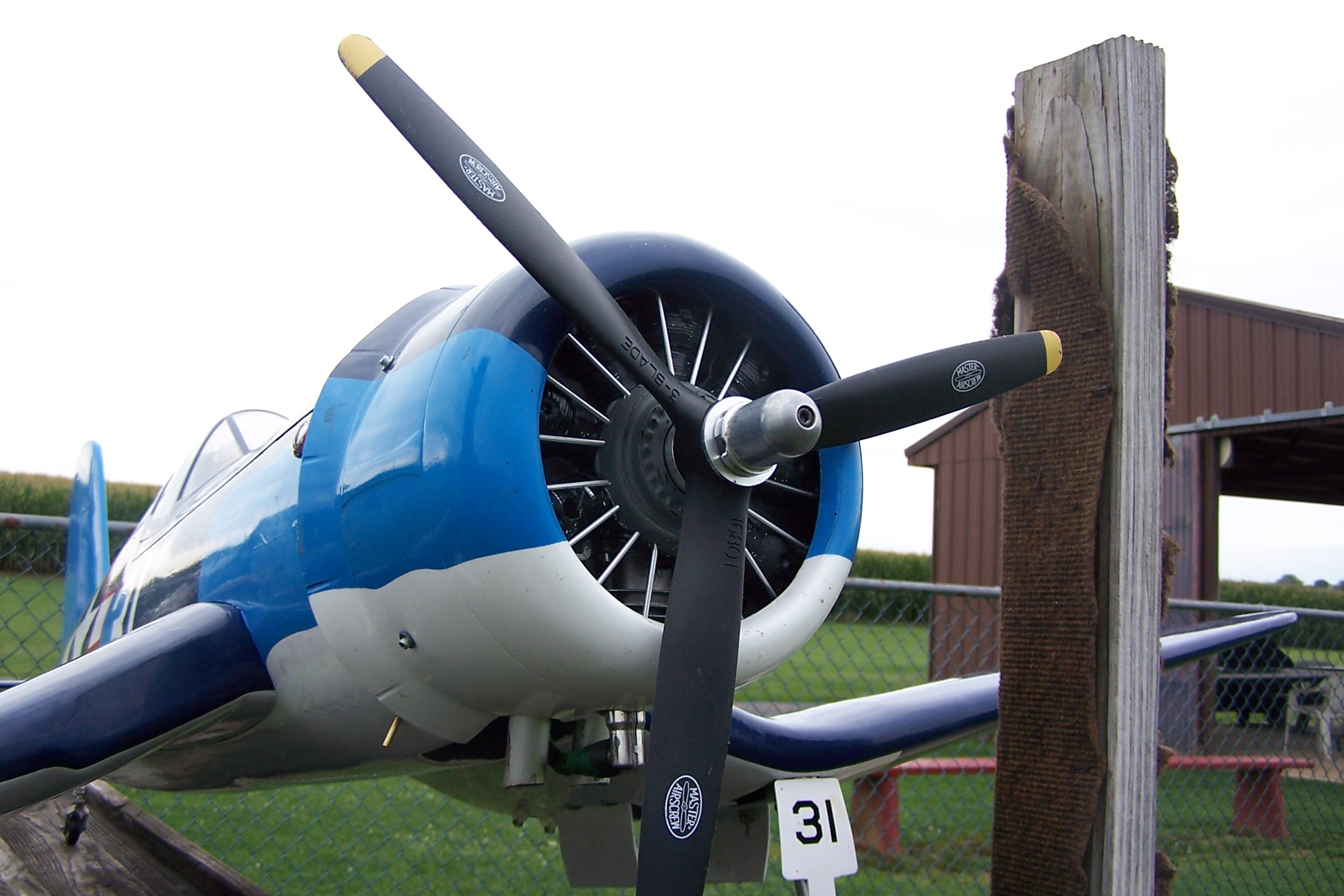

I have had good results with the Master Airscrew 16-8 three blade props. Depending on a number of variables, getting 7,000 to 7,500 RPM with this prop. Besides that, they look good and give up very little performance to a two Blade.

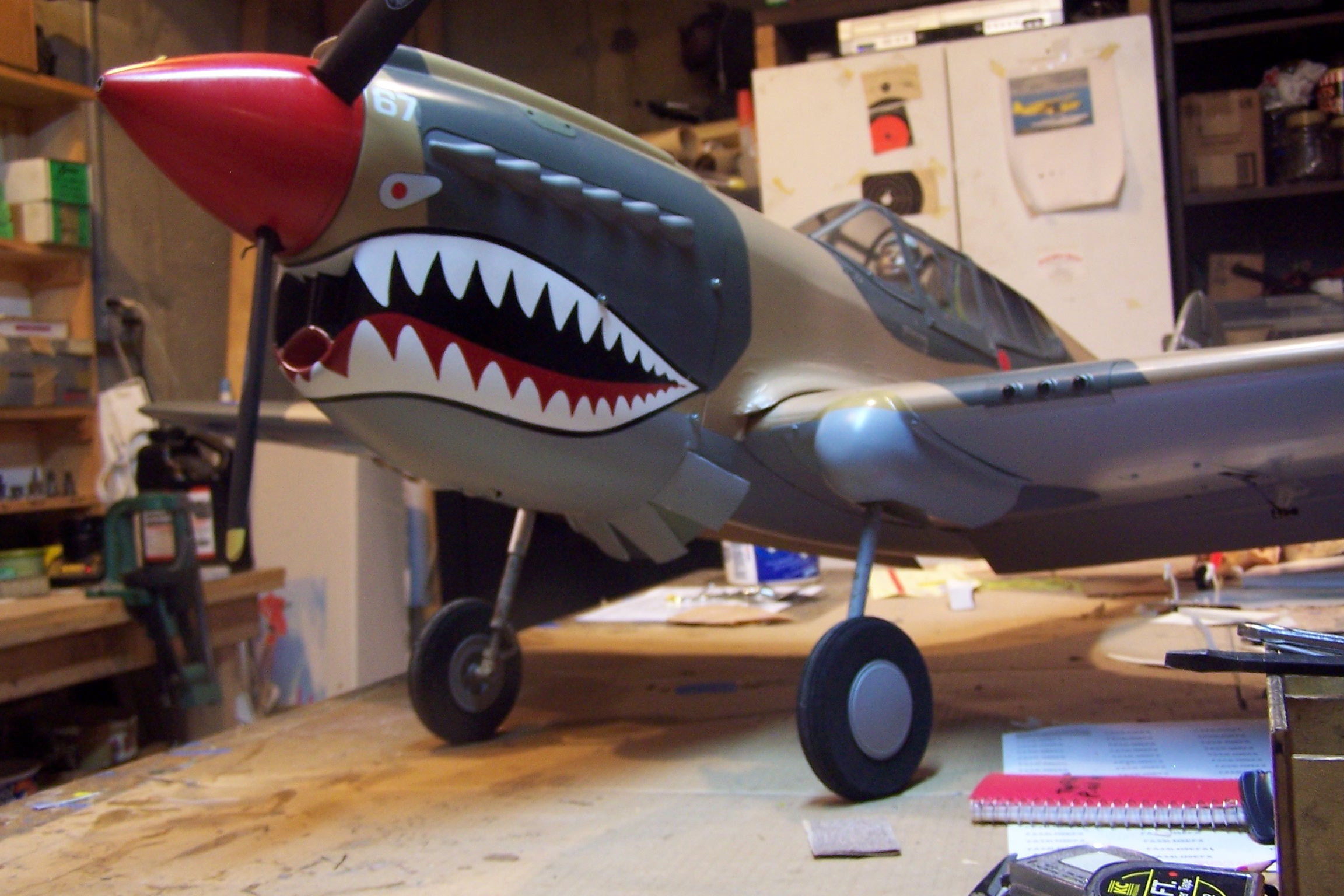

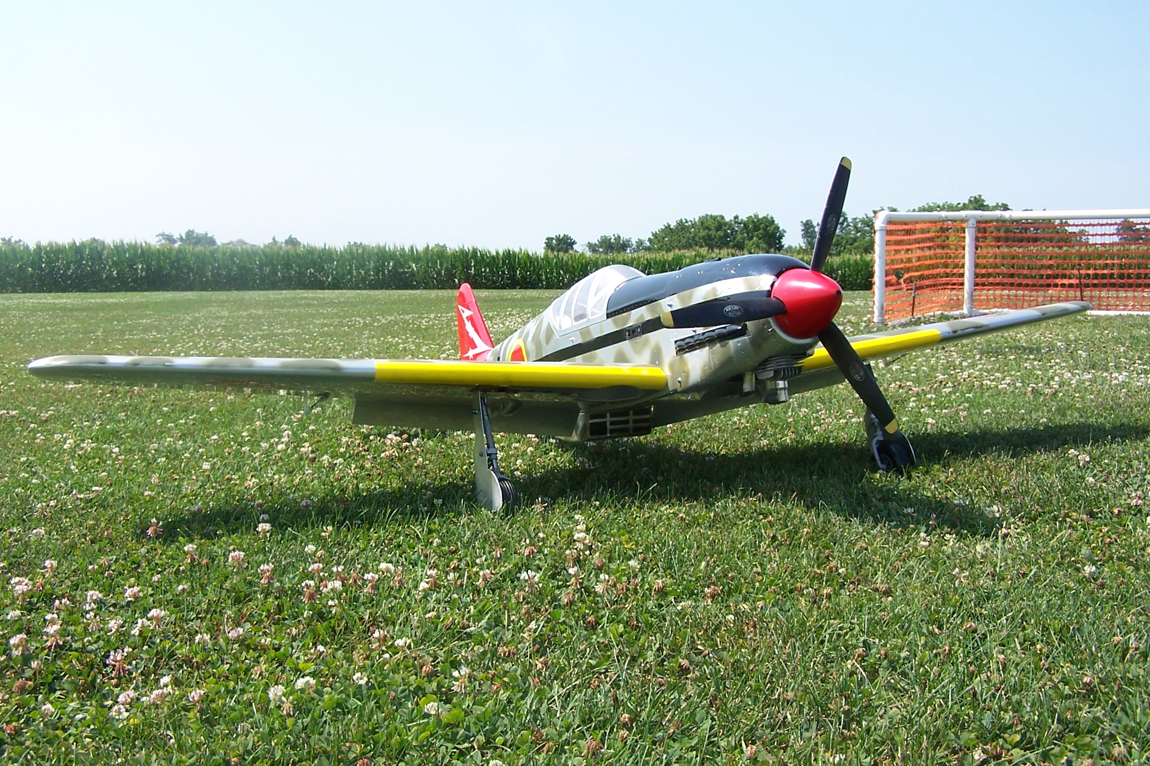

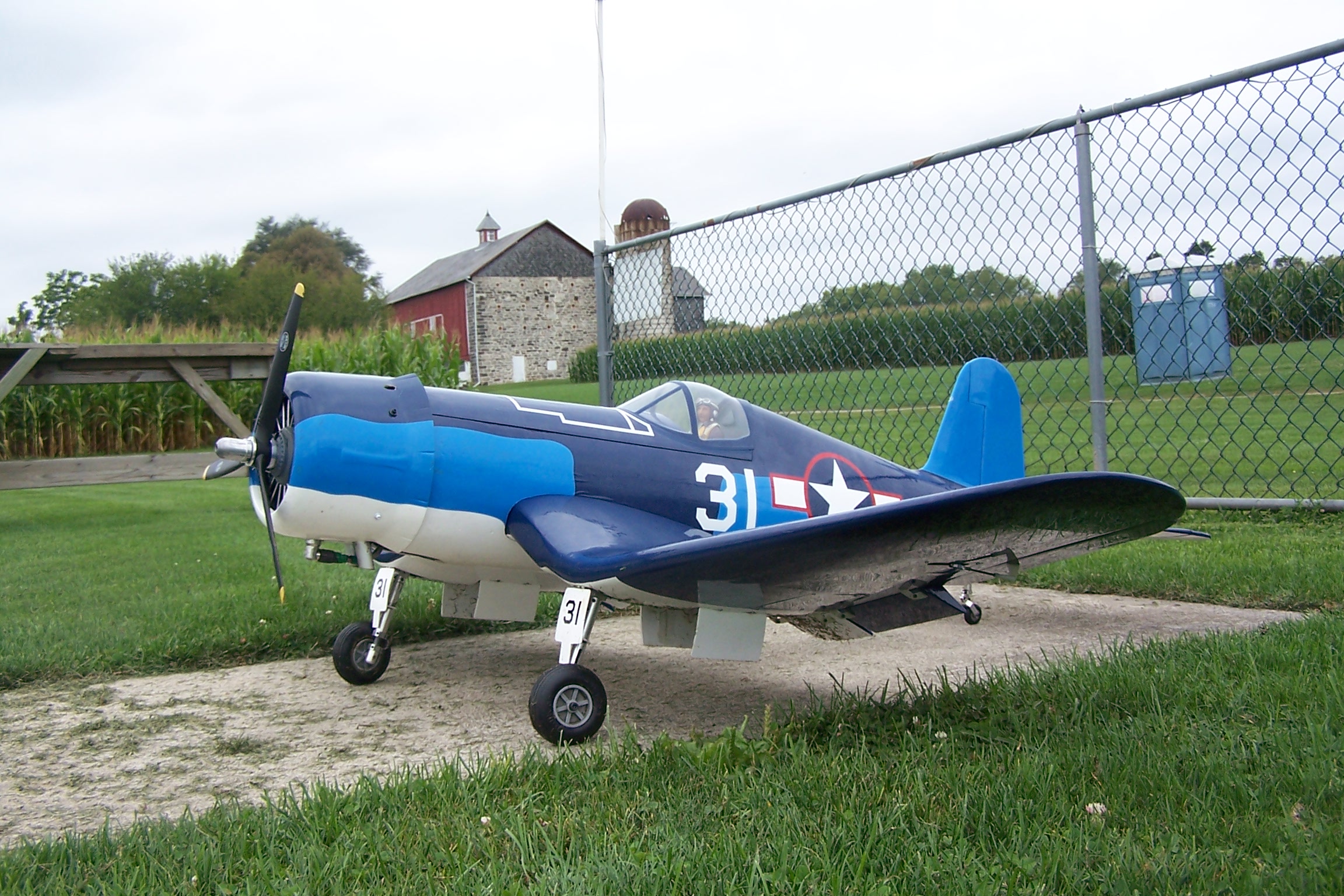

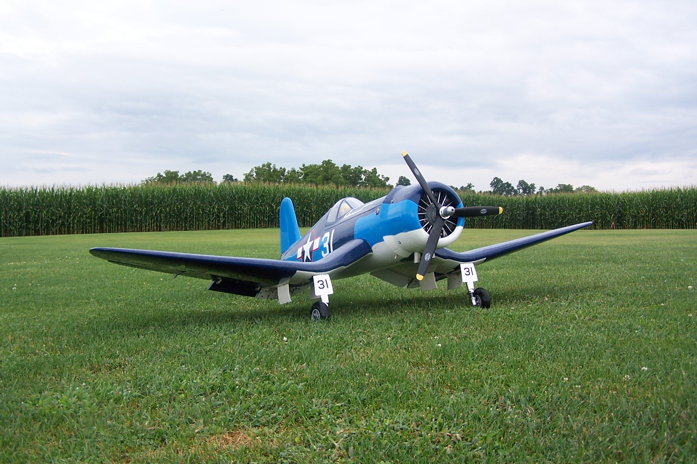

The Corsair is a Koyosho ARF, 71" wingspan. DLE 20 with compact pitts muffler from J-Tec. Turns about 7,100 rpm. The Tony (KI-61) is a Flite Models ARF, 71" wingspan.Carb cooling was a real problem but finally got it sorted out. Took some careful baffling, air ducts and cowl flap. The plane flies great but I believe no longer available. From Hobby King. The P-40 is Top Flite 60 size ARF. Unfortunately no long available. The plane flies good with no bad problems. This DLE 20 has a "Bowman Ring" (he is now retired). and Bowman treatment re the reed valves. This involves honing the surface of the reed valve block to get a better seal. The engine starts easy, idles good and runs great. I think I'm getting about 7,500 rpm. This on also has a compact pitts muffler.

Is the Kyosho Corsair still available?

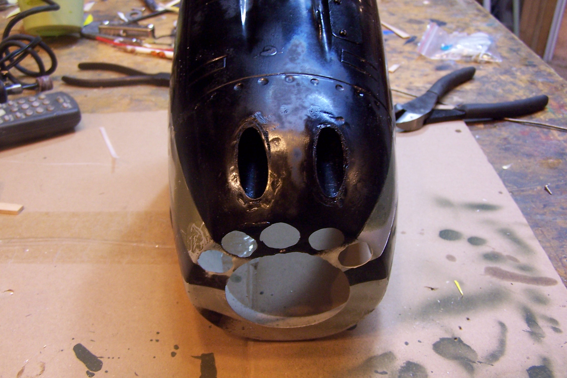

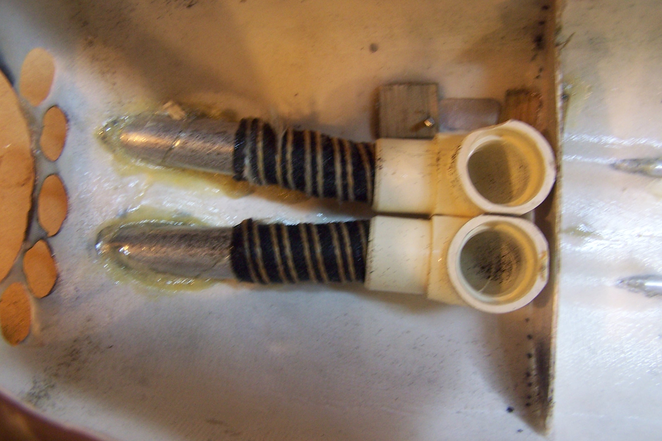

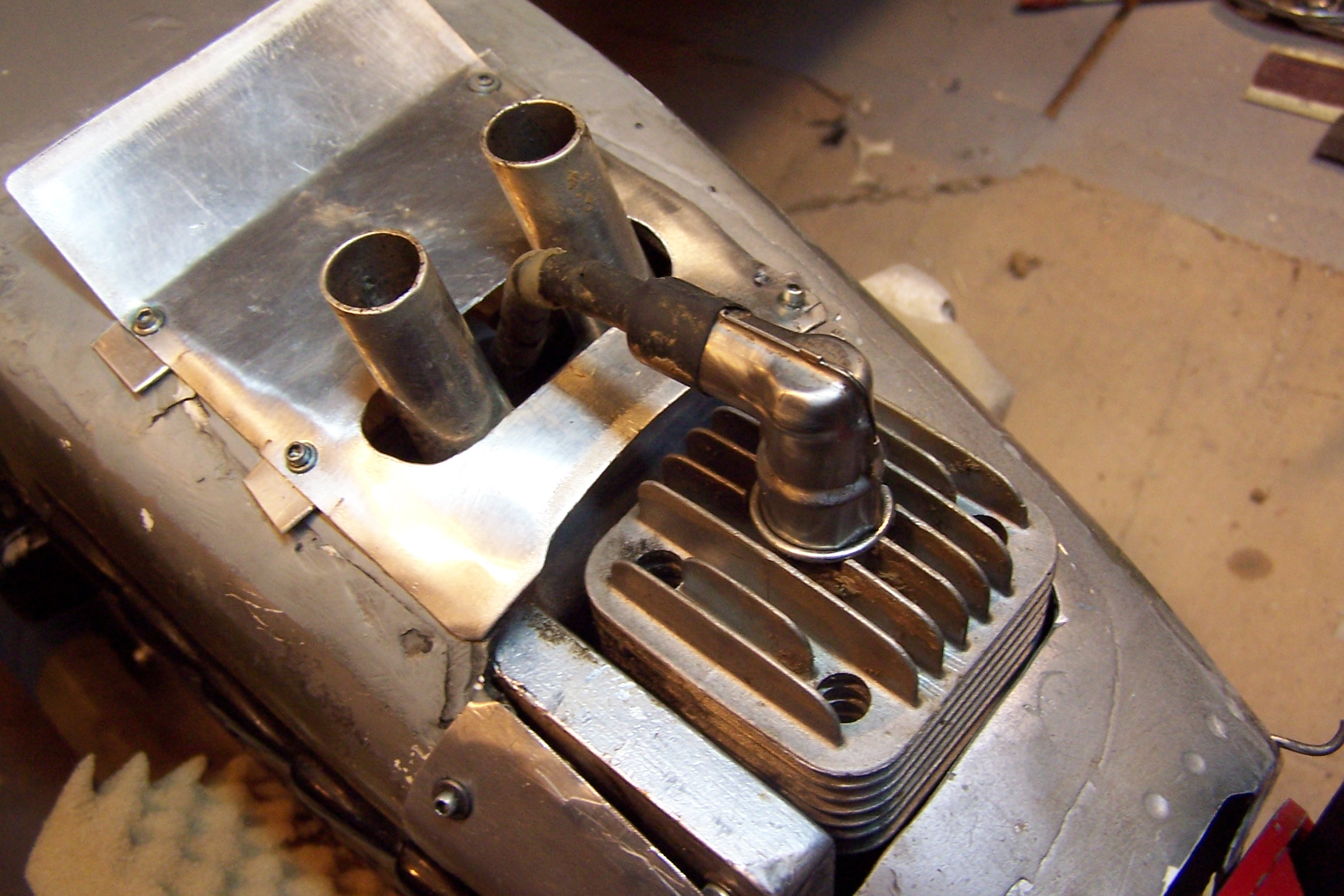

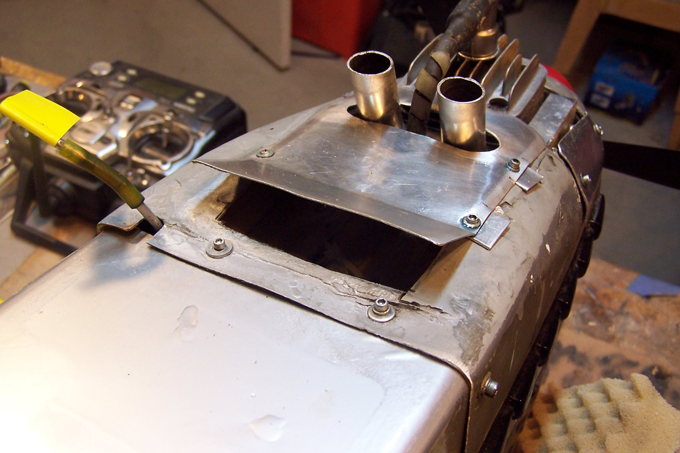

With the Tony, because of the tight cowl, I was getting vapor lock in the carb causing all kind of problems, engine out, lean running etc. because of the carb setting right above the muffler can of the pitts muffler. Finally put in the "blast tubes" ducting cooling air to just above the carb and the cowl flap to help remove the cooling air. Seems to work as I have had no problems since.
On the P-40 I also ducted air back to the carb. This was easier because of the top scoop. Notice I opened up the cowl flaps. Not sure if all this was necessary on the P-40, but certainly didn't hurt.

Yes the Kyosho is still available, go to their website. The ARF goes together will and has some nice flaps already installed. It also has gear doors, but I had to redo the operating mechanism. It comes with metal rotating air retracts which have obtained mixed reviews. I couldn't keep mine working and replaced them with Robart air retracts. Others have reported no problems with the kit retracts.
I love the blast tubes mod, excellent work sir!
