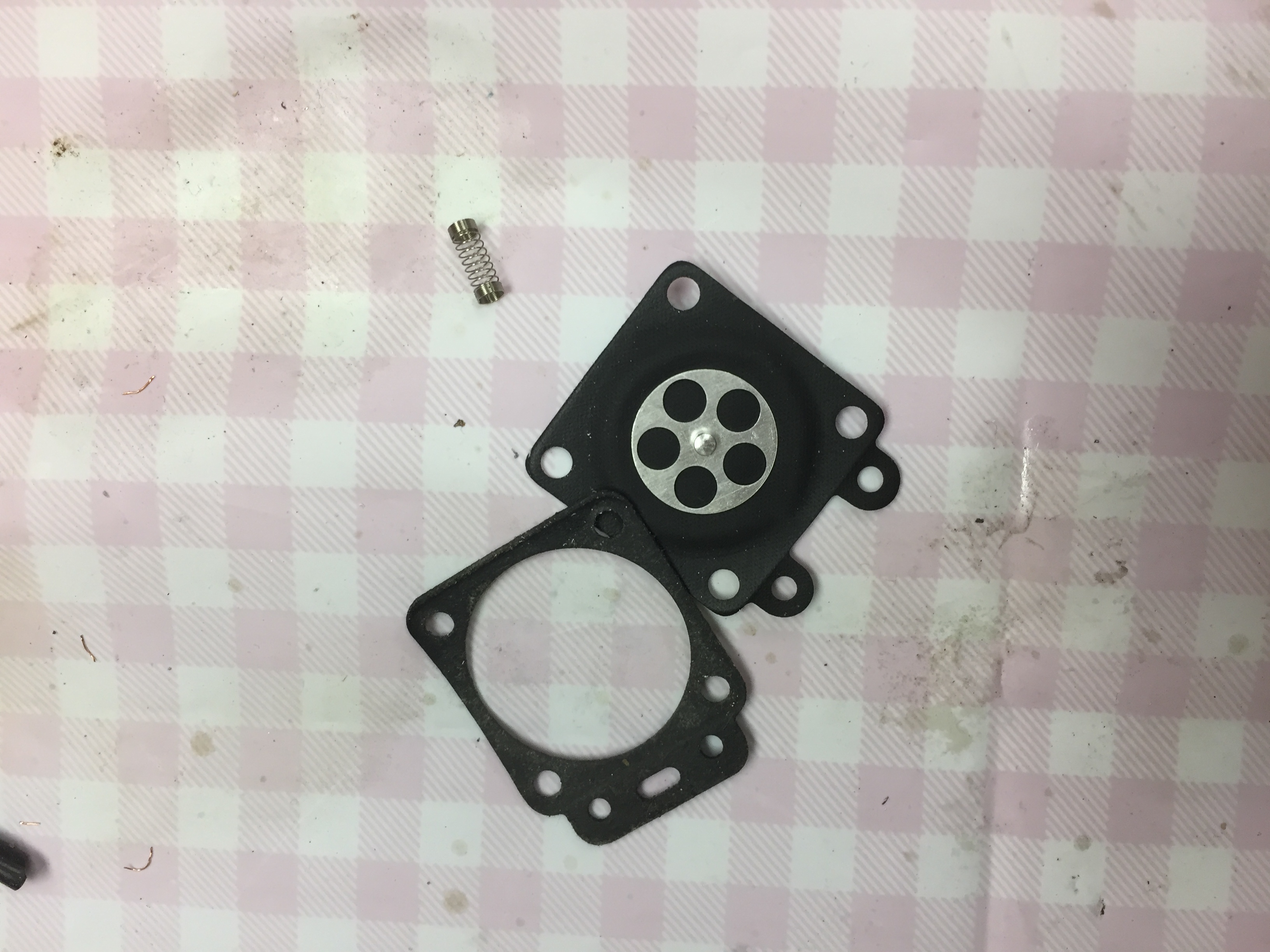

#6849
Joined: Mar 2013
Posts: 78
From: , OH
So the carb kit came and I started replacing items. I thought maybe it might be this stuff because the new spring was longer so for some reason I thought the old one might be wore out. However once I put it back together and back in the plane it would start and run fast then die when I reduced the throttle...and after it started once it just flooded out and would have to sit (then do the same thing).
Since it was getting tons of fuel and flooding I thought maybe the spring was too long. So I dug the old one out of a trash can with cigarettes and shiz in it then proceeded to lose it 30 seconds later so I ordered a Walbro carb. Ha ha
years of making gas engines they still cant get it from the factory
