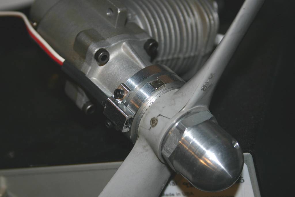

Use whatever you can get. I use flat magnets epoxied into a slot in the hub.

Just got done cutting more grass...I wish it would stop growing! I left the computer running again. What is the engine you have in the photo? Looks nice &amp; is that a square magnet? Where do you get them? Thanks Capt,n

The engine in the picture is an Enya 46-4C. The magnet is 5x4x1mm. I buy mine at http://www.supermagnetman.com/ A thicker one may give you more distance to the sensor.
