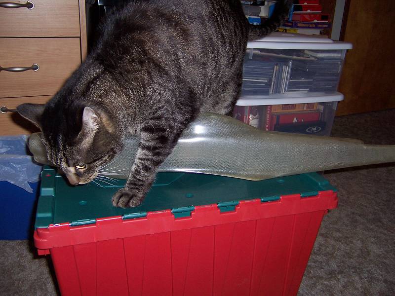

I just purchases this fuselage.
No idea what it is.
Dimensions:
Length: 32 1/4 In.
Width: 2 7/8 In. (4 In. at the wing fillets)
the glass work is PERFECT!
And yes, my cat Tom Tom, aka "Bubba" really is that big!
Thanks for the help guys!

A couple more pics

OK Bubba,
What I think you have there is a 1972 Pro-Model Products 1/4 Midget Mustang. It was designed and flown by Bill Weesner, and the glass rights were reserved by JOMAR. It had a 37 1/2" wingspan and an area of 308^2. Designed to be powered by a K&B .15 using Kraft KPS-10 servos. That takes ya back.

I agree!
Here's a couple paint schemes for ya if yer deciden to paint er' up!

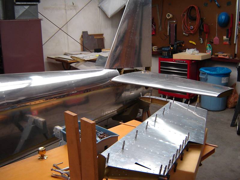

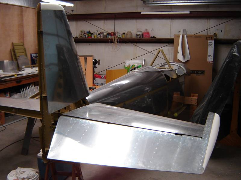

I am a full scale mechanic and have been working with composites for 16 years.
I can fit any airfoil to the fuselage. That won't be a problem.
Also, I specialize in very high end paint jobs on real planes.
This is great. You see, another hobby....Van's RV-4 180 hp Lycoming 210 mph redline, and power enough to do it.

Sweet! I LOVE VAN'S RV's!!!!!!!!!!
You should get 190 MPH at 85% Power, unless you bring it to me, then you'll get 200HP and 200 MPH @ 75% Power!
I completely rebuilt and painted one a few years ago. N511MG
I'll try to post som pics for you.
It cost nearly $40,000.00 for my refurbishment.
Wich included a new Inst. panel w/Garmin 430, dual Lightspeed Ignition(a MUST have), Rework all the fiberglass parts, Nav lights, and 5 color paint.
Boy, I miss that plane. nothing flys like an RV. the 4 is the easiest handling tail dragger I have ever flown, including Cubs, Champs, Pitts and an Extra.

I'm looking forward to completion. Working on the left elevator w/ trim tab right now, so I can finish the elevator pushrod from the bellcrank back. Then I have to make the tail intersection fairing since the factory part is a really poor fit.
Dave Anders built a modified 4 that did close to 250 mph with a hopped up 360 engine. I think he was pushing about 230-240 hp to do it. I plan on cruising at about 65% power at around 190 mph true (indicated speed will be much less) at 10,000 feet.
Do you have any pictures of your panel, as that is in the heavy planning stage right now. I thinking a standard 6 pack, Trutrak, and King. Trouble is in fitting in an engine monitoring system too, like a Vision Microsystem.
