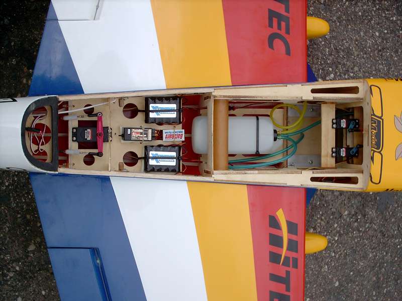

I crossed mine on the Edge. If I didn't, they rubbed the front of the slot pretty good. By crossing them, they lined up much better. Will definately keep an eye on them rubbing each other though. My arm is only 2 1/2" though, so this may have something to do with it.

If you're going to cross them, I'd use Dubro Swivel links at the servo arms.
One side on top of the servo arm and the other side of the servo arm should
be located underneath to prevent cables rubbing each other.

Yes I did, with the HD swivel ball links on the servo end and clevises on the control surface. Using Hitec 5945's and have had no problems with over 200 flights. I'm using the 2 1/2" arm that comes with these servos for the pull-pull on rudder with swivel ball links also. I just turned one of the SBL over to the under side of the arm so my cables wouldn't rub since I crossed them. Worked real well, probably 1/4" clearance now.

Crossed the pull-pull set up in my plane for a better fit.
Items used are listed below.
http://www.airwildpilotshop.com/More...=product&id=90
http://www.airwildpilotshop.com/More...product&id=377
http://www.airwildpilotshop.com/More...product&id=162
http://www.swbmfg.com/
Mounted one cable above, the other below the arm also.
