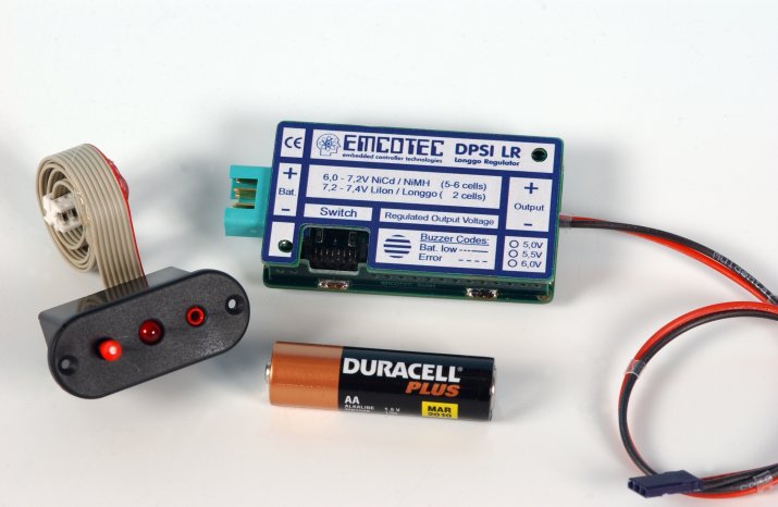

Anyone got experience of the Emcotec DPSI Regulator? Pretty expensive but looks really good....
Regulator, Failsafe switch, 15min continuous current 3Amp, 30Amp peak for 5sec, audible alarm for low voltage, visible alarm for low voltage and no current draw when switched off meaning you don't have to remember to unplug your batteries if you're not going to be flying for a few days.

Top of the line, state of the art, the highest quality available, what more can I say.
The manufacturer has the DPSI as a sideline product, because he's a modeller.
For serious business they manufacture sensors for the auto industry. Airbag sensors e.g.
This means that they have the best manufacturing equipment, and do understand the neccessity of quality control.
You do want your airbag to pop when you crash your car, don't you ? (but not at any other occasion).
Also they deliver some parts to the Mercedes Formula 1 Racing team.

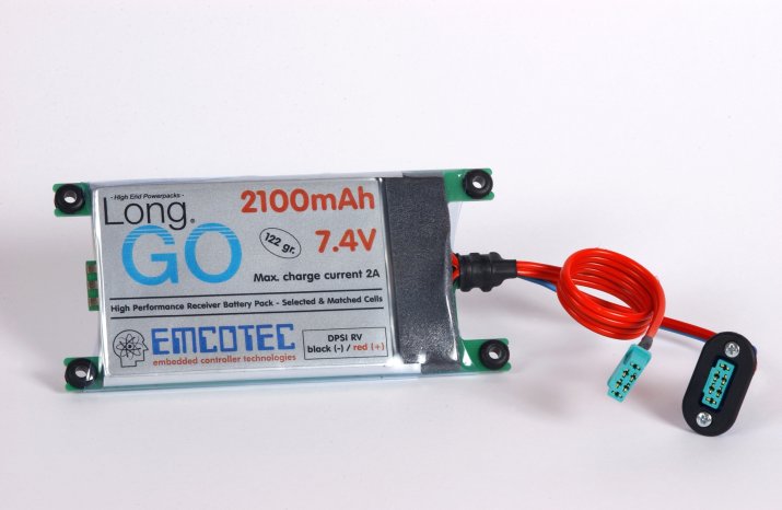

Dave, regarding the lead/charge lead, I will probably opt for one of their LongGo LiPo packs that come pre-wired with a charge lead as per pic.....
Rgds,

Copied from the Emcotec manual:
Because the distribution voltage is switched on electronically (the
switch does not activate any current, but rather only the switch-on
signal), no losses, contact errors or transition resistance occur. This
internal electronic switch is fail-safe. Thus, a switched-on “DPSI RV /
RV Mini“ remains switched on even if, for example, the On/Off switch
is separated or interrupted.
I believe that if this works as advertised then it would qualify as a "fail safe" switching method.
