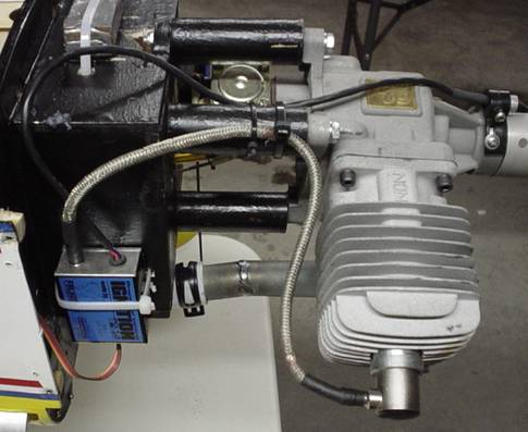

Default Edge & zdz 80 mount, What do you think
Ok Guys heres my motor mount, I turned these mounts on a lathe and now would like your opinions.
Do you think it will put excessive strain on the firewall?
I plan on beefing up the support of the wall.
Any commets are welcome, good or bad, Thanks.
v/r gordy

Old 03-20-2003 | 07:16 AM
  #138
akflyer's Avatar
My Feedback: (7)
Posts: 584
From: Soldotna, AK
Default Another 540 Edge Thread
Wish mine looked that good. I just used 3/4" dowels and drilled the center and through bolted. Your looks way cooler, and adds a great custom touch.

Old 03-21-2003 | 12:56 AM
  #140
Posts: 50
From: Cabot, AR,
Akflyer: Thanks for the responce. How did you brace the firewall,did you use tri-stock? I'm thinking og using 3/4 sq. hardwood so I have plenty put dowel pin into. Any problems assoc. with the engine being on the standoffs? Thanks for posting your picture, its nice to see somebody else has the same ideas.
v/r gordy

Posts: 584
From: Soldotna, AK
BigBird,
The dowels are in use all over the country and I have not read one post of a failure. My first one took on a half a dozen pine trees at full throttle and, while the plane lost the battle, the firewall and stand offs were unscathed. We have three of them built the same here and no sign of trouble on any of them. My buddy has his ZDZ 80 in his cap mounted the same way and no problems after 15 gallons.
I used 1/2" spruce triangle and BBQ skewers (bamboo) to pin the firewall.

Akaflyer,
I stand corrected. I have been told in the past that anything over about 1 1/2" would not hold up and that aluminum should b used . I am always up to learning better ways.
