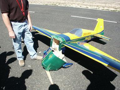

Dang, if the thing would have quite during sequence practice but NO. I looks like the black wire broke at the DA battery plug. This plug provides no strain relief. I thought it was all tied down very well. I don't have before pics so just take my word for it. Good thing is it wasn't moving very fast so damage is mostly the motor box. I have attached some pics. Check your wires!

Bad One

I think the giant scale gods were watching over you today! Can you say LUCKY. Looks like it can be repaired. It's a miracle that the rest of the airframe received so little damage.

Isn't it possible the power wire was broken during the crash, I mean with all the motor box damage it looks like a possibility.
I believe it's rather common for the engine's to quit in hover from over heating. I have seen this happen numerous times. The tune-up is not quite right generally, other times baffling solves the problem.

The ingnition modual and plug was secured to the motor box. This area stayed together. It was baffled. I have hovered many hours before with no trouble.
