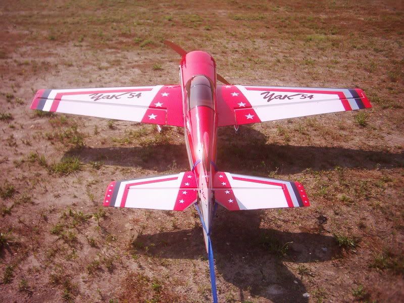

My CG is about 7 3/8 or maybe 7 1/2" measured from leading edge of wing, as the manual instructs. I saw the video of BosshossV8's maiden, but the video stopped before the landing. Looked to fly fine at whatever the CG is. If it's 8 1/2 inches back .. that's crazy. .. but if it works , it works.

From what I can tell from measuring and looking the CG is about centered on the wing tube and the if you follow that line out to the wing tip it ends up being right at the edge of the cutout for the counterbalance. easy to balance. I did my 50 cc plane like that and it came out great.
I will set mine up so it just balances with a full tank and that will allow me to land light in the tail as I like for the good 3 pointers with minimal roll out

I always tie string to my wing tubes on both sides, then place the wings on and pick up the plane by the srting. I check the balance dry and arrange batteries ect untill the plane balances on the tube. After the maiden, I tweak the balance accordingly. This method has yet to fail me.

Hi, I'm in the process of balancing my Yak but I'm a little confused-cocerned about the location of the balance point. The manual for the 94" Yak says to balance it at 6 7/8 - 7 1/4 in. A couple of the guys in this thread have said it needs to be back further. I went to the Yak 87" manuel and it also says 6 7/8 - 7 1/4 in. In fact, the two manuals are seem to mostly apply to the 87" ,Yak. Need help here. Thanks

I'd Balance it on the center of the wing tube and fly it and then make changes to suite your flying style and preferences

Well, I could probably mathematically figure out the exact balance point of the 94" based on the information from the 87". What I do know without any doubt though ... is that if the rearward balance point of the smaller Yak is 7 1/4" measured from the leading edge, .... its certainly not going to be the same 7 1/4" for a version of that same model that has been blown up to a larger size. I now am personally comfortable with a 7.75 -8" rearward balance point.

Somebody correct me if I'm wrong. I figured the 94" to have a 7% larger span than the 87" version. If I assume that the rest of the model is a proportionate 7% larger, then ... the 7 1/4" rearward balance point could/should .... have 7% added to that figure. With that I come up with 7.79" from leading egde .. or simpler, .. just a little more than 7 3/4" as opposed to the smaller 87" plane's 7 1/4 rearward CG.

Like I posted earlier, and so did aaxis, It really isn't complicated. So why complicate it? The plane will fly if balanced on the tube. There is no "magic" number, for the simple fact that people have different preferences and flying styles. Balance on the tube and work from there. It really is that simple guys.

Mine is currently balanced on the rear edge of the tube. It still needed up elevator trim, just a few clicks. It needs a slight push during inverted , also.
Balanced right on the tube it be well within your trim limits for maiden, don't be suprised you have to stab at the elevator trim right after takeoff.
I will be going a little farther back when the motor is broke in and smooth. The numbers in the manual freaked me out , also.
Anythng forward of the tube may cause you to not have enough trim, be careful.....
