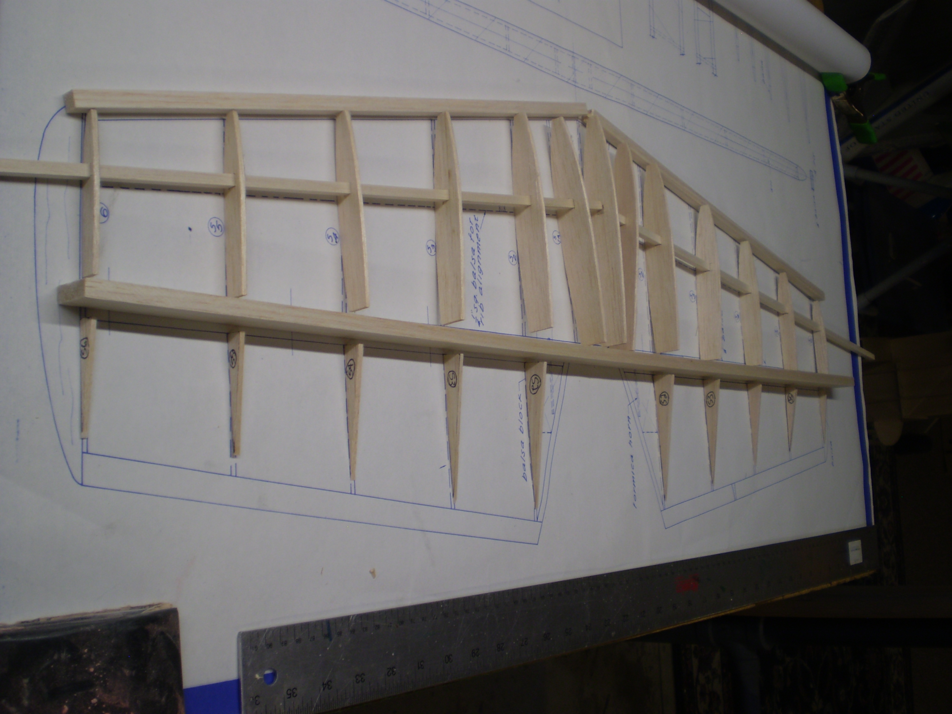

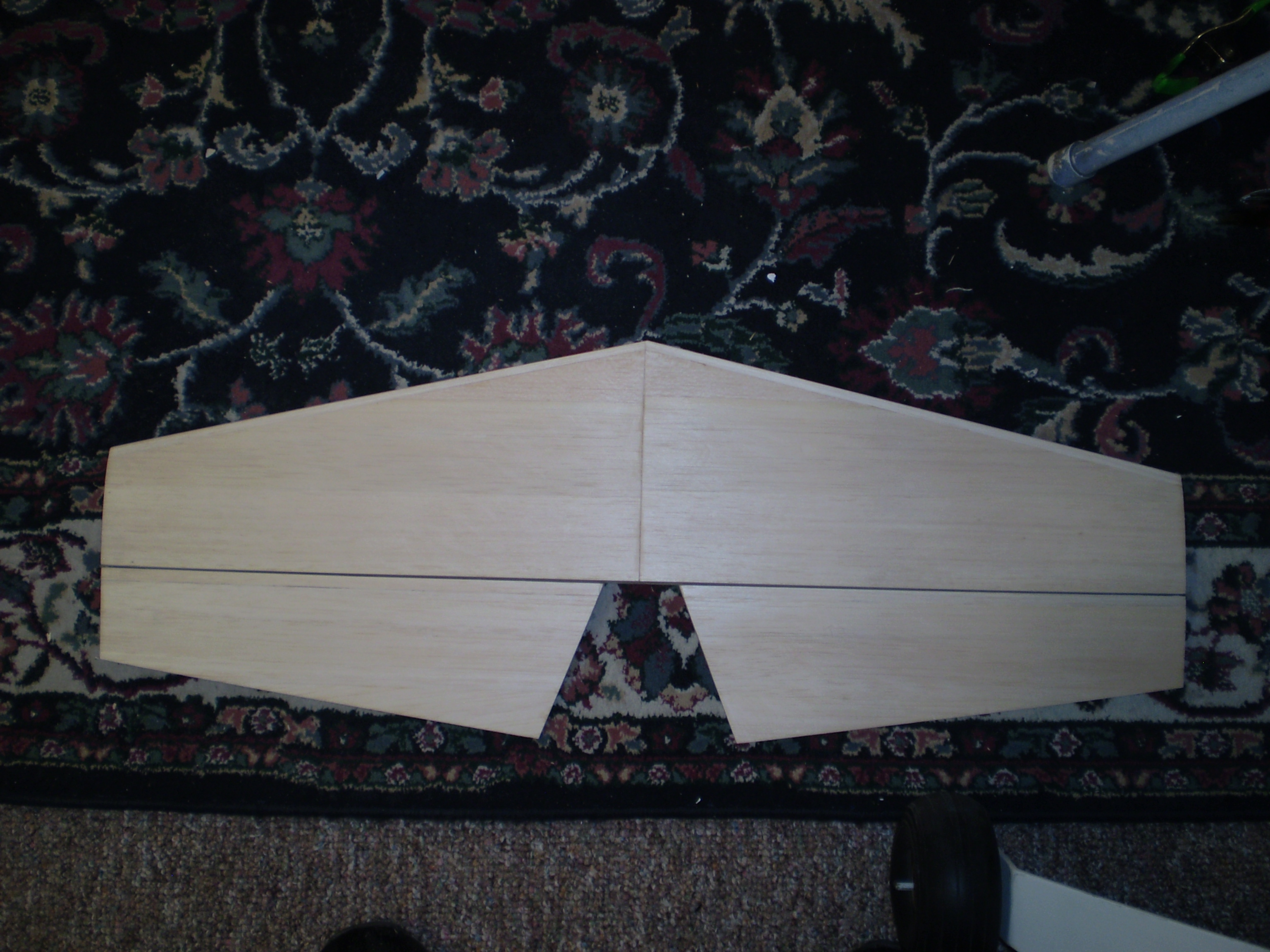

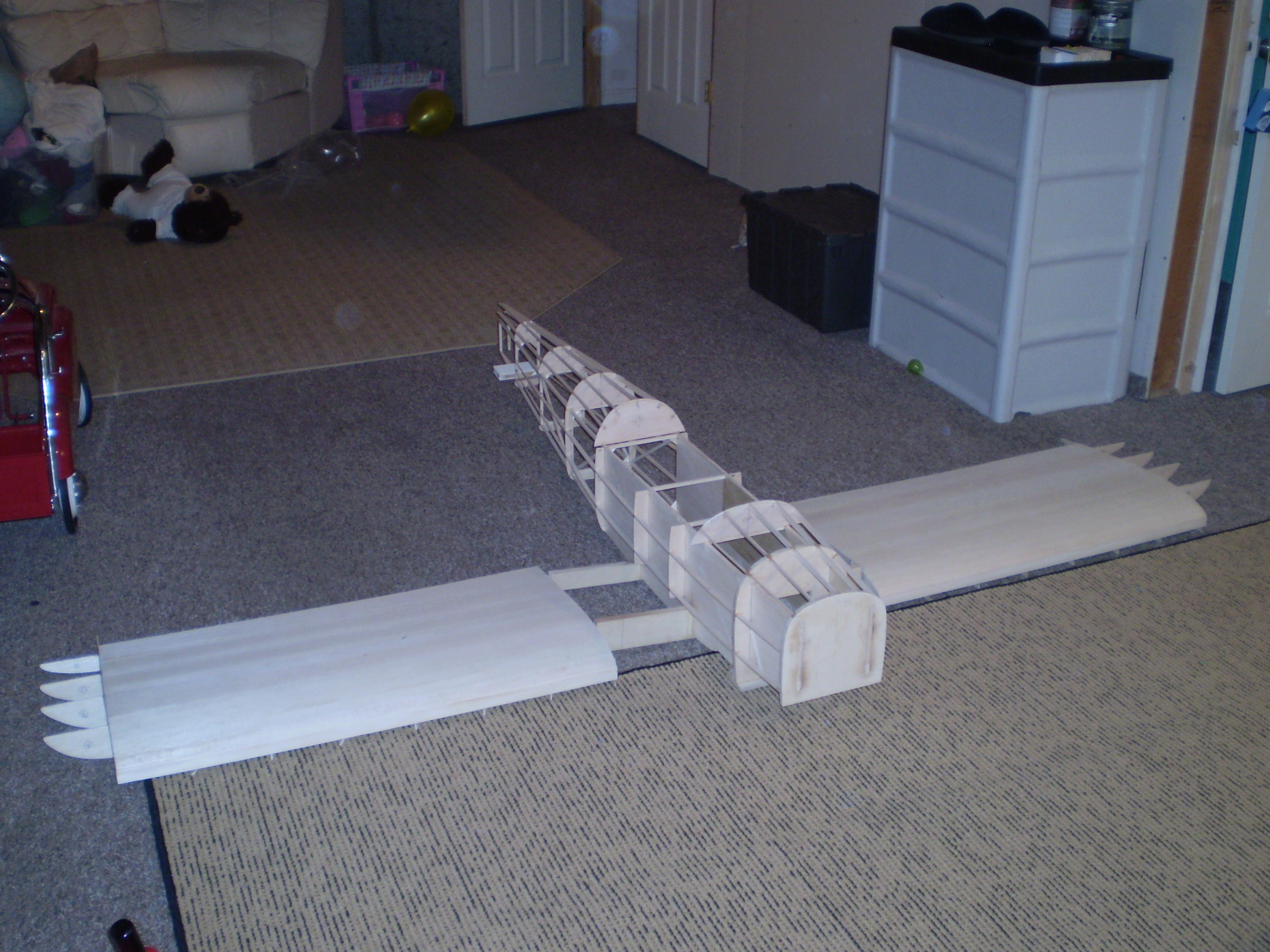

Old 12-16-2014 | 08:13 PM
  #29
My Feedback: (25)
Joined: Jul 2003
Posts: 48
From: HEBER CITY, UT
Quick update. I have been working on one wing half that I have almost completed, just put the top wing skin on tonight.

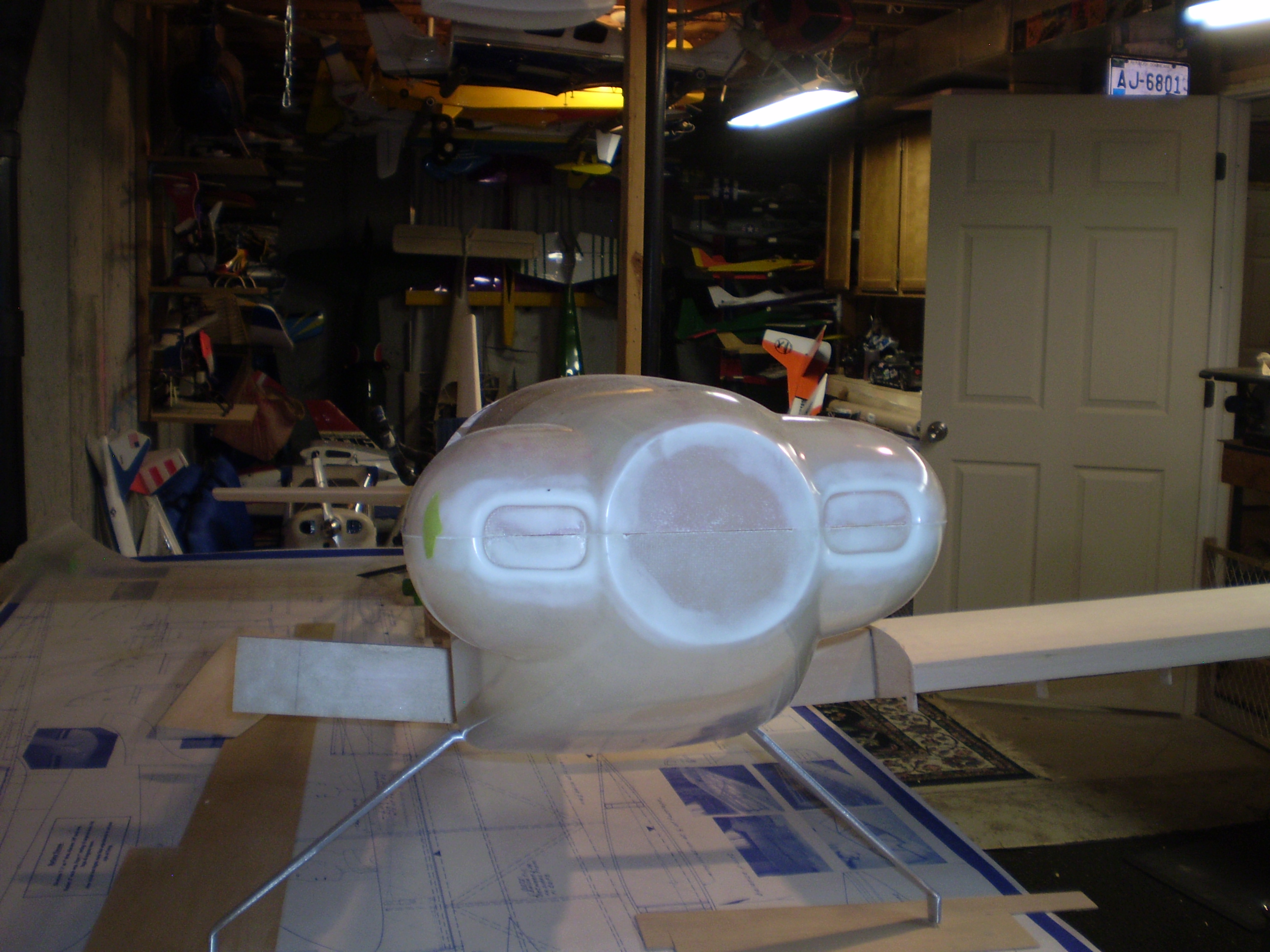

I started working on the cowling today and ran in to a big problem with the mufflers. The plans show modifying the mufflers so they will be fully enclosed but for some reason mine would need a lot of modifying and quite an extra expense. I am using the DLE 60 twin, just like Wendell shows, but the fronts of the mufflers would need to be tapered back quite a bit. As soon as I get it fitted around the mufflers I'll post a photo or two. I am cutting the cowl around the mufflers up front and the cuts will be below the teardrops, in the radius of the teardrops. It's a bummer but I had to do it.
Frank

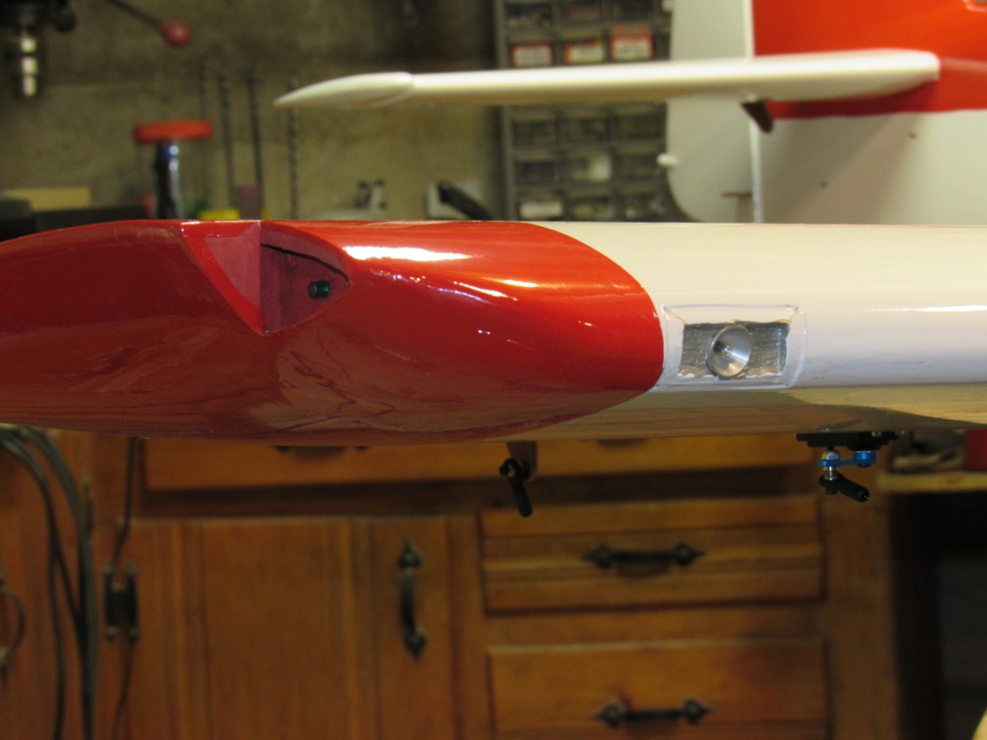

Received 5 Likes on 5 Posts
From: Traverse City, MI
Frank
Frank
I had this done on my 50 twin. It wasn't all that expensive. If it isn't too late, you may want to check prices before cutting up your cowl.

Old 01-02-2015 | 04:49 AM
  #38
Joined: Aug 2002
Posts: 170
From: Washburn, ME

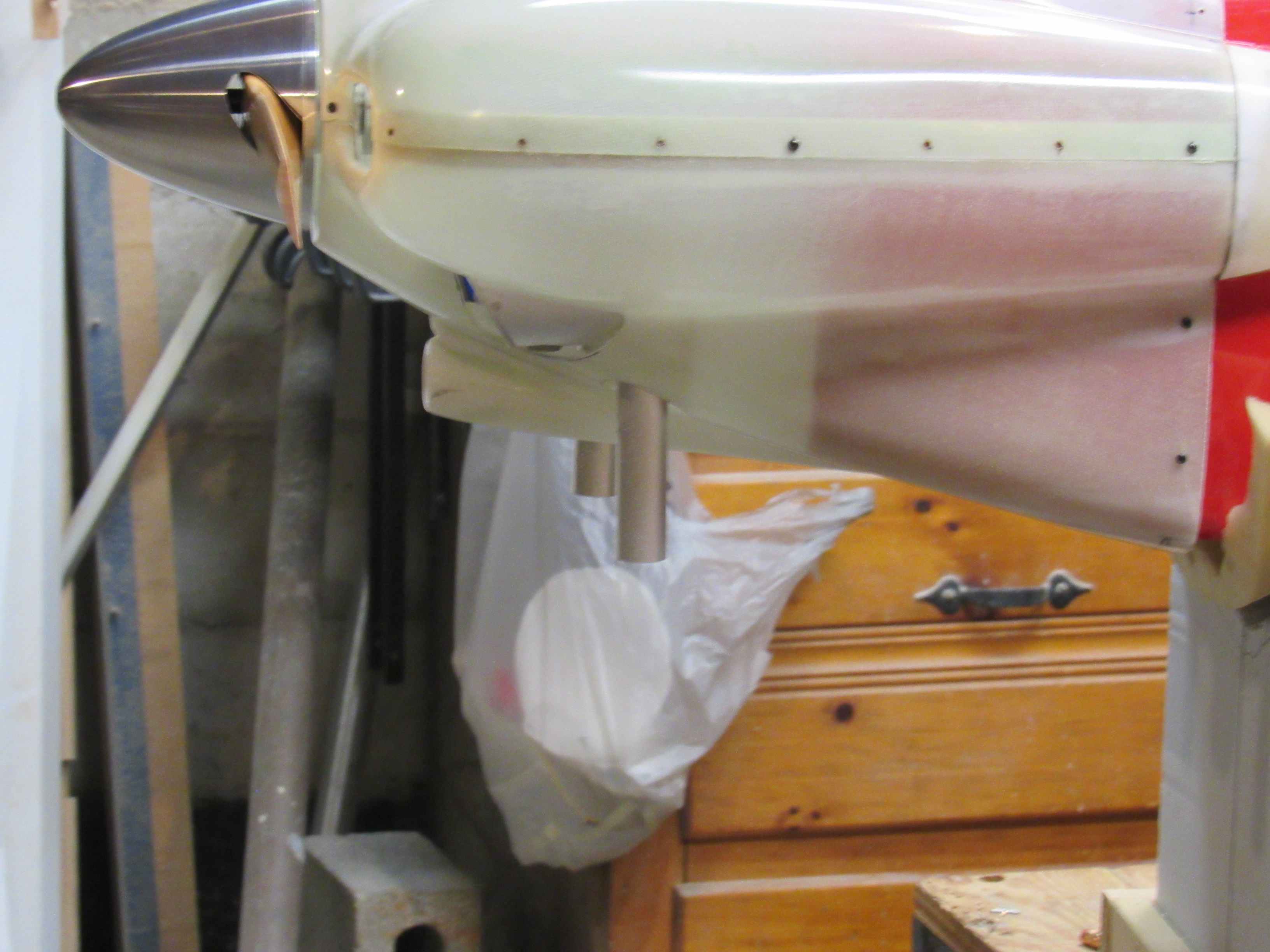

Tom, I had one done for my Mustang and it cost me around $35.00. I figured this would have cost me at least another $100.00 to chop and channel them so I elected to cut the cowling. You can see by these photos that it could be expensive since it would be cutting in to the screw areas and that would need additional welding. I think it will be okay once the cowl is painted and all pictures taken from the top. I do plan on cutting the muffler exhaust pipes two inches shorter.

Old 01-02-2015 | 04:54 AM
  #39
TomCrump's Avatar
Joined: Apr 2003
Posts: 7,614
I paid around $40.00 for the two, but they stopped before the mounting bolts, Frank.
Yours doesn't look bad at all. I wouldn't worry about it.

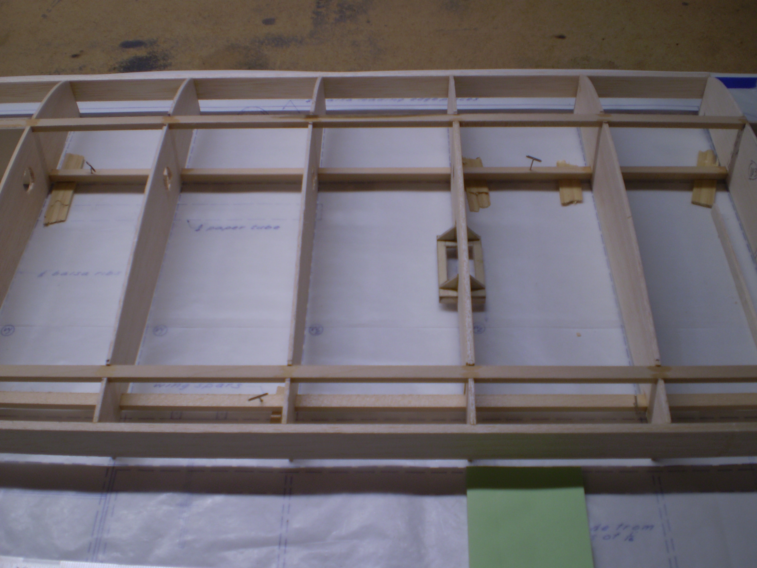

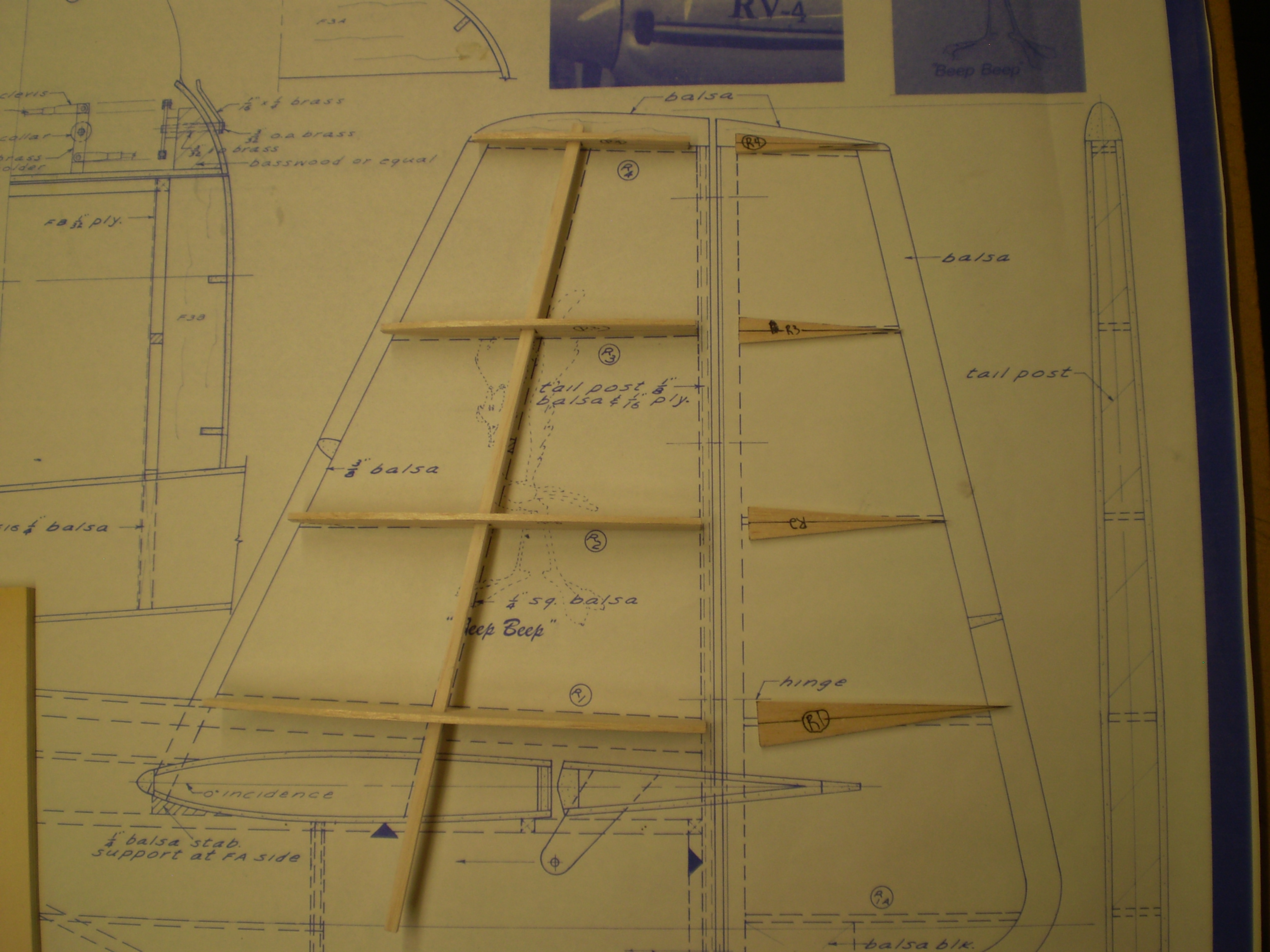

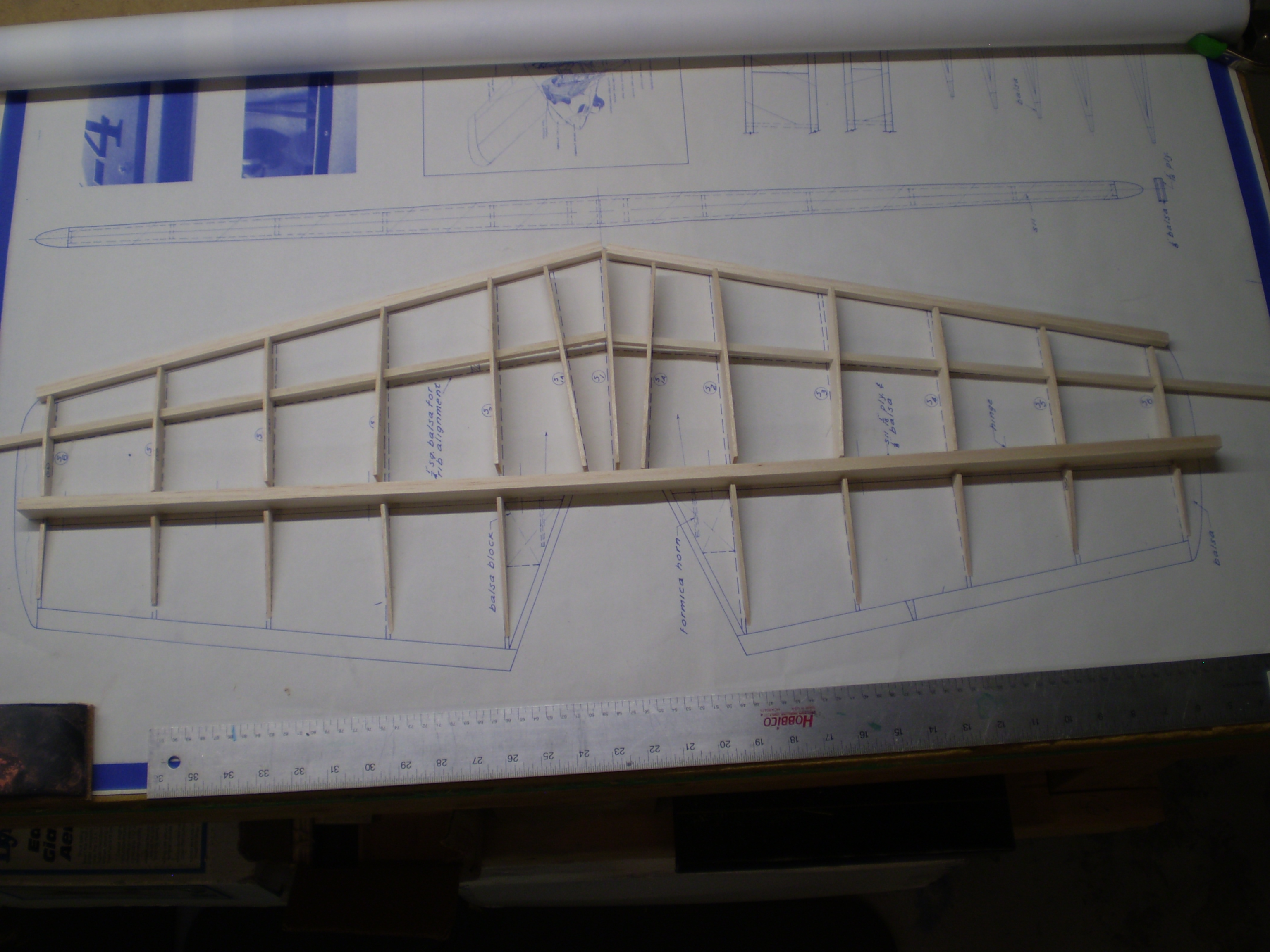

I have been working on the main wings and now have both sides completed. I also have the horizontal stab and elevators done and sheeted. I am currently working on the vertical stabilizer and rudder and hope to have that completed tomorrow. I am hoping to receive my fiberglass parts and landing gear soon.

Frank,
I don't think that looks bad at all , you will never see it from the top.

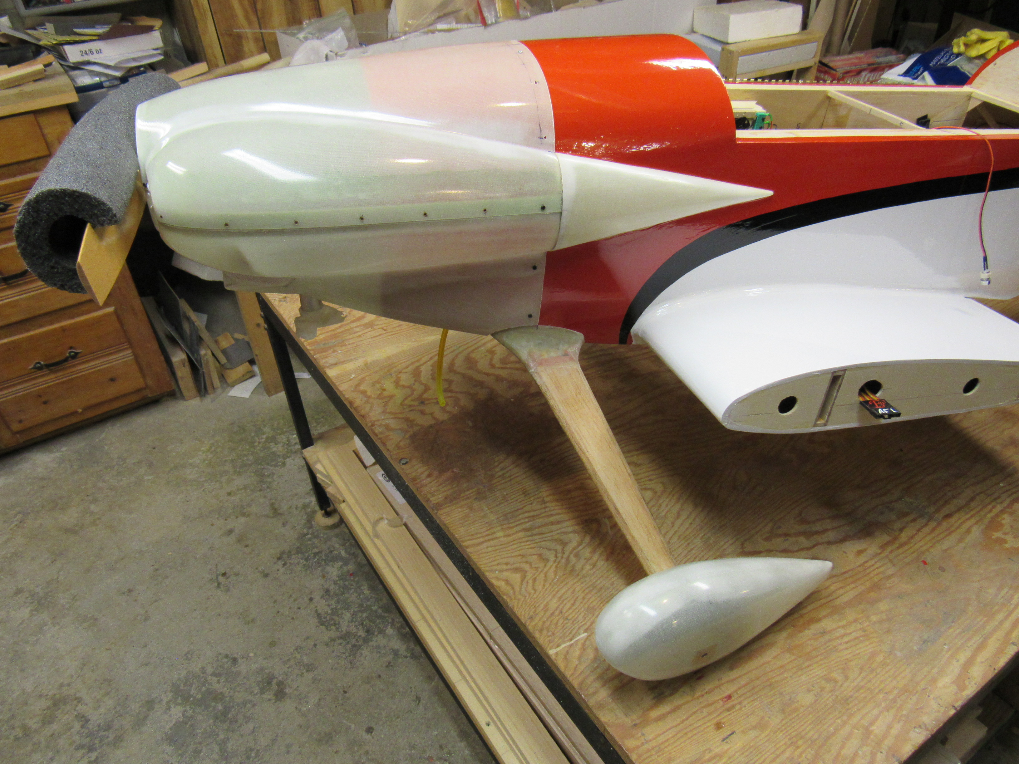

Well here is the landing gear fairing pictures. Took me 2 weeks just to get this far. Can't work on them all the time as I have to many irons in the furnace. I did finish my rudder cables and steering cables today and now I'm almost at a standstill until Spring so I can paint and finish up the small stuff. I can sand some between other projects to get her ready.
Frank

Gorgeous work Frank.
What glue did you use to attach the balsa fairings to the aluminum gear?
Old 02-02-2015 | 06:53 AM
  #47
Joined: Aug 2002
Posts: 170
From: Washburn, ME
I used epoxy to glue the fairings on. I cleaned the gear, a slight rough sand, and put them on. The fairing, gear to fuselage, was done in blue Styrofoam, in two pieces, glued together then glassed with two lightweight and two medium cloths. I then removed the foam with a soldering iron, fitted the fairing and CA'd it to the gear fairing. Now I just need to sand and paint.
Frank

The faring looks great and must take time and patience. Have a question when landing and the aluminum gear flexes will the balsa not snap off or have you done this before and worked if it does I am very interested in this. How thick is the balsa. It must look great.
Old 02-14-2015 | 12:19 AM
  #49
Joined: Aug 2002
Posts: 170
From: Washburn, ME
Snoopy, this is a fairly heavy landing gear made of 1/4 inch 6061-T6 aluminum and is pretty stiff. I hope the 3/16 balsa fairings (shaped) do stay on. I'll know this summer-I hope. My Stinson Reliant had shaped fairings which I applied the same way and the held up okay.
Frank

You may want to considering fiberglassing the fairings as well. Not only will it make the gear slightly more rigid it will protect them during taxi against grass, weeds, etc.
