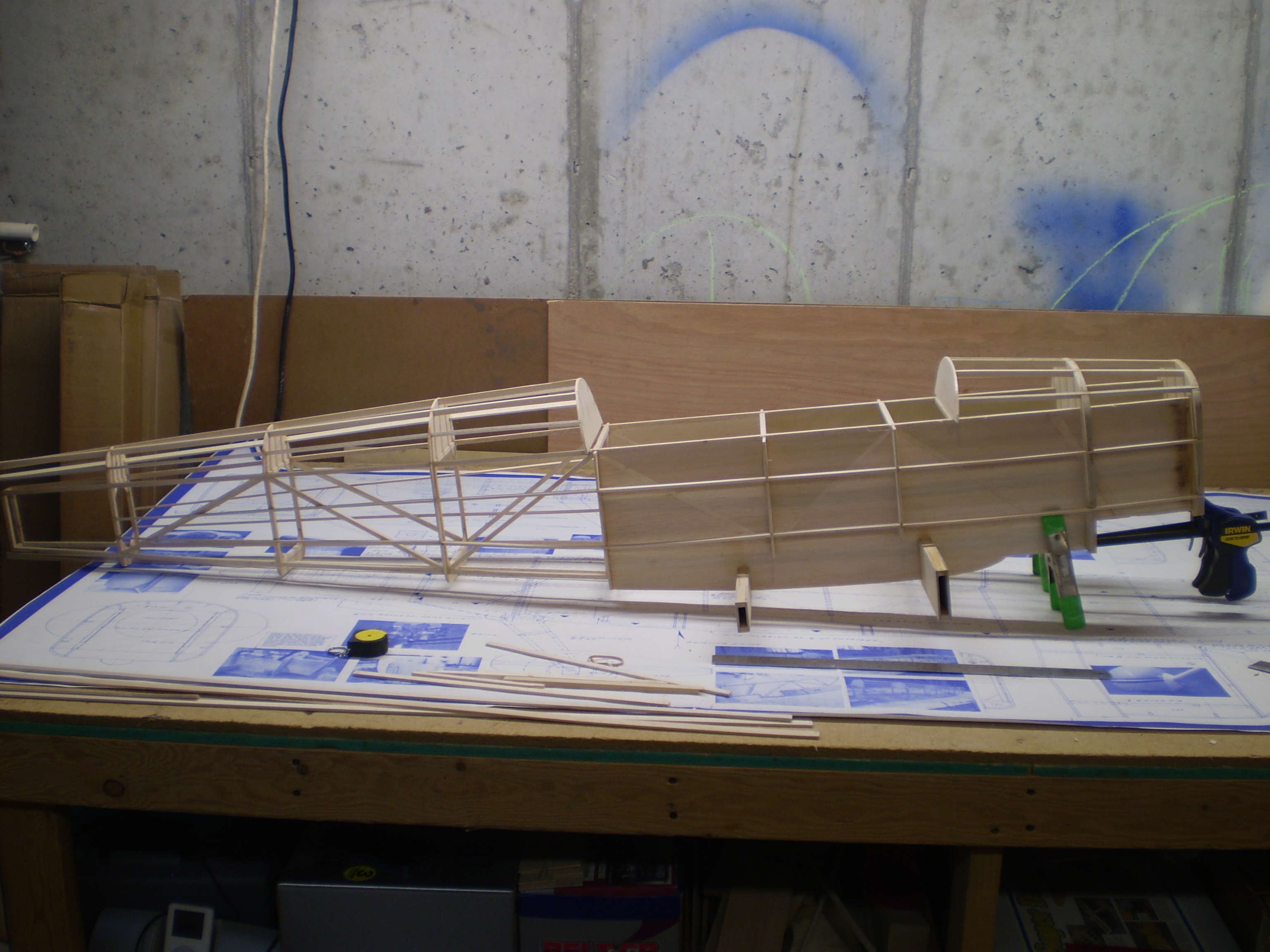

I just happen to be building the RV-4 myself and was looking over your fuselage. You do nice clean work but I see an error which is quite concerning, in my opinion. I see no plywood reinforcement between F-1 and F-5 as outlined on the plan by the dark triangles. This is one area where I think the extra strength is needed. Look close at the sides coming thru the front bulkhead and you will see what I mean. Good luck on the build.

You are correct about the plywood being absent. I took the photos before I had installed the plywood reinforcement but it is installed now and all is good. I would love to see more photos of your plane if you have a few more you would like to share. [email protected]

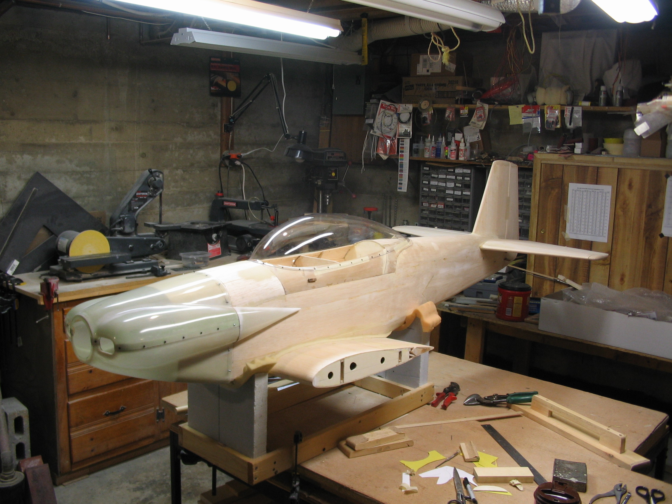

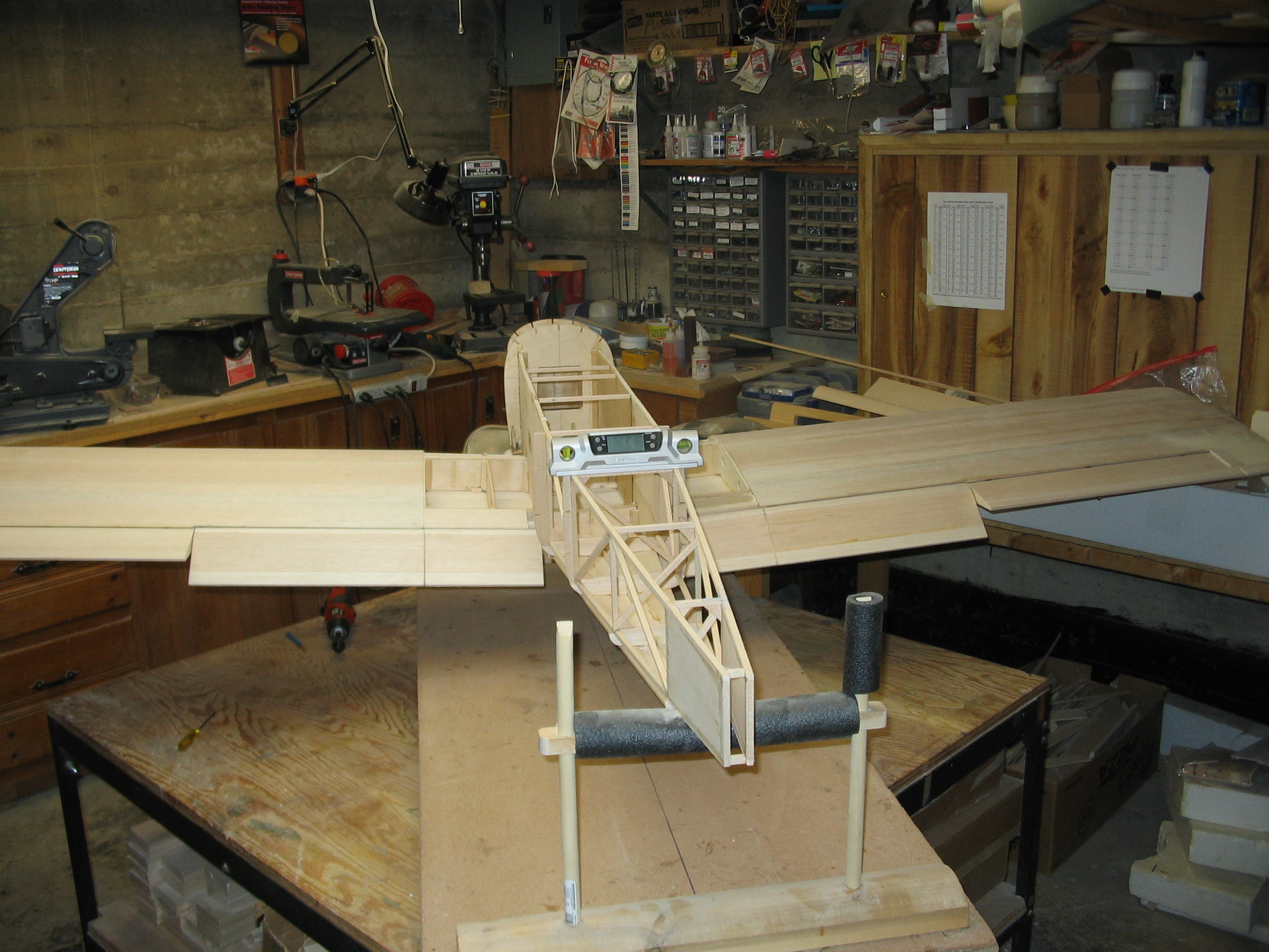

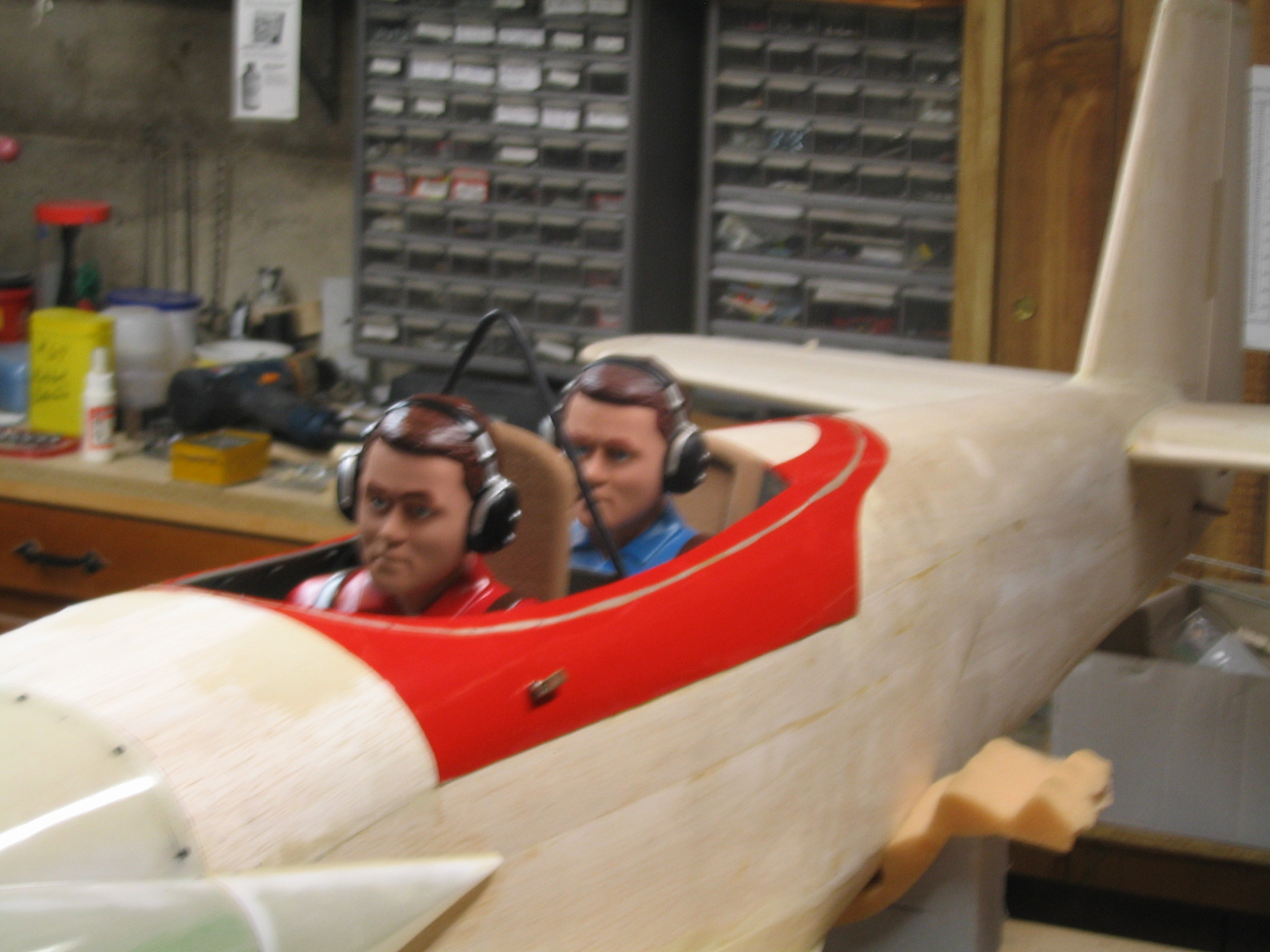

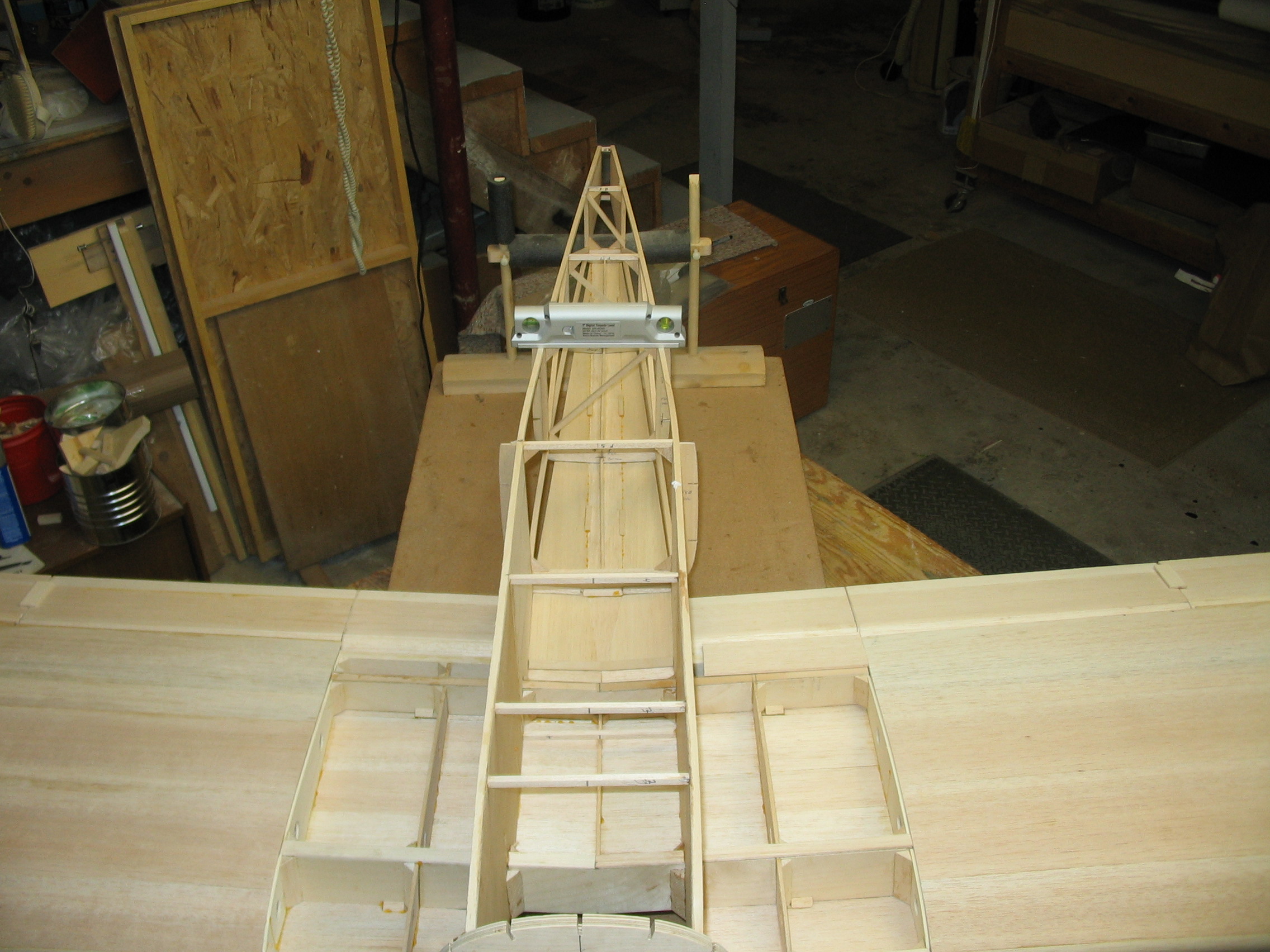

So it has been awhile since I posted progress. I have spent a lot of time cutting out parts but now I have a complete "kit" so things should move along nice. I have a majority of the fuselage framed and have moved on to the wing framing so that I can fit them with the fuselage. I also have ordered the cowl,wheel pants,canopy, and landing gear. It is starting to look like an airplane!

Jperkinstrades, Send me an email and that way I'll have your correct address. Your RV-4 is coming right along and it looks really nice. I'm using monokote for mine and the ironing is going slow. I should have the control surfaces done today though. I need to get my building and repairing of other models done before spring as it looks like I will be doing some home remodeling this spring, summer and fall. I need to replace 8 windows and re-do my pellet stove chimney. May have to hire help to get it done though. Seems like every time I plan on having a summer for flying something else comes up. Here's a picture of MT Stan Lawrences RV-4 out in CA. It's the look I'm going for.
