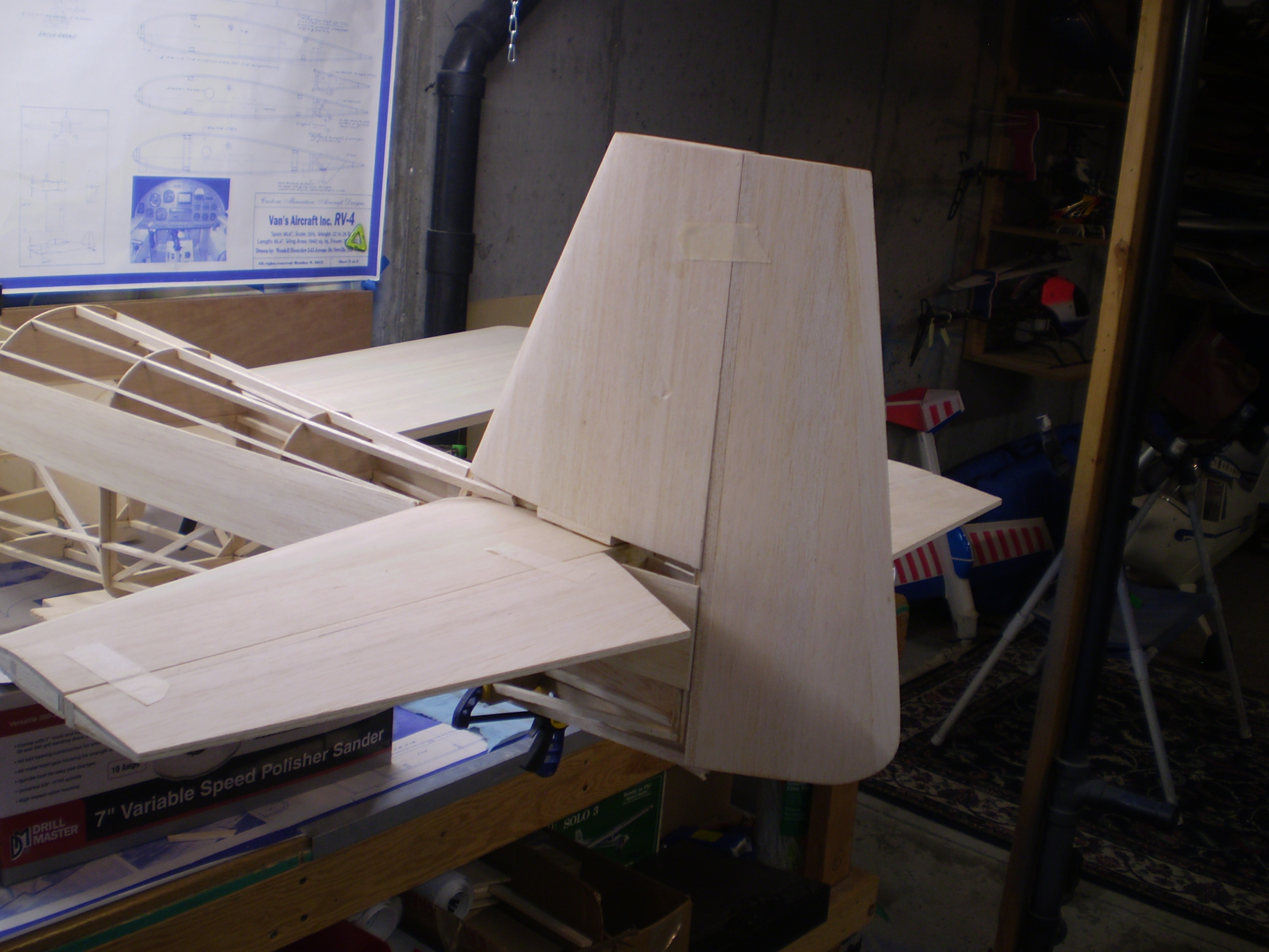

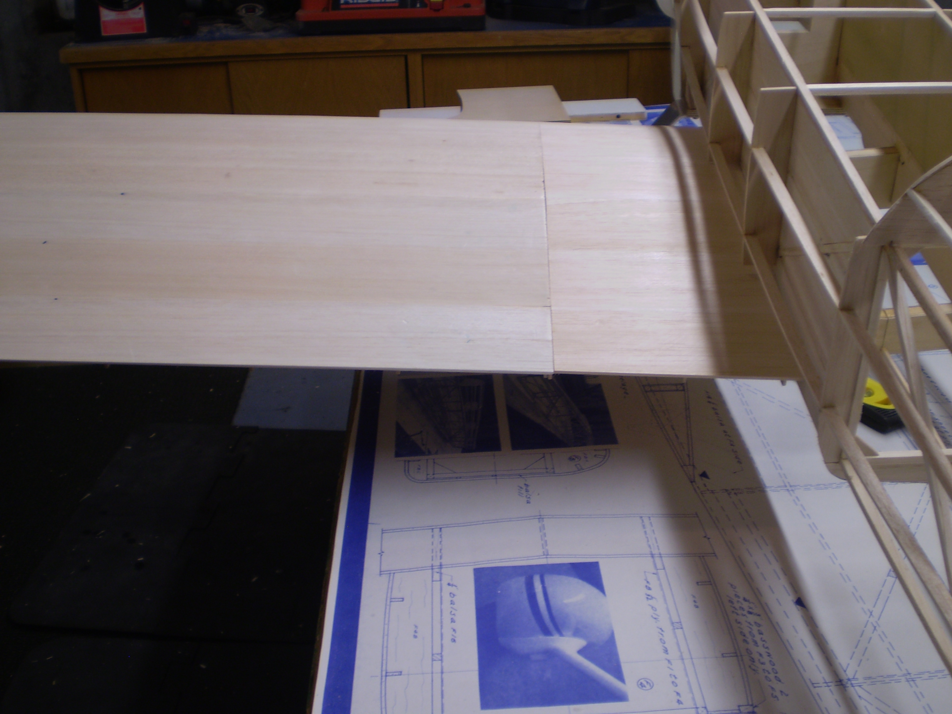

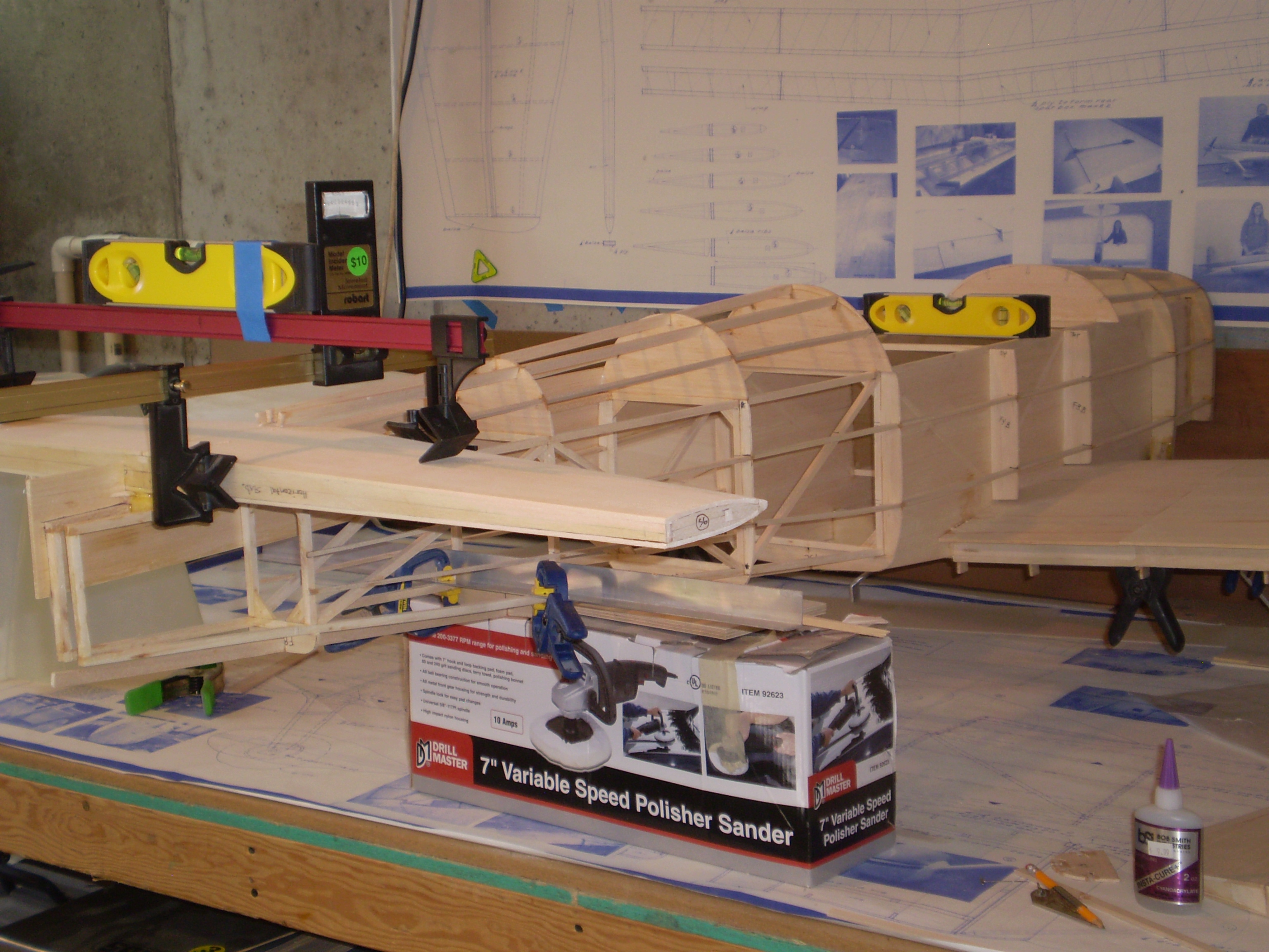

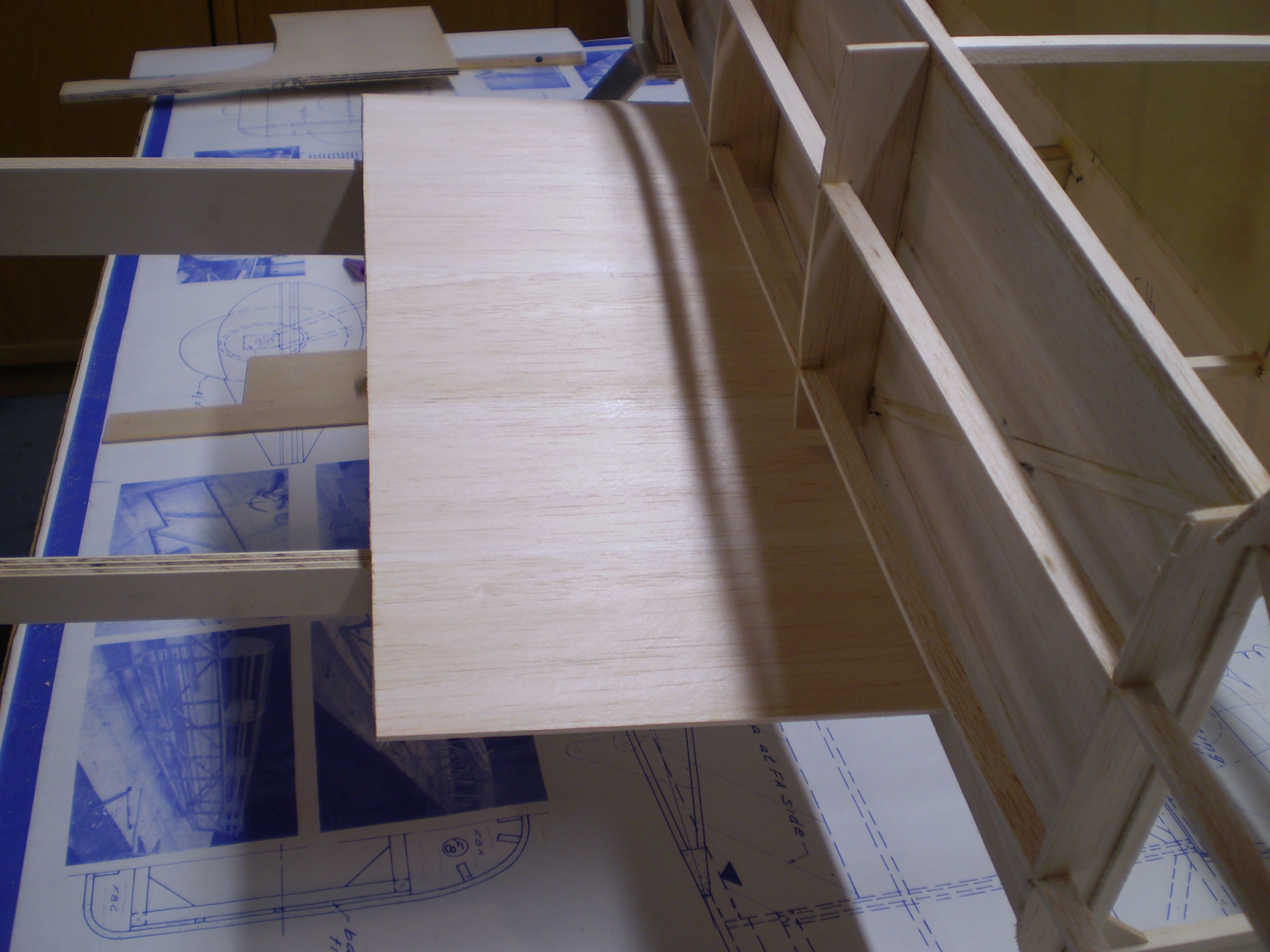

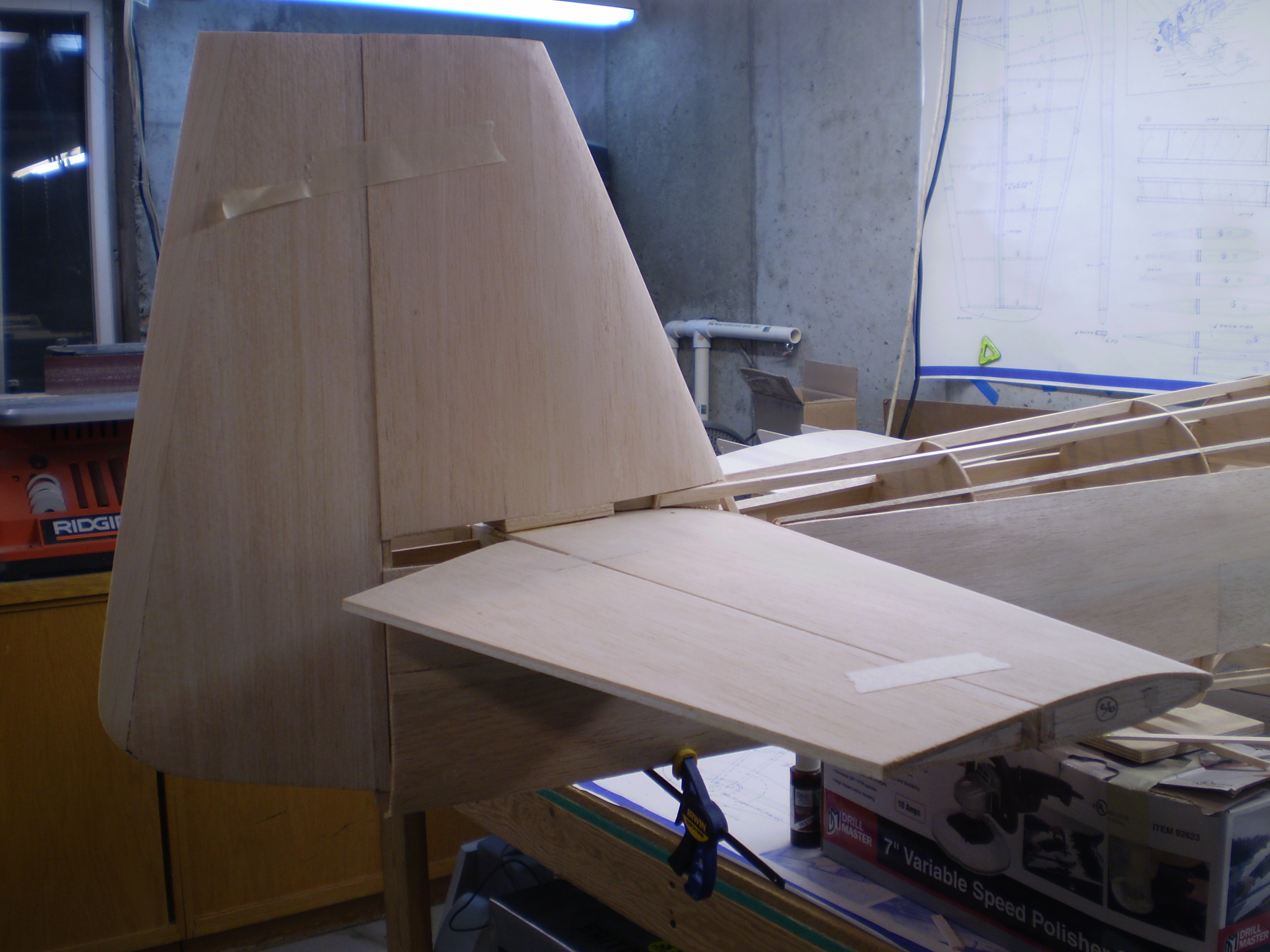

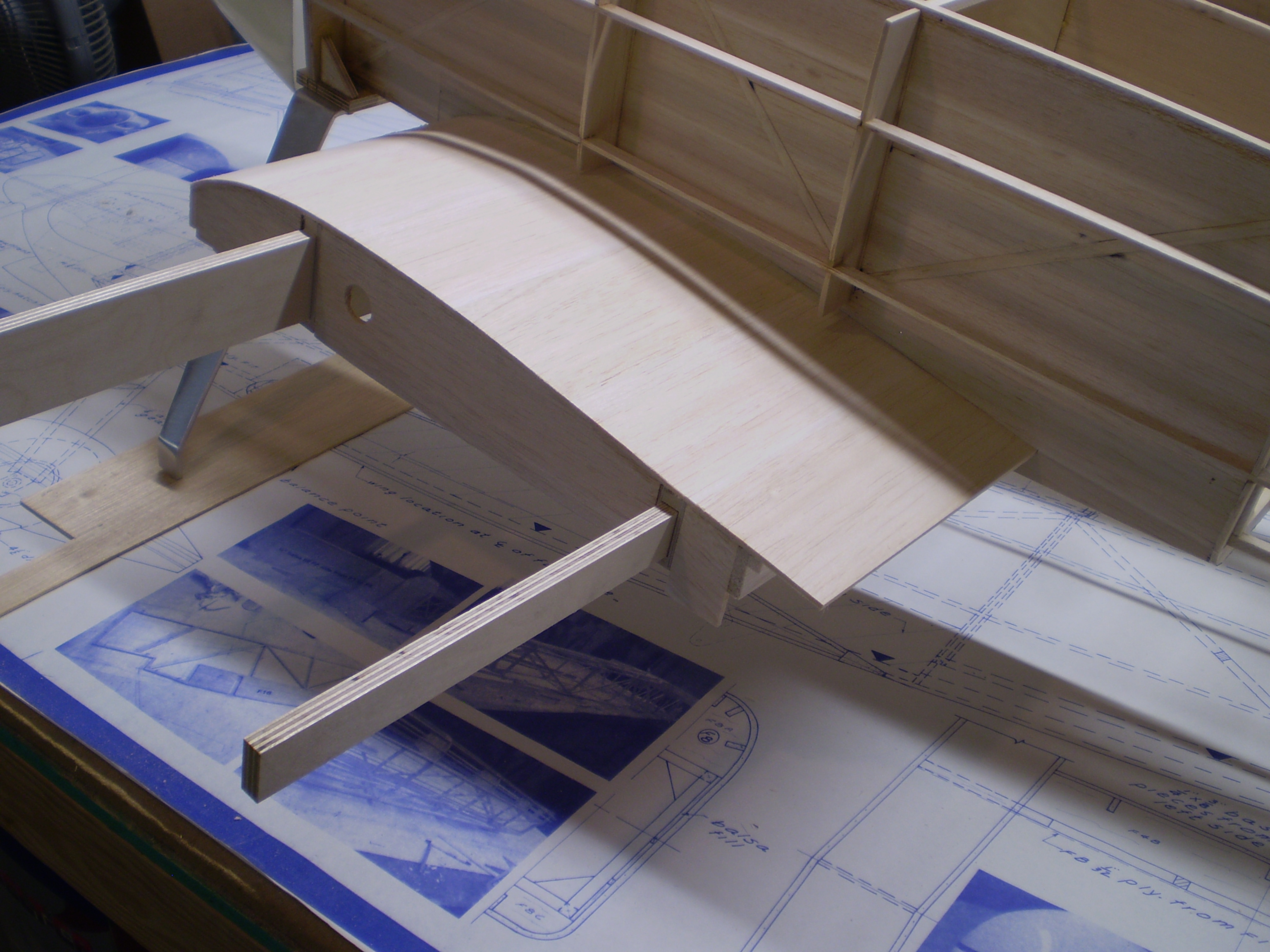

I have been working on filling the center section and fitting the main wings. I was able to complete the tail section and start sheeting the fuselage. I received my canopy and wheel pants this week and plan on building the canopy area in the next little while.

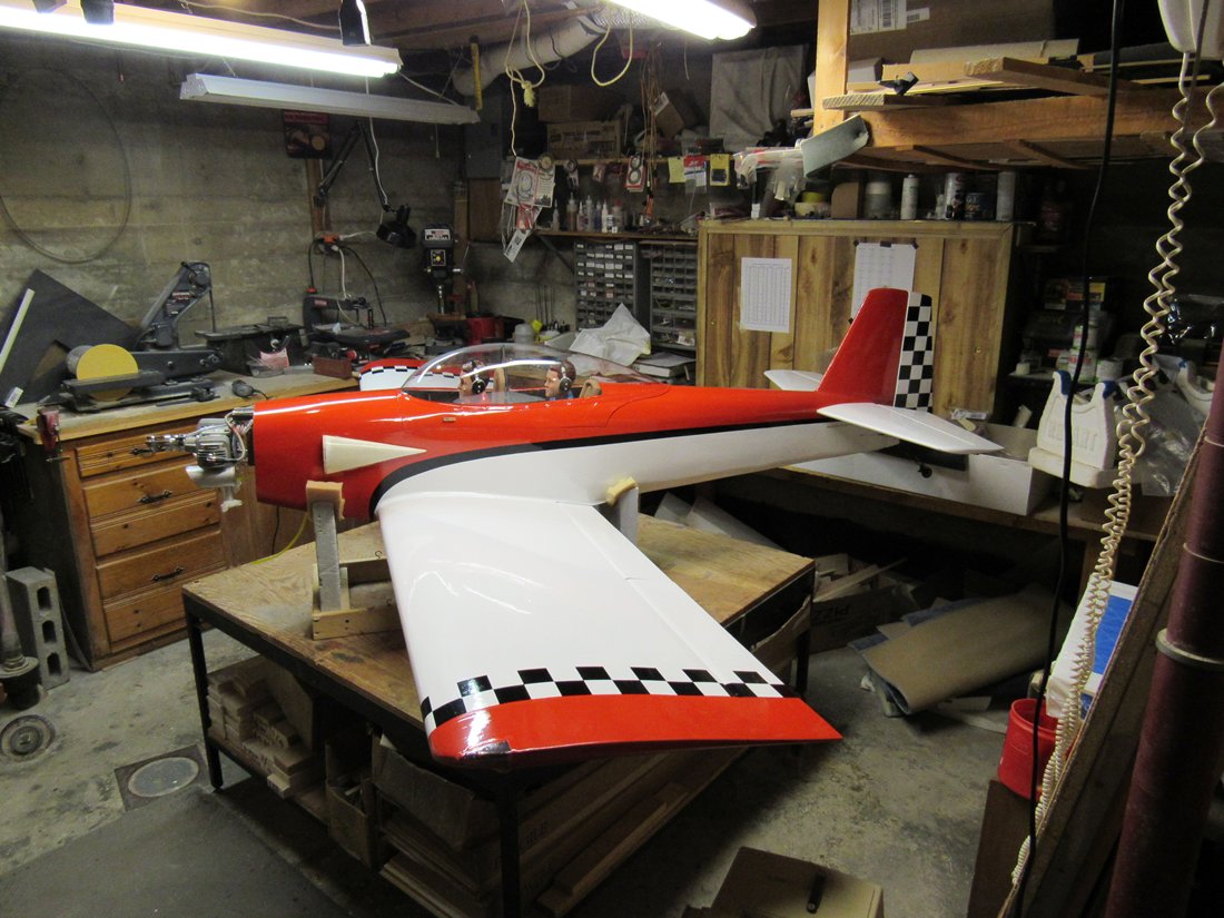

Hi All,
Well I have got to this point and I really need to get outside to paint all the parts needed for final assembly. Of course this Northern Maine weather is not cooperating as it's 7 degrees right now. Believe it or not but it may hit close to 50 tomorrow and then turn cold again. Oh well, time to start figuring on my next bird. Here's a couple, three pictures.
Frank

Looks great, Frank !
Don't worry. The weather has to warm up.........................eventually.
