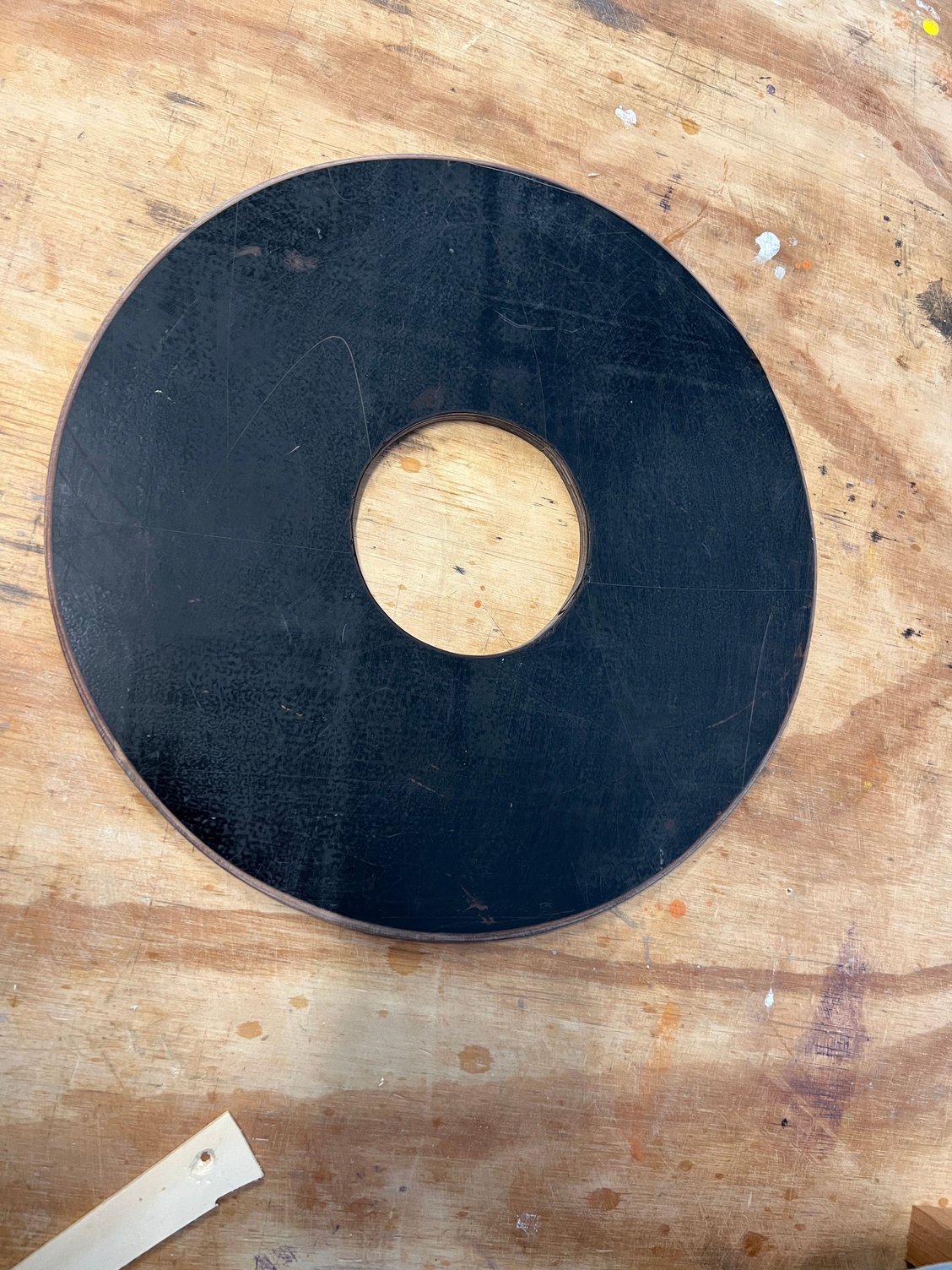

Fun times in the shop! You know you're getting close to finished when it comes time to mount the engine. I had envisioned a 1/2 inch thick piece of plywood as a mount but after I looked at the plans there was only a 1/4 of thickness available for a mount. Apparently the Moki 300 is longer than the 250. So I started looking around the shop for a suitable candidate. 1/4 inch aluminum plate would work fine but I didn't have a big enough piece. Then I ran into a piece of stock I've had kicking around for as long as I can remember. I have no idea where it came from.
This piece of material started life as a piece of high quality 7-ply plywood. But then the manufacturer took it and turned into what is best describe as a thick piece of phenolic. It was vacuum infused with a resin that looks, acts and SMELLS exactly like phenolic when you cut it (if you've ever cut phenolic you know what I'm talking about). Anyway, it's a fantastic candidate to be my thin, strong/stiff motor mount.
The only tricky part of the whole install was clearance for the 2-into-1 exhaust. The scant thickness of that mount didn't allow ANY clearance so I had to mill away most of the lower plywood ring of the fuselage front former. Structurally it's not a problem but it was quite a project. I stopped milling/sanding when I had about 3/8ths of clearance - not as much as I'd like but enough I think.
This material started out as 7-ply as you can see
Here's the motor mount. It's not the lightest choice but close to perfect, I think.
32X18 prop
Cover/paint is looming. As I said before, I'll be using Stewart systems to cover but final paint will be Klass Kote epoxy (it's more user-friendly than Stewart's final finish paint system)

Is there any offset called for in the plans?

JW calls for no down or side thrust and I prefer not to have any. Instead, if needed, I will add a throttle to elevator mix instead of down thrust and I prefer to fly the rudder by hand.
Bottom front milled away for exhaust system. I re-glassed it after milling

That sounds good, a lot easier to mount the motor as well!

32X18 prop (wrong!)
I need to make a correction here: the propeller I will be running on this Moki 300 is a 34x18 NOT a 32x18.
