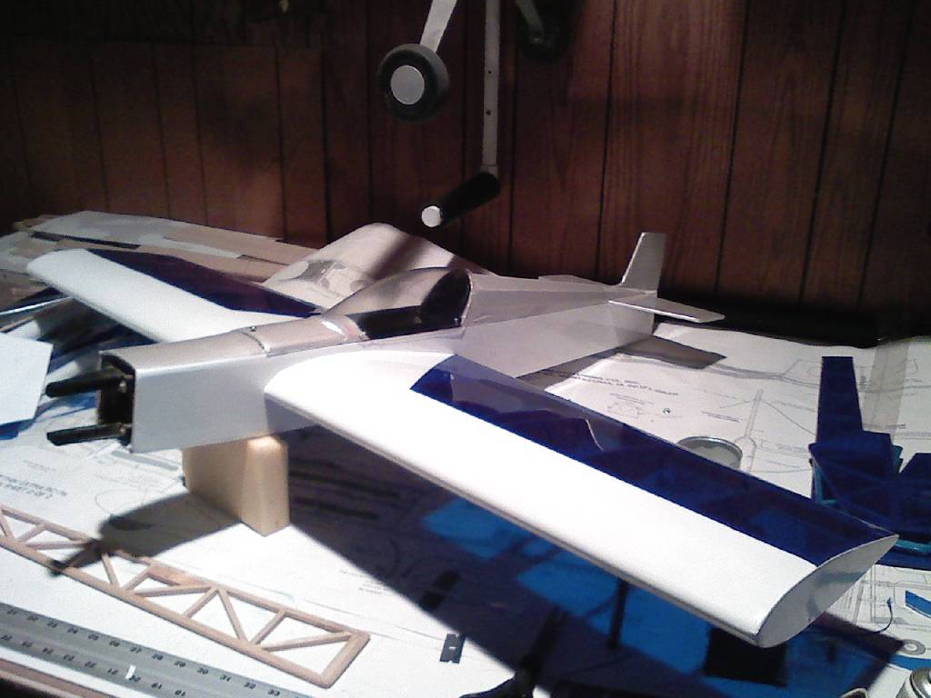

New project finding an alluminum rod that will fit that dam little hole on the elevator of the Dave Patricks Edge 540 120. Funny thing is i found a screw driver that fits the hole perfect, but its not long enough or id cut it and use it. But it was good for taking a measurement with the micrometer.
SO Im wondering if anyone knows were i can find some alluminum rods on the internet. I looked at tower hobbies and there eighter to big or to small. I can see this is going to be a project just looking for an aluminum rod.
Need an aluminum rod that is .1575" in diameter that is the size of the screwdriver shaft that fits the hole tight witch would be perfect if i could find a rod that size but i dought that is going to happen.. closest to this size would be 5/32" = .15625" figure if i can find an aluminum rod that is 5/32" and about 12 inches long i will be in bussiness.
So if anyone knows of a place that sells this size of alluminum rod Send me the link figured its worth a shot here why not.
Its a shame that the manufacture of this model doesnt exist anymore. So strange but understandable i guess some companies just dont make it. Hope to get this one flying and have some fun with it. But i can see if it ever crashes that will be it.
Oh and yes the plane looks like it is together but its not used packing tape and just made it look good for the pictures still needs a ton of Hardware nuts and bolts ect. gonna be awhile before this one lifts off into the sky again. so i figured i would start with finding the hard stuff first.

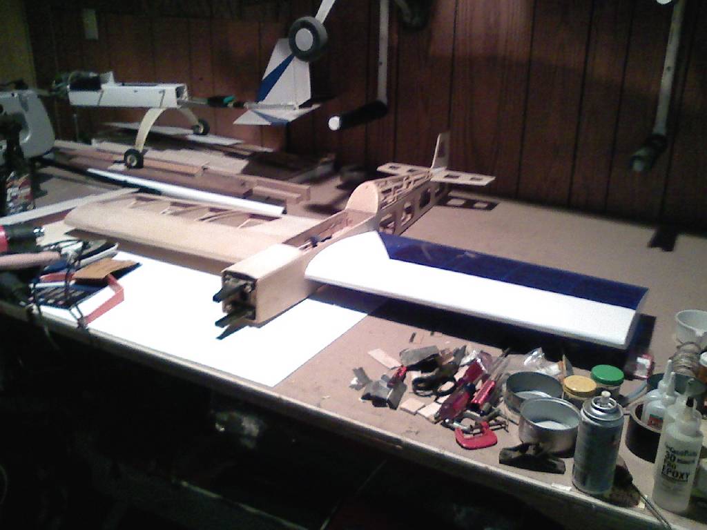

<span style="font-family: Comic Sans MS">Steve thanks for the link looks like a good site going to need some hardware special screws and stuff great appriciate it.
Been trying to find a manual or some sort of instructions on the net for this aircraft. but i think im out of luck on that one. This plane was given to me and the firewall has to be replaced had some sort of gas engine on it i plan on putting anOS 160 on it or somethingn of that caliber. Have a SPE 26cc gas engine but i dont think it would be enough power for this plane. Im sure a 50cc would be a great engine for it, but im trying not to dump to much into it. Still have to get some good servos for it and thats gonna be expensive.
Mainly just looking at hardware first then electronics and power second. Striker Appriciate that there is some input on this model. i kinda figured it would be like the Leage extra 330L i have, not popular apperently. But since it was a gift I have to realize there is a reason why it was given to me. lol
The friend i fly with told me to keep it light. So im going to try to. Heapperently he had it flying once upon a time. But then gutted it to use the parts in some other model and so it sat in his shed and eventually everything that pertained to the model got misplaced.Think the biggest obstical will be rebuilding the firewall has a big hole in it, since the engine that was on it had the carb that comes out the rear of the enigne im thinking..
So i'll post some pictures of that on here as i get to that part of therestoration of the plane..Keep up update on my progress.

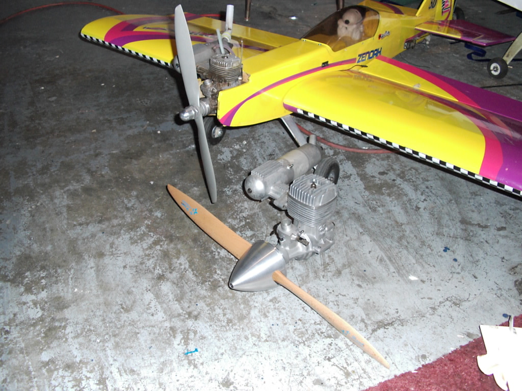

This is a 28% Edge, not too sure a 160 will cut it. I would say a 50cc gas engine for sure, high torque servos for sure and digital. Depends on how you fly and what you want to do. The firewall is nothing to rebuild, honestly. Seek assistance from club members who are good ol builders.
I would save up some cash and do it right. If you loose the airplane hopefully you can save the rest of gear for another airplane
I have the manual but don't have a scanner, tossed it out a while ago.

<span style="font-family: Comic Sans MS">I was thinking the same thing Not to sure a 160 would be enough power the plane looks bigger then my 28% Leage extra 330L and its got a 45cc engine on it. Im thinking it needs a 50cc at minumum. But im going to ask the previous owner what was on the plane before he seems reluctant to give me to much infofor some reason, but i'll find out..</span>
My Feedback: (84)
Nice looking Edge, I have a DA 50 in mine but it was flown with a Saito 150 and was great. Someone I know has a YS 140 it is even better. The OS 160 is just fine and has plenty of power to do IMAC style flying, MOKI (MARK 180 or 210) is great also. (What Dave designed it to do). Will come out about 12.5 to 13.5 lbs with the above engines. Mine with a DA 50 is at 16.5 lbs. Look close to the wing area compared to the NEWER 3D planes out today. The DP EDGE has a lot less, and has a wider fuselage that also takes away usable wing area. I have a manual I could copy if you need it. The manual outlines the engine choices and Dave discusses the reasons. The minimum gas engine would be a MLD 28 or any of the new 30 cc engines. I have seen this plane 3D with a MOKI. It is not a great 3D plane at 16.5 lbs, but it is great for everything else.
IMO the DP EDGE has to small of rudder not enough wing area (high wing loading) for a 50 cc engine. I have unlimited vertical and great power to toss it around but it is snappy when you manhandle the controls on the deck. If you are new to 3D then go with the Dave P subjected motors and fly IMAC. Very strong airframe and I fly mine with the DA wide open like I am flying in a Red Bull Race. Look like you have a great color scheme for racing.
As for the fire wall, most engines are going to need spacing out so just laminate a ¼ hard ply sheet over what is there.
The only reason I went away from glow, was the mess on the tail.

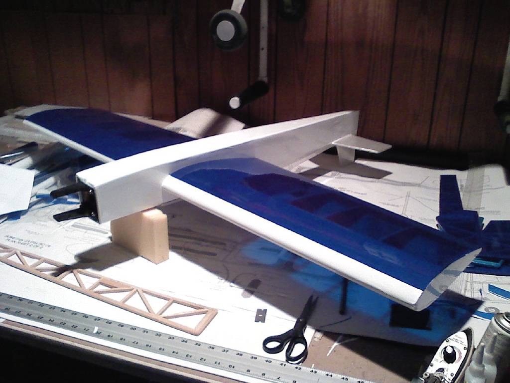

Thanks 3DSky for your input on the plane. Im glad there is a large variety of engines For this plane So since i have an OS 160 i'll give that one a shot. Dont plan to do to much 3d i have other planes for that. Nope just want to fly it.. The OS 160 will hover my giant big stick for a moment and it is a lot larger plane.
And this plane is alot lighter then the Giant big Stick..
1/4 inch lamined hard ply sheet sounds like a lot easier fix for the firewall then having to rebuild the 1/2 inch firewall that is there So i will give that a try..
